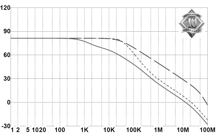

To expand a little on the earlier discussion, I just got the attached for an upcoming article for Linear Audio Vol 3.
The long-dashed line to the right is the open loop response of a regulator. You can see that it crosses the 0dB line rather steep, at a 24dB/oct rate. Such a steep angle carries with it a large phase shift, so you get in a situation with 180 degrees phase shift and still some gain > oscillations!
The solid line to the left is with a cap at the output. No more oscillations and instability because that curve crosses the 0dB line less steep, and carries less phaseshift. BUT, the gain rolls off much earlier so that means that for higher frequencies there is much less loop gain which means the regulator doesn't perform as well as it could.
Therefore the author used the small dashed line: no oscillations because the 0dB crossing is not too steep, but still using almost all the available loop gain.
Such are the deliberations of a designer... 😉
