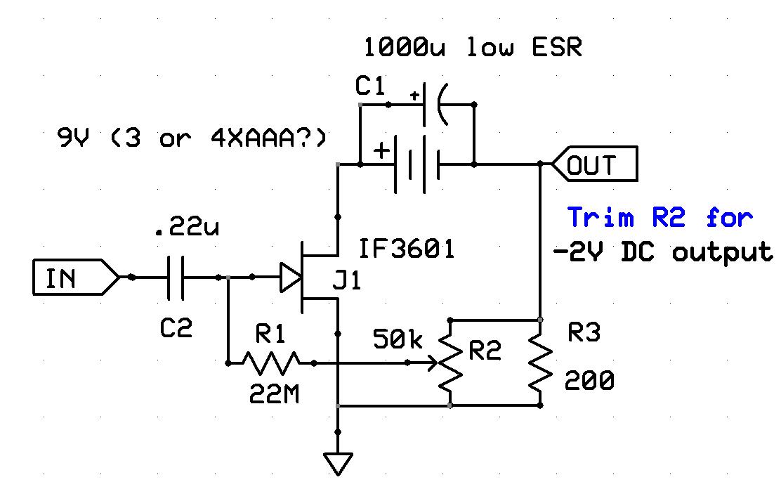

Offered in the spirit of minimalist fun this is about the simplest 20dB front end I could think of. I measured good noise performance (.35nV) with both alkaline and NIMH batteries, though I am told the now outlawed mercury batteries were best in this application. R3 could be split (depending on FET) and the pot could be eliminated. 6 - 2SK170's in parallel should also do the same thing.

Scott,
With C2 at 0.22uF I'd rather doubt you even get ten times that value in the low audio band.
Ciao T

Above circuit is example, works fine with 6X unsorted 2SK170's. (BL's)

Explain, again above built tested (simulated if that matters), what about a .22uF/22Meg Ohm time constant is unclear? With 10K source as calibration the 12nV noise has no visible low frequency roll-off and the high end rolls off at 6kHz perfectly consistent with ~2.5nF Miller Cgd (this is for 5-40 Ohm MC's). Do I need to post a picture? I could repeat it at work with an instument that goes to DC.
BTW this circuit is 40yr old, it's a FET version of the self biasing bipolar CE stage.
EDIT - Sorry you're talking about noise, The corner was actually around 100Hz that's not an issue I have a bag of 22M from a guitar shop, so put 5 in series. Rememer A weigting is your friend and it's mine too.
Scott,
Nothing is unclear. However, please check your circuit. Most of the audioband will have way more noise than 0.35nV|/Hz, due to your chosen C2 value.
For a very quick estimate I get around 725 Ohm Xc in parallel with 22M as input noise source for a shorted input, this gives me with an equally quick estimate 3.5nV|/ Hz at 1KHz and 11nV|/Hz at 100Hz from this RC circuit.
I understand that you must have adjustable bias to compensate using unselected parts and avoiding source resistors (in production that would be a nightmare, but it is ok for DIY), however your way of implementing this degrades audio noise performance so badly, ballasting / applying a source resistor would be the lesser evil, unless the circuit is intended for RF use only.
Ciao T

Professor your maths are sorely lacking. You need to review your parallel to series conversion.
At 20Hz 22me || .22uF = -22e6*36172i/(22e6 - 36172i) or 59.47 - 3.6172e4i. The noise only comes from the real part or about 1nV at 20Hz. I did it in Matlab I did it in SPICE same answer. Also the RC noise goes at 20dB/dec not 10 as you say above.
No need for a larger time constant at the input. Oh, did I mention I built it and put it on a spectrum analyser.
Thorsten is right, bigger input cap, better performance for just about any task.
I see you're still under moderation. The point of diminishing returns is well past here, even .1uF would work fine. This is DIY, with smaller caps folks can still use their exotic materials and spend less money if they want.
