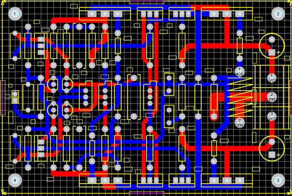

Recently I re-draw the pcb to reduce the size to 115 x76mm, here is the revised layout:

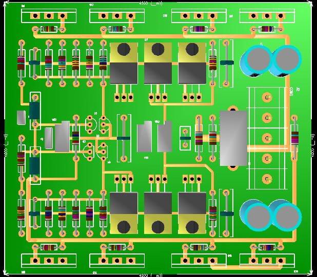

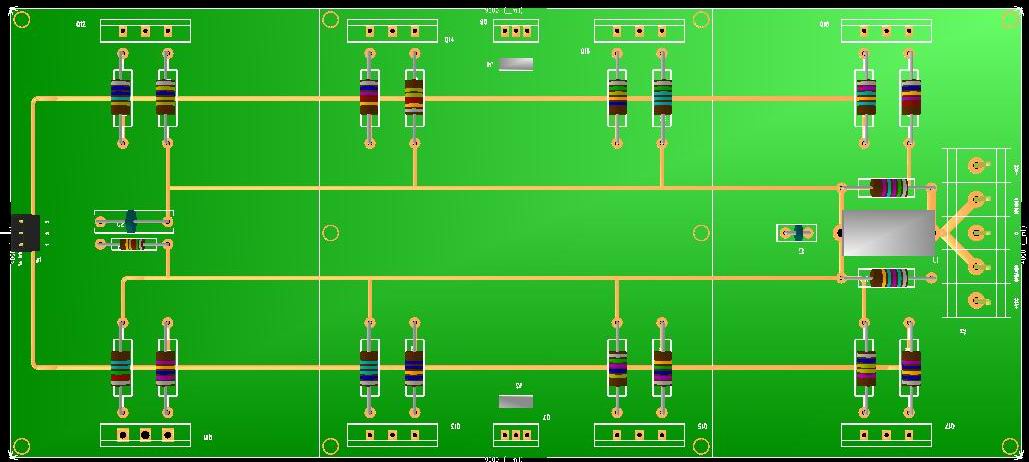

Base on the schematic Sigurd Ruschkow posted on #347 of this thread. I re-drawn the pcb layout and added two more pairs of output transistors to make it total 4 pairs.
Comments are welcome.
Hi HCK, by the way, his name is Sigurd Ruskowski. Can your tracks handle the current, or do you have wide tracks below the board. Also the hole sizes on the power transistors differ and I think the pads are too small, there is quite a lot of mechanical stress bolting the transistors down.
Hi Ras
Thank you for your comment, I will widen the tracks and use bigger size pads and will send revised pcb layout soon.
PS. Thanks for correcting me about Ruskowski.
