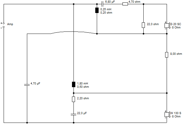

I know this is DIY, but... considering the educational value... is here any possibility for us to vote a minimal set of proper technical conditions for this thread to stay open? Proposals?
My questions, or first proposals:
1. Title tells that main purpose for this X-over is to work well for both CS and VS, in a "compatible" manner. Right or misunderstanding? If right, then is there any other merit to justify technical discussions beyond this point? If Yes, then proper technical statements and Proofs are expected without delay.Maybe restart in a better (="proper") and complete (="full") manner?
2. Just to enable all of us (owners or not of Usher S520) to verify the quality and potential of various statements before engaging any DIY effort, then the TS+Z*(f) characteristic of drivers are expected without delay. These should have been stated in Page1, in my opinion.
Joe, I am convinced all this middle-way is very reasonable and doable to you, of course.We are all waiting...but not for Godot. If you cannot deliver now, for various reasons, it is OK. You can close this thread for now, and reopen the topic when you are ready.

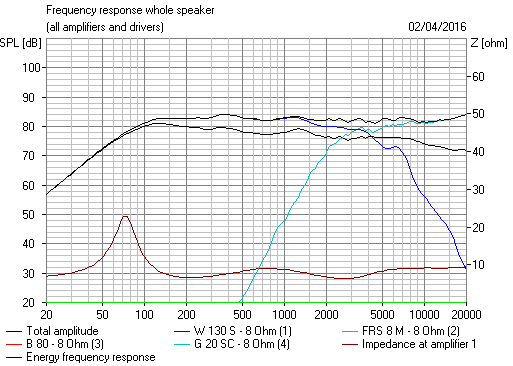

These speakers, in their characteristics, claim to have constant impedance:
EVA | Davis Acoustics
•Un filtre avec compensation d’impédance, atténuateur à impédance constante,…
I have consulted to Davis Acoustics but I have not received a reply.
Does anyone have information about these speakers, the impedance graphic? Thanks

Nothing of their website, but the specs of one of their speakers says 4-8 Ohm, so that is hardly constant. Let us know what they say, maybe some of the speakers do? I am kinda hoping they are...?

I think flattish impedance is a pretty damn good idea. It works better with imperfect amplifiers, and every speaker I build seems to sound better for it. 😎
Whether you get it PERFECT is your call, but better is better IMO. But there are some quite interesting techniques for flat impedance. How nice does this one look? 5" plus 1" tweeter. Not you regular flat baffle crossover. But worth a go IMO. These sort of ideas add interest to my hobby.

That was the topic, that or just getting your hands on a pair of Usher S520, the crossover is reversible if you don't like the result, they are cheap, lot's available - at least I have made the opportunity available.
I would love to have an open discussion about, it would at least be 'fun' to see where it leads.
