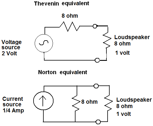

Flippin 'eck, voltage and current equivalents aren't hard.
A picture worth a thousand words. 😀

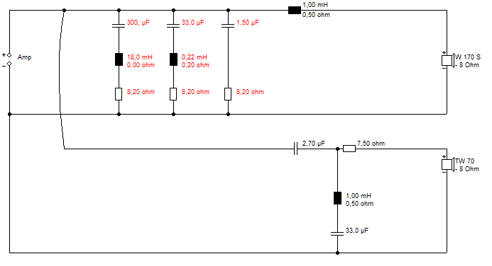

I was struck by Joe Rasmussen's "House Style". Here the Usher and the Elsinore (without impedance correction). 😎
I've drawn up his Usher remodel with values. That 18mH has me scratching my head, but I'll trust Joe on this.

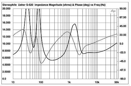

300uF and 18mH acts at 70 Hz on the upper peak of the double peak reflex bass resonance. That just seemed a bit low for a tiny 5" polycone. Which is what was bothering me.System7,
I would assume that 18mH shunt is set for the Fs of the drivers low frequency peak.
The similar 5" Epos ELS-3 had an upper peak near 100Hz:
Epos ELS-3 loudspeaker Measurements | Stereophile.com
Actually the Usher S520 has a peak near 85Hz, so Joe's circuit looks reasonable. Notches often don't have to hit the exact spot to be most effective. It's always best to model them.

3 Notches often don't have to hit the exact spot to be most effective. It's always best to model them.
Indeed. Individual driver parameters can vary as much as 10% between units so it's probably wise not trying to hit a nominal value spot on but having it a bit broader to catch them all.
