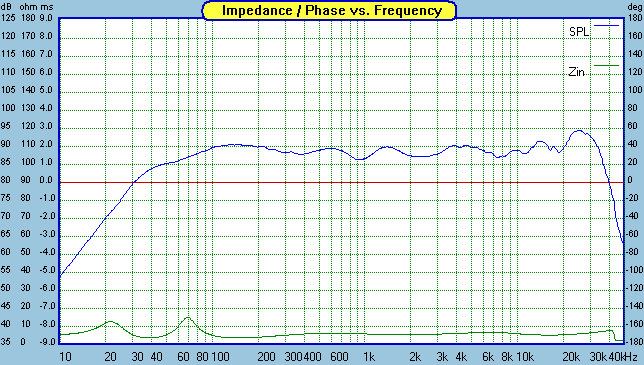

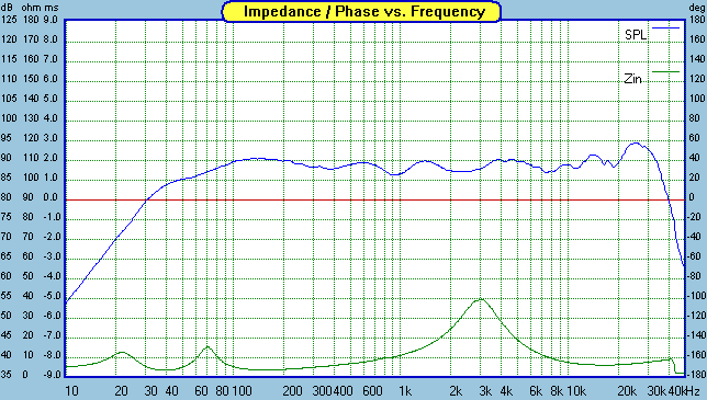

Just for a little balance, let us revisit the series notch which is the normal way to remove peaks in impedance. graphs (c) Zaph. handy if your output Z is high. In all the textbooks. Nothing new here.

You know, much has been written about current drive; about reduction in distortion etc. Unfortunately most of it only applies to a driver connected directly to an current source amplifier. As soon as any parallel component or network is placed across the driver's terminals it no longer sees constant current drive.
The basic premise of current drive is that it eliminates the influence variations in impedance due to VC heating, the back emf, etc on the current, thus the driving force. The driver's impedance can be expressed as
Z = Re / (1 – BL * v / V)
where v = cone velocity and V is the voltage across the VC. In a perfect world Re, BL(x), and the ratio of v/V would be constant. But in the real world they are not thus Z will vary due to any number of reasons. With a driver connected directly to a current source none of this will effect the driving force, BL * I , since I will remain constant. But as soon as there is something in parallel with the Z, like a conjugate network, Z*, the component of current through the driver will vary as Z varies because Z in parallel with Z* forms a current divider and I through the driver will be
I = 1/( 1 + Z/Z*)
Now all the factors that influence Z are back in the equation and will influence the current actually flowing in the VC. Additionally, since the parallel impedance,
Z|| = Z x Z* /(Z + Z*)
will change due to the variation of Z, the voltage across the driver will also change when connected to a current source,
V = Is / Z|| where Is is the (constant) current from the source.
So, is this better or worse that a voltage source, or just different?
Adding a conjugate across a driver, or a conventional speaker, to flatten the impedance will make it suitable for use with a current source amplifier, but this is still a far cry the supposed benefits obtained by connecting a driver directly to a current source amplifier. And recognize that since Z varies, the conjugate network will not provide the necessary correction to flatten the system impedance under real world conditions.
Indeed. An other way to look at it is that the 'black box' seen from the driver, containing a current source and some // network is no longer a current source.

First of all, a driver, any driver, will work fine with a current source. It will just have a different response because the driving force will vary differently with frequency. The only issue is really one of VC heating and burn out but I don't want to get into that, other to point out some very simple issues. I think most know that heating in the VC is due to heat generation which is I^2 x Re, or, equivalently, V^2 / Re. Just looking at this it should be apparent that as the VC heats up and Re increases, the heat generation for a current source increases where as for a voltage source it decreases. So, in a sense, with a voltage source the heat generation is self limiting but for a current source heating grows exponentially. Details in heat rejection to the surroundings will ultimately decide if the VC burns out in either case, but the difference is apparent.
Back to the difference in current and voltage drive and the driver response. Again, consider the driver's Zd. When connected to a voltage source the current through the VC goes like 1/Zd and around the resonance peak the current, thus driving force, drops and we seen the typical response. When connected to a current source, the current doesn't drop around resonance. Instead, the voltage across the driver's terminals goes like Zd, with a peak at resonance. In effect, connecting an ordinary driver to a current source yields a response that looks like what you would have if you placed a parametric EQ stage with a Q Peak filter before the input of the voltage source amplifier.
Now put a perfect conjugate network across the driver. The parallel impedance of the driver with conjugate, Z||, will be constant and purely resistive. For a voltage source this makes no difference, since the voltage across Z||, hence the driver, will not change. The current through the VC will still be V/Zd, but the amplifier will also have to deliver more current since there will be current though the conjugate will be V/Zc. So, other than the additional current load on the amplifier, nothing really changes. On the other hand, what happen with a current source is that the amplifier now sees a constant load, Z||. Since I is constant and Z|| is constant, the voltage across Z|| is V =I x Z|| and is also constant instead of having a peak around resonance, and the current through the VC is now V/Zd. There are always detail to consider, but in the ideal case when you place a conjugate network across a driver or a complete speaker, as far as the driver/speaker is concerned, it might as well be connected to a voltage source.
Anyway, that's my very simplistic view.
