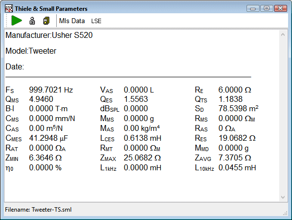

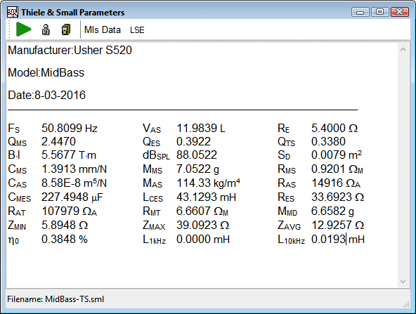

Esa Merilainen is totally fixated on current drive. I have his book (maybe you could review it). He has some decent points to make and I do recommend a read of his book (even if it is written in Finglish) and that it is more crusading for my taste (but we still get on and I have no problems with him). But we are not going to convert the world to current drive, and there are many reasons for that. It's just not going to happen, period. But there is something to be said to tracking current as the method of motion in motors. There is something to be said about exploring techniques that are somewhere in the middle.
Now please, understand that sometimes you observe things and develop a gut feeling, one that may be true or just completely wrong. But having run so many 'what ifs' in SoundEasy (John is an expert on SoundEasy and I have spoken to Bohdan Raczynski and consider the earliest distributor Peter Stein a friend) that simulating a current source (high Z) always produced a zero degree phase angle. This gave me an idea worth exploring. This is only a tip of the iceberg, but earlier John said something I had already observed, that equalising the Z meant that Thevenin's predicted the response irrespective of the box alignment and so on. So, to cut a long story short, I took an existing design of mine, calculated (using SoundEasy) the values seen directly (not part of the crossover) by the amplifier directly and then used (within reason) only series inductors and series capacitors (tweeter) in the way that Esa preferred. SoundEasy showed that it should hang together nicely. I built the crossover and found that everything behaved as predicted. Then took a listen and was both surprised and very pleased with the result. There was a degree of obvious clarity not there before. It was also easier on the ear, less fatiguing - a guy I know with Ambience ribbon speakers (designed by Tony Moore) came over for three hours and said they sounded like ribbons. I considered that signficant praise.
Above is but an extremely brief recount of a much longer story. But is it so wrong to share this and see if other get similar results?
I have since done a number of designs this way - I like what it does. It makes a speaker that is able to be driven by any source Z (that alone cannot be bad).
For an 8 Ohm speaker, I aim for a flat 6 Ohm Z. With 4 Ohm it is somewhat more challenging, but aim as high and flat as I can. But sometimes you can't, then I simply won't do it. I have always aimed at easy-to-drive speakers and here we get something that looks as close as a resistor as possible..
