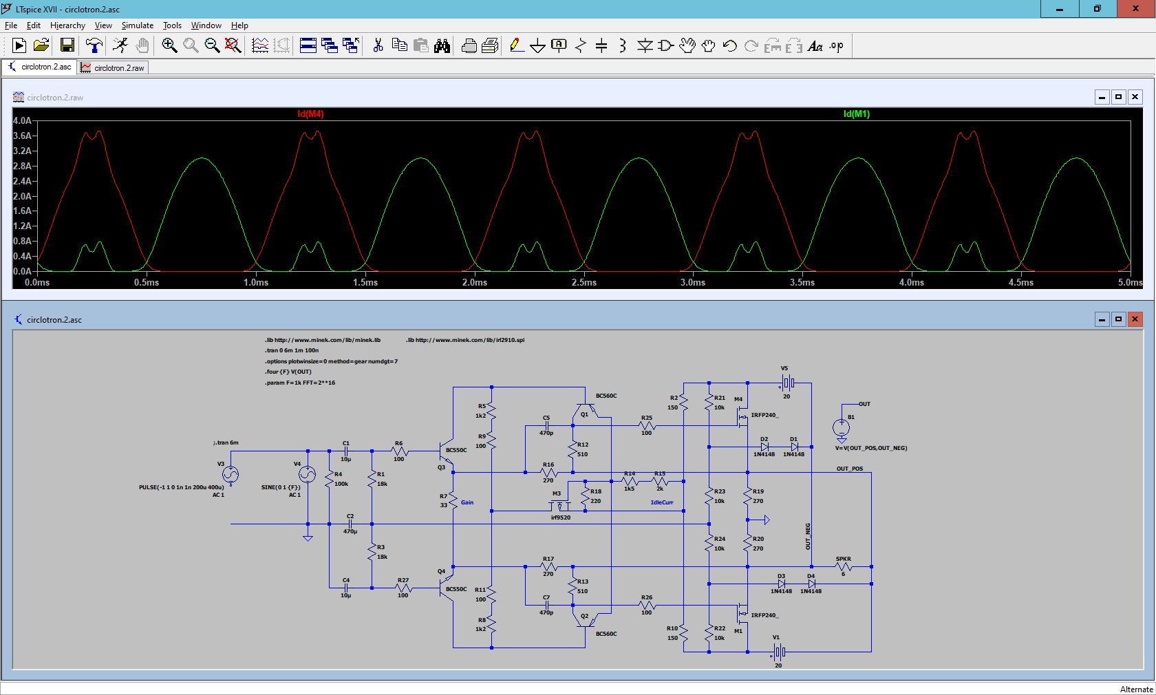

I tried to sim this amp. One version with IRFP240, and one with logical-level mosfets.
I was surprised to see asymmetrical current/power dissipation in output fets. Since this is circlotron, I was expecting perfect symmetry.
What gives? Any mistakes in my sim?

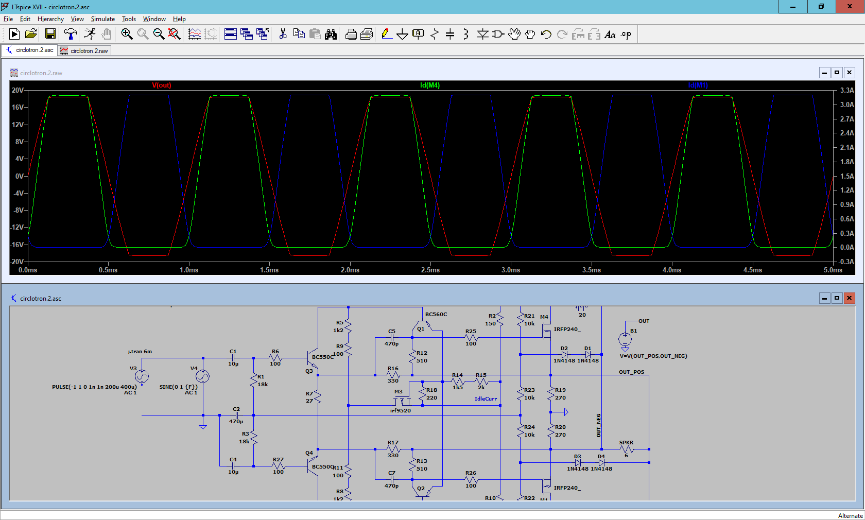

What Vgs your sim shows for IRFP240 ? In my prototype I measured 4.65V (IRFP044N) at Id=0.3A.
You changed the value of R7 from 27R to 33R too. That changes more than just the overall gain.
Also, your sim shows the Id of 3A and more which means clipping (20V PSU voltage with 6 Ohms load) and that kind of behavior is not easy to predict in the sim.

Idle current for output fets was set to 244mA.
According to sim, Vgs is 4.25V.
I sim all amps with input signal 1.2V, and with this signal it was defintiely clipping.
So I lowered signal to 1V, and lowered gain (R7) to avoid it.

Your sim looks OK in general, but to confirm, you can drive it balanced by adding 100K between the input side of C4 and ground and connecting your signal source across the inputs instead of between one input and ground. With this arrangement you should see perfectly symmetrical currents.
Meanwhile, I'll investigate your findings. I did check for this in the original version of the circuit and it did not occur there, but I didn't recheck all the later variations. It's possible something changed that is now limiting Q7's ability to suppress common-mode signals.

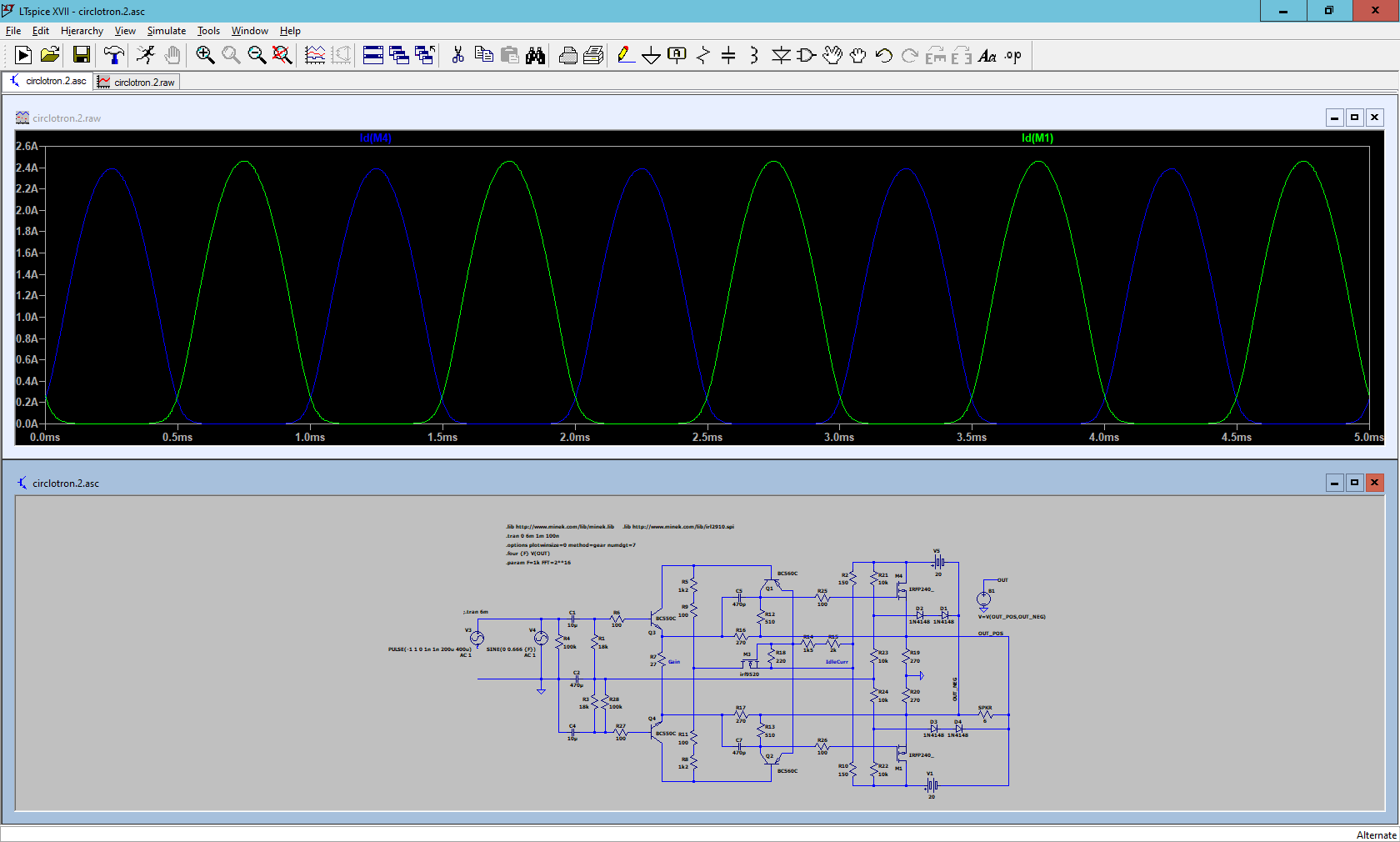

You see? When you know what are you doing, things begin to make sense...I tried the sim lower input signal, and the currents are nicely symmetrical.
So this ungodly Id currents were due to clipping.
Looks like keeping R7 at 27 Ohm, but increasing R16/R17 to 330 Ohm shows more civilized clipping behavior.
It's still clipping, but in symmetrical way.
