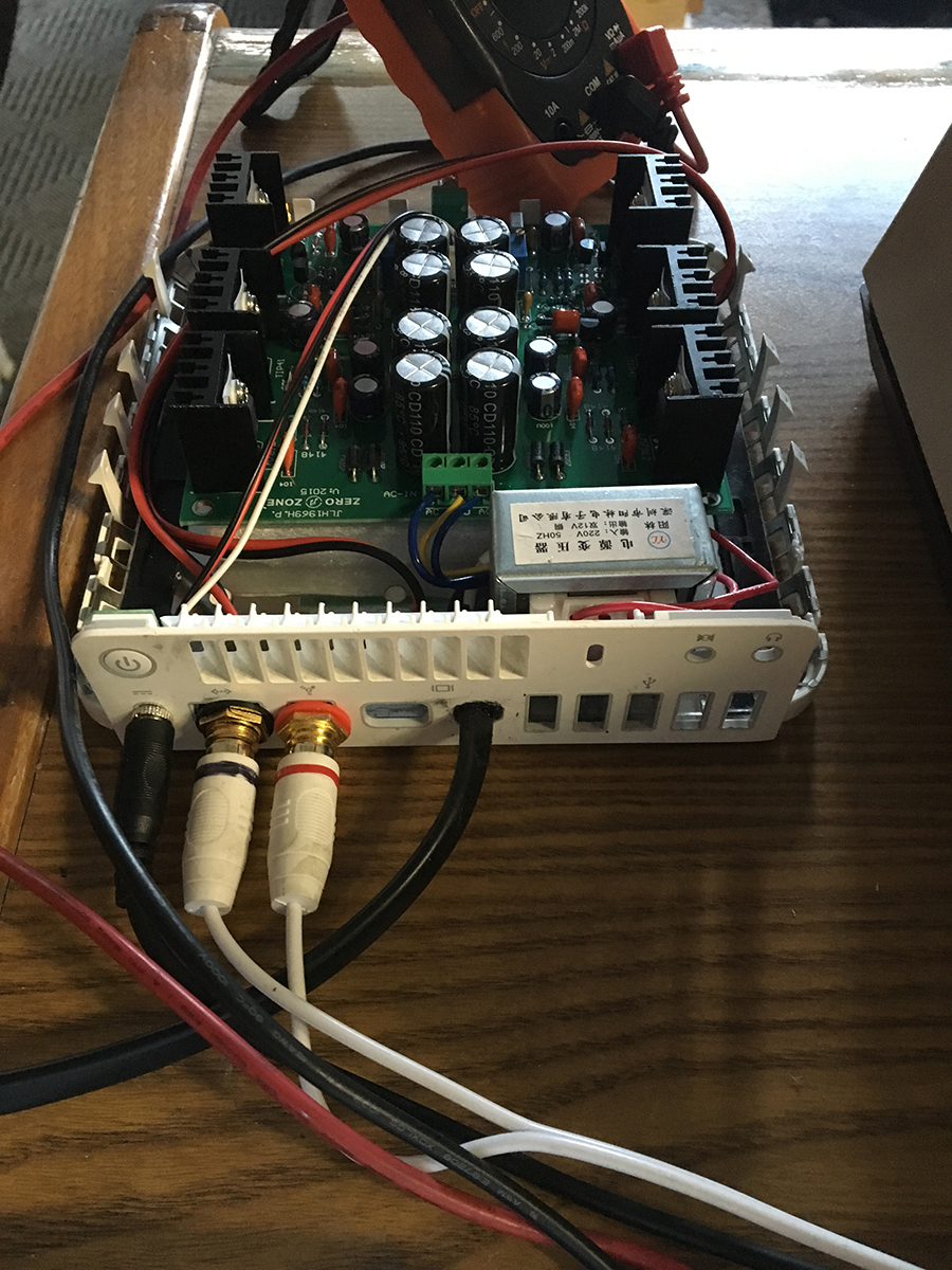

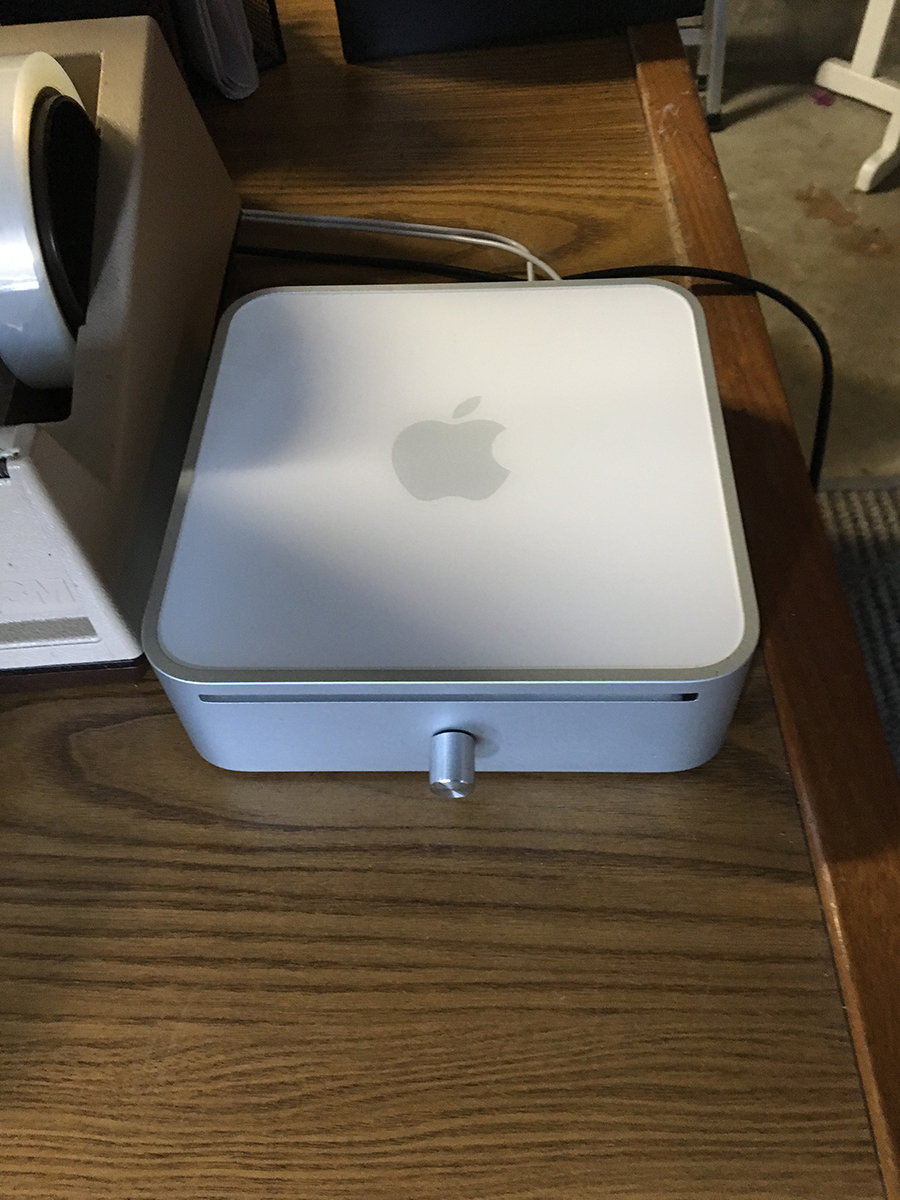

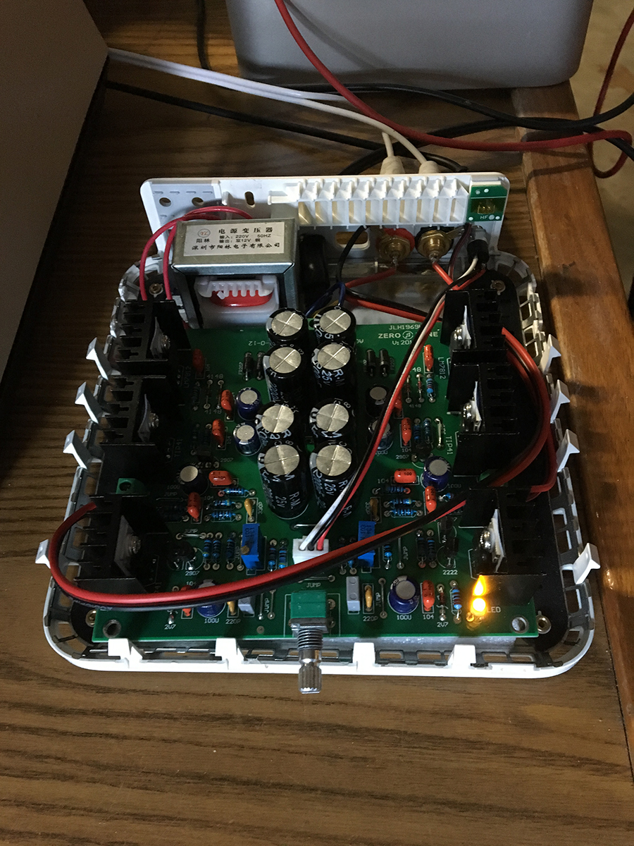

Well, after many tries I gave up on adding the transformer to the JLH1969 PCB and bought the assembled JLH1969 amp
Now using:
Internet Radio > Macbook Pro > TDA1387 x8 > JLH1969 Headphone Amp
Plan to replace the transformer with an Antek AS1212
Have purchased the Servo pcb
Has anyone replaced the JLH1969 potentiometer with an attenuator? Looking at the EIZZ or Dale.
Thank you !
