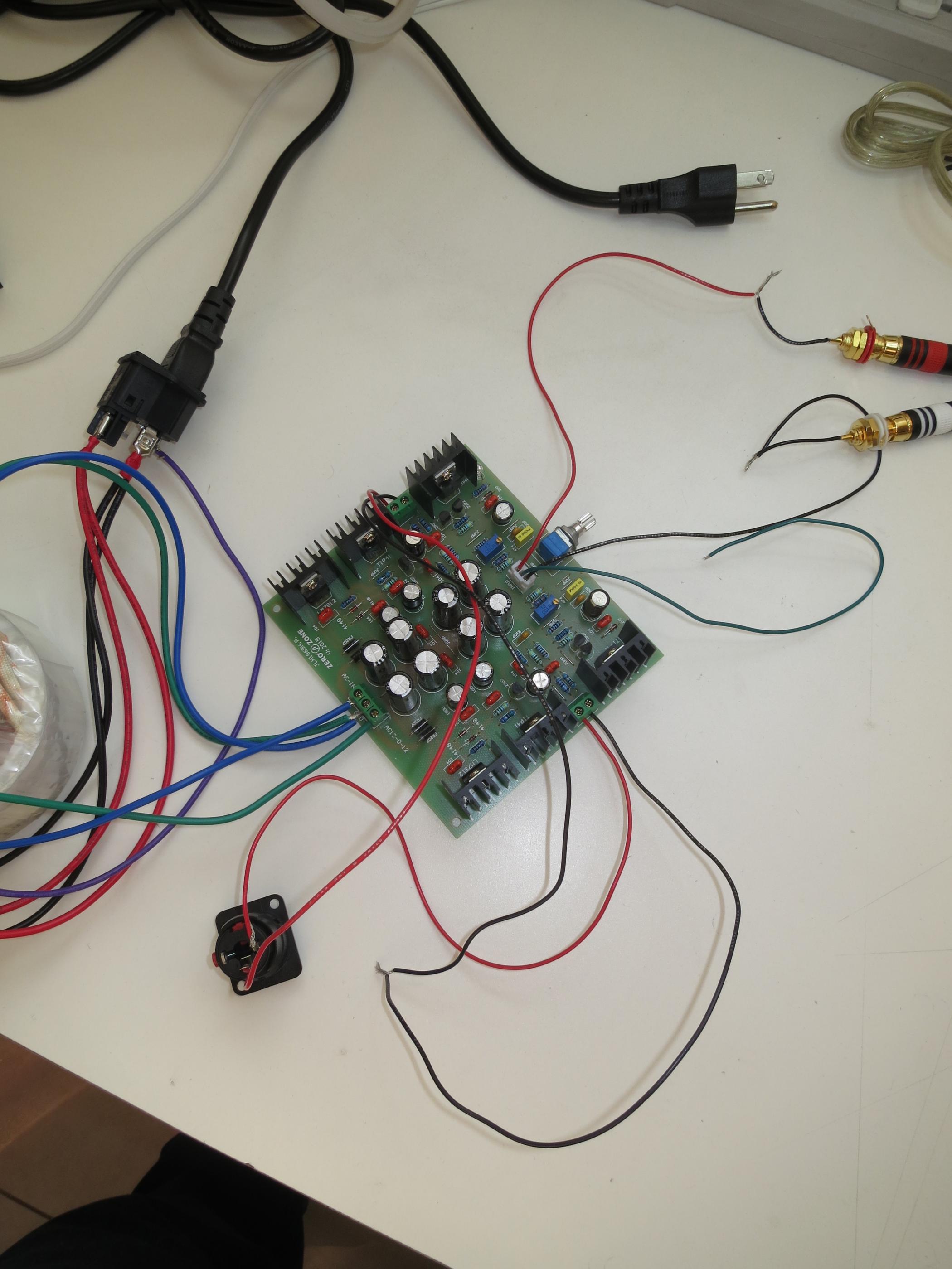

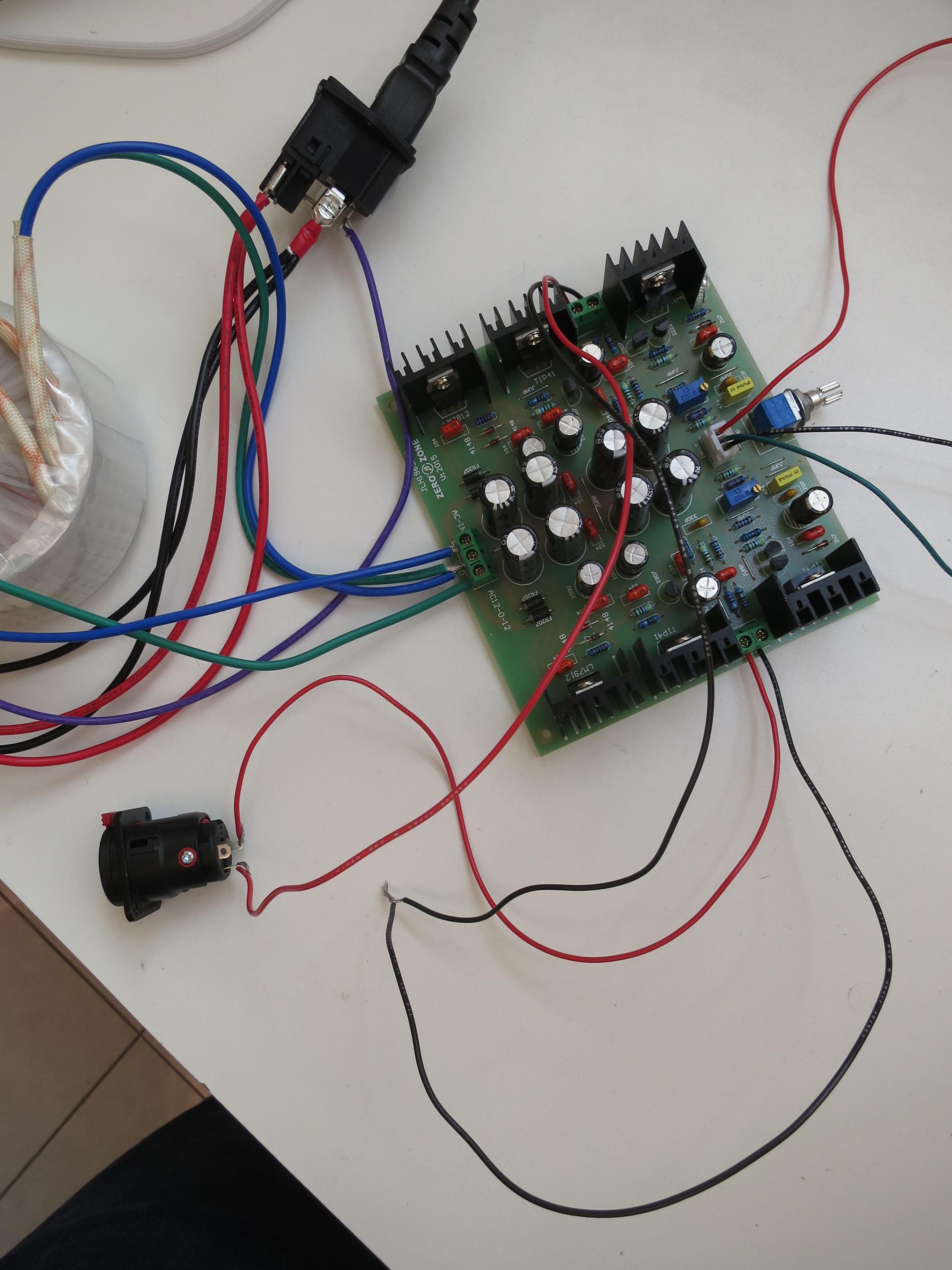

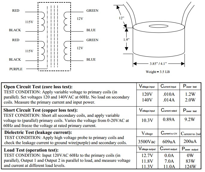

12 - 0 - 12 = Blue - Green + Purple - Blue ?
12-0-12=blue-green+blue-green

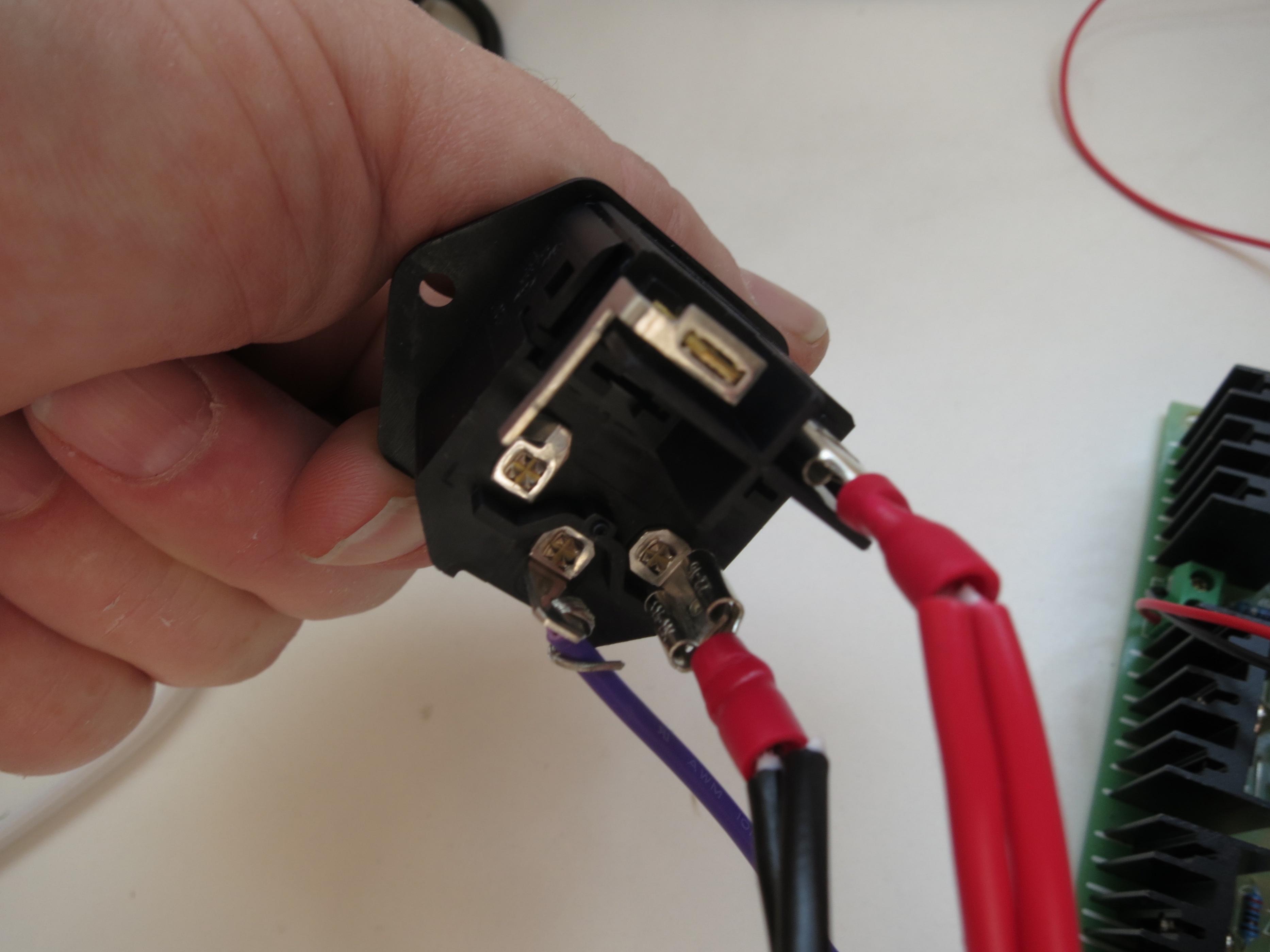

Connect purple to the earth on your main plug.
Thank you ! Thank you! Again I knew, would feel silly.
12v - 0 - 12v = blue + green - No Wire - blue + green (blue and green from same secondary). No wire for "0" ?
Purple is primary (mains) ground.
Secondary: green (12V) - green + blue (0V) - blue (12V). Unless otherwise specified by the transformer's manufactured.

No.Purple wire is primary ground.
The purple wire is connected to the interwinding screen.

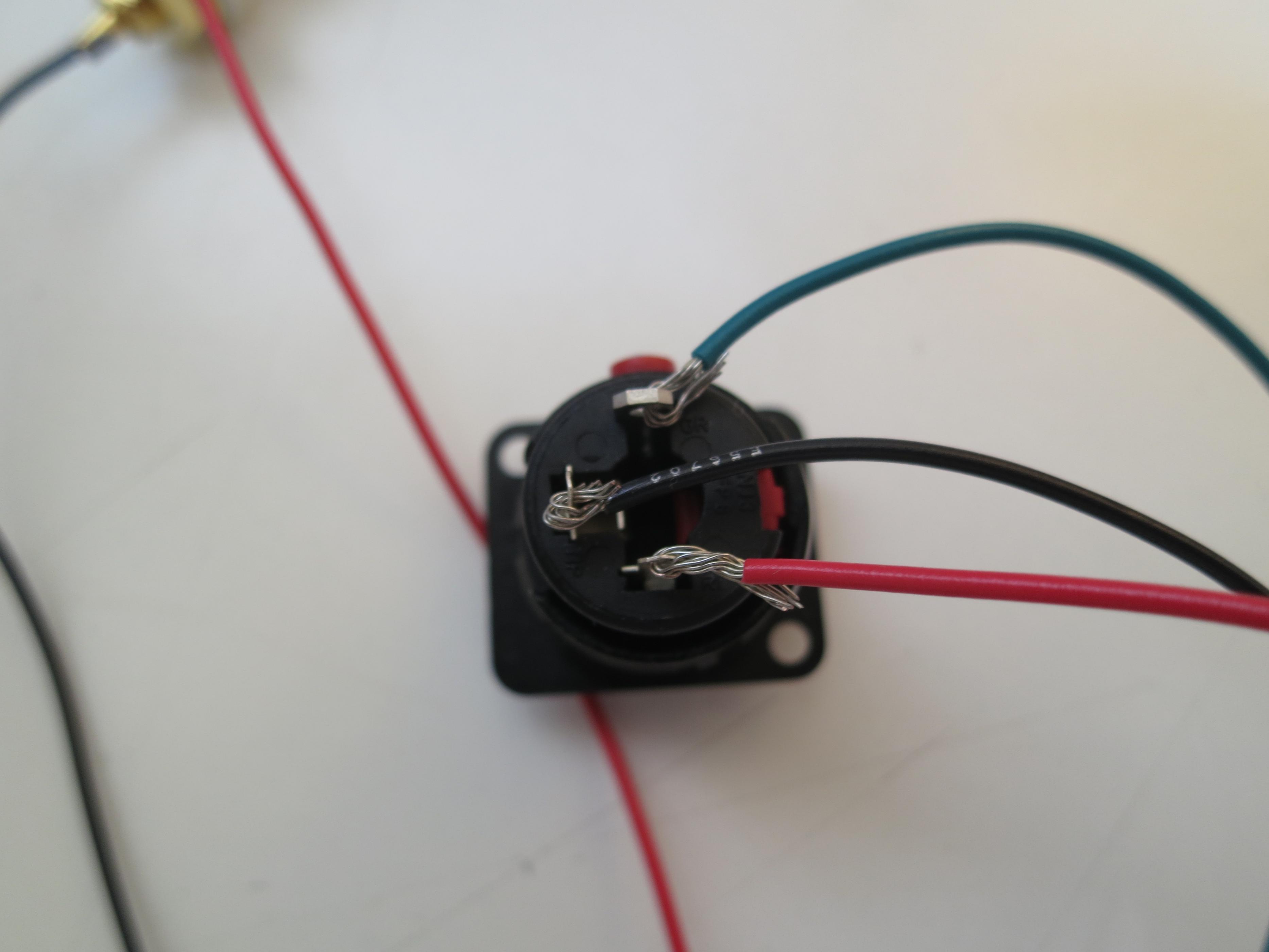

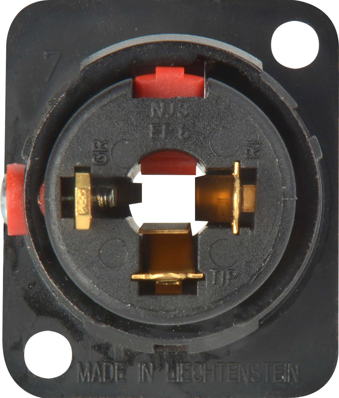

Tip = Left, RI = right, GR = ground. Right and left ground are inherently connected at this point, this has to be taken into account when planning a grounding scheme.How do I wire the headphone jack ?
There is Right + / - and Left + / -, the jack has Tip, GR and GI. Thank you !
It Works !
Thank You ! Thank you !
It works. Now working to get rid of grounding hum and have stereo separation.

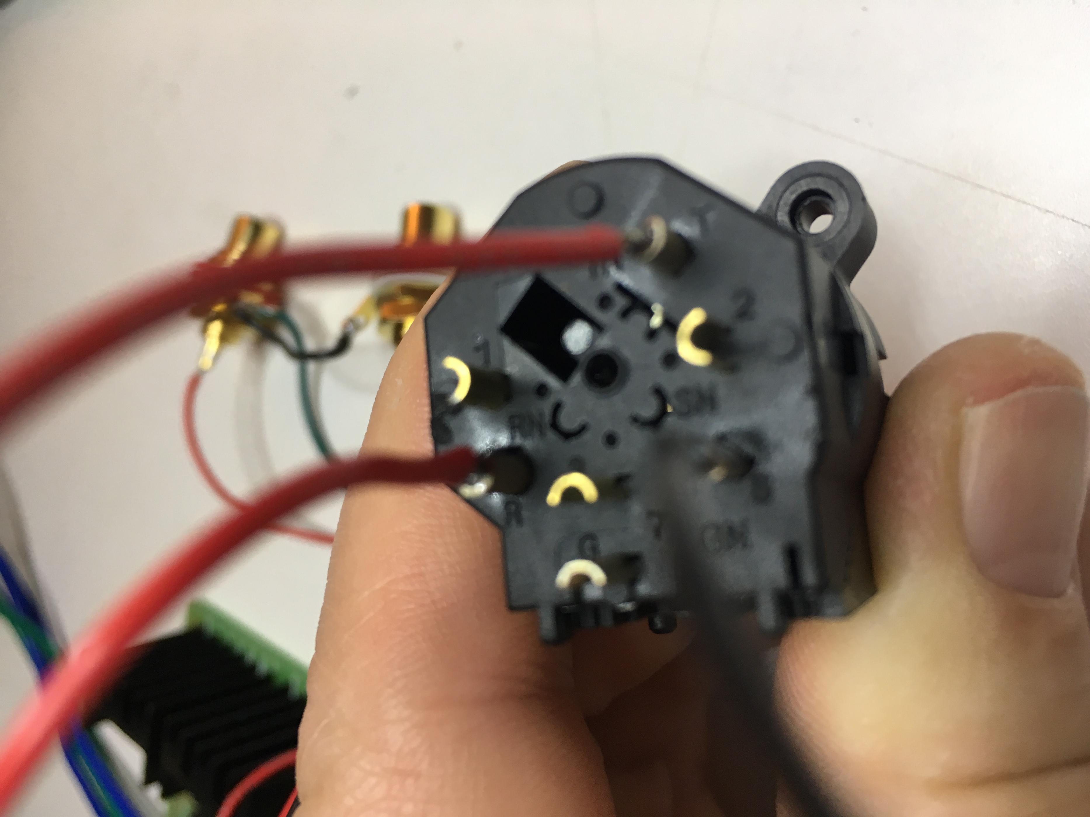

You have interchanged the inputs (RCA) and the output (6,3mm jack).

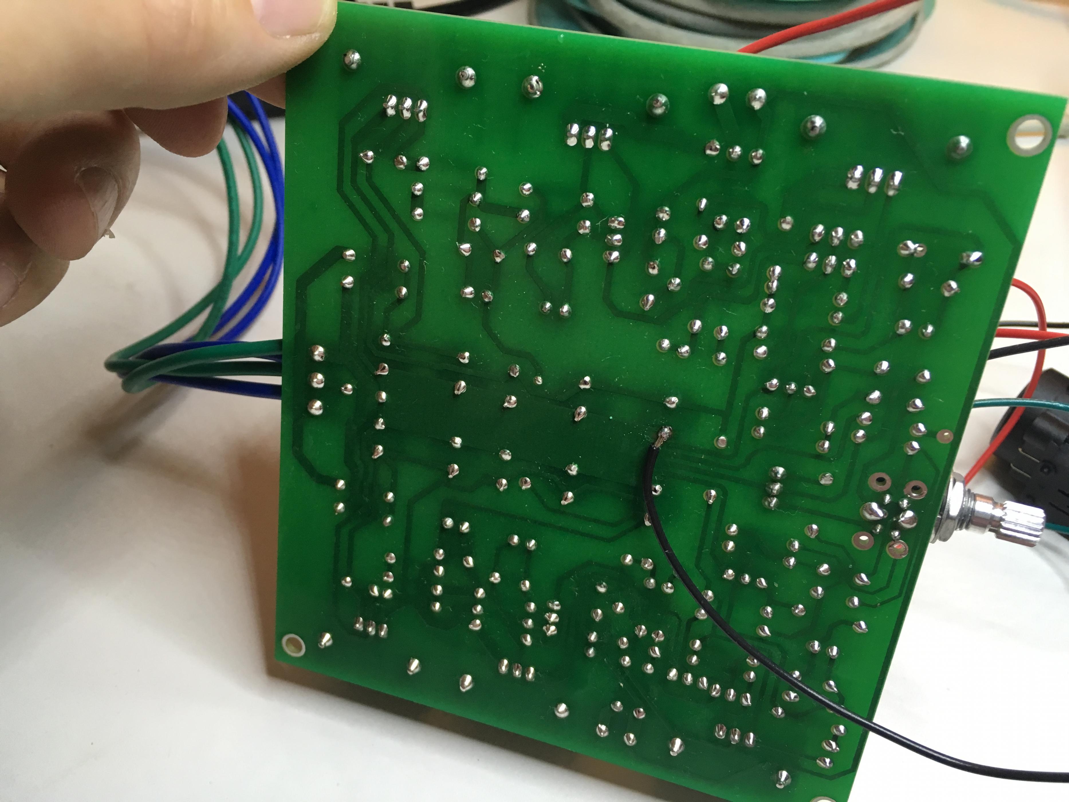

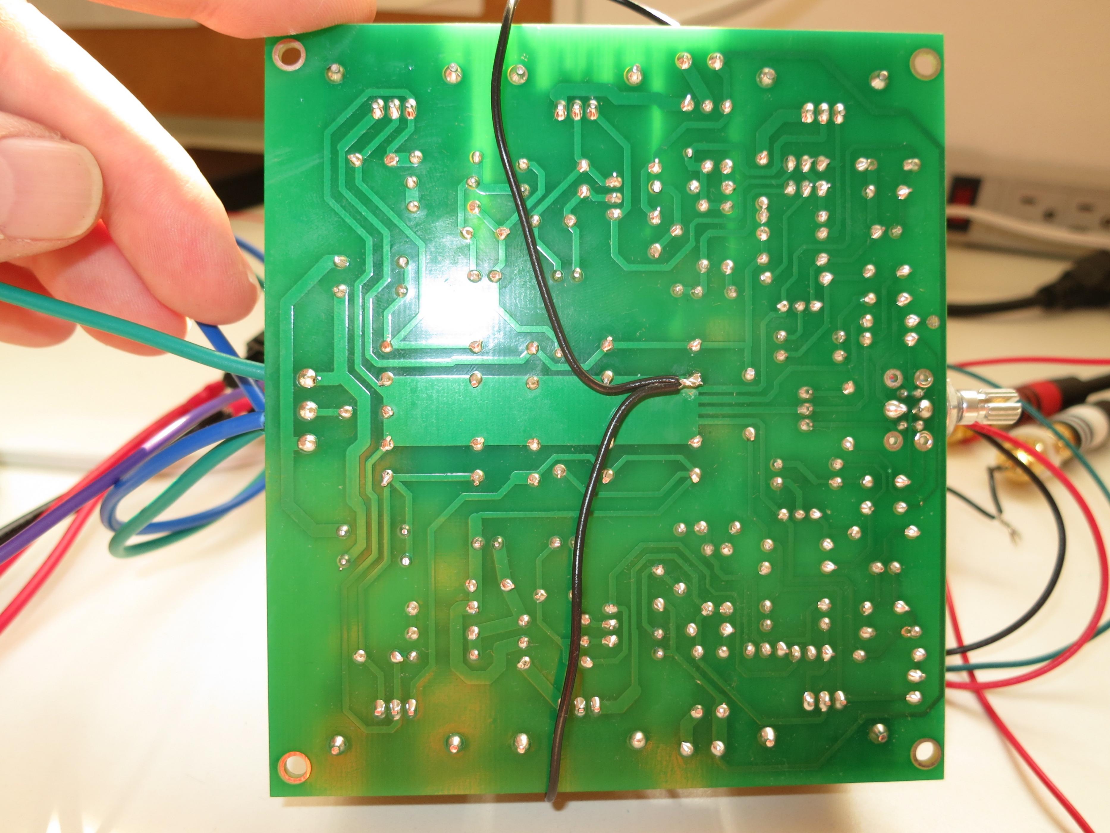

Refer back to the image in post 656.
Instead of using the output grounds near the outside of the board like you're doing, try connecting both grounds to the long, wide ground trace in the center of the board.
Scrape off some of the soldermask on that trace and solder both output grounds to that point.
I always connect the grounds near the bottom of the trace close to where the 4 smaller traces exit.
That helped the hum I had, but you may have something other grounding issue(s).

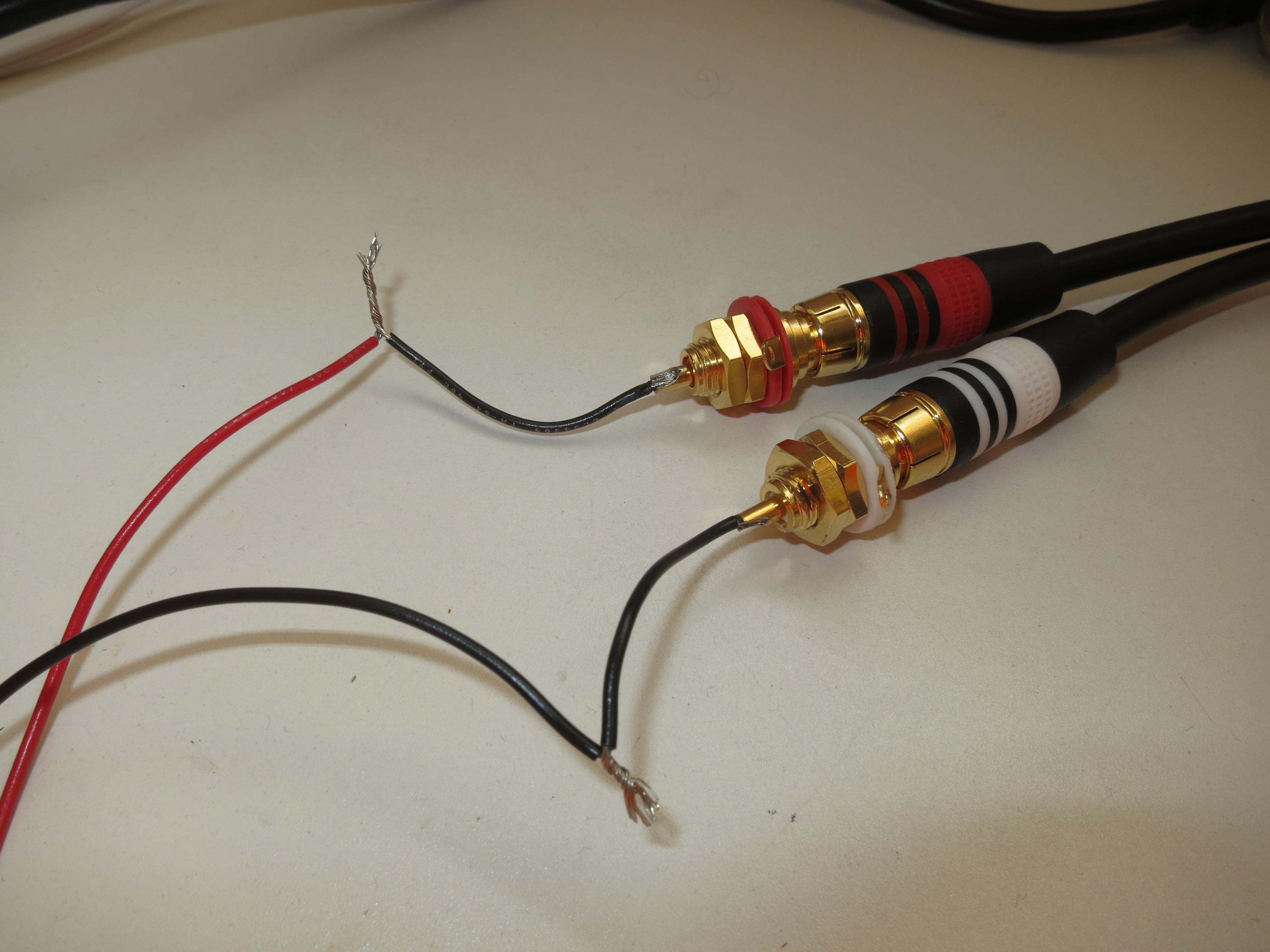

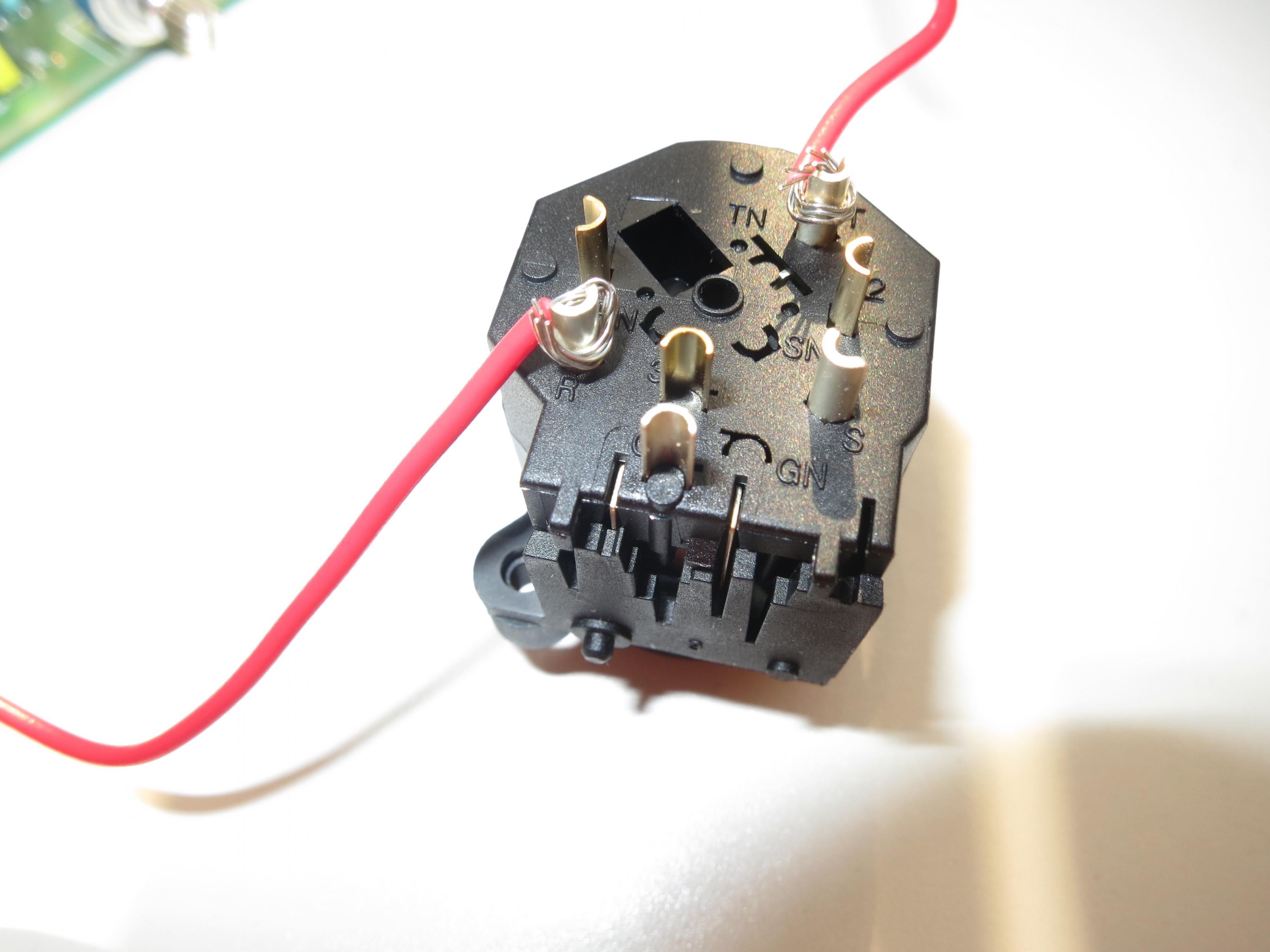

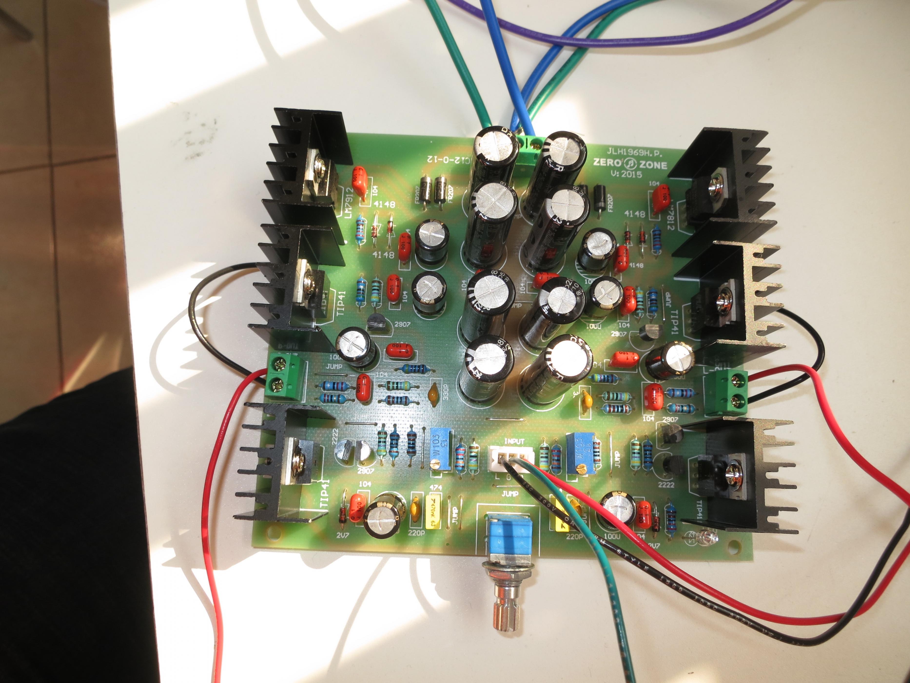

I wonder how it works - your pics show input RCA plugs and output headphone plug with no GND wire connected.... It works....
...Well it sort of works. Have sound from both headphones, but no separation left / right. Suggestions ? Using Neutrik 1/4" Thank you !

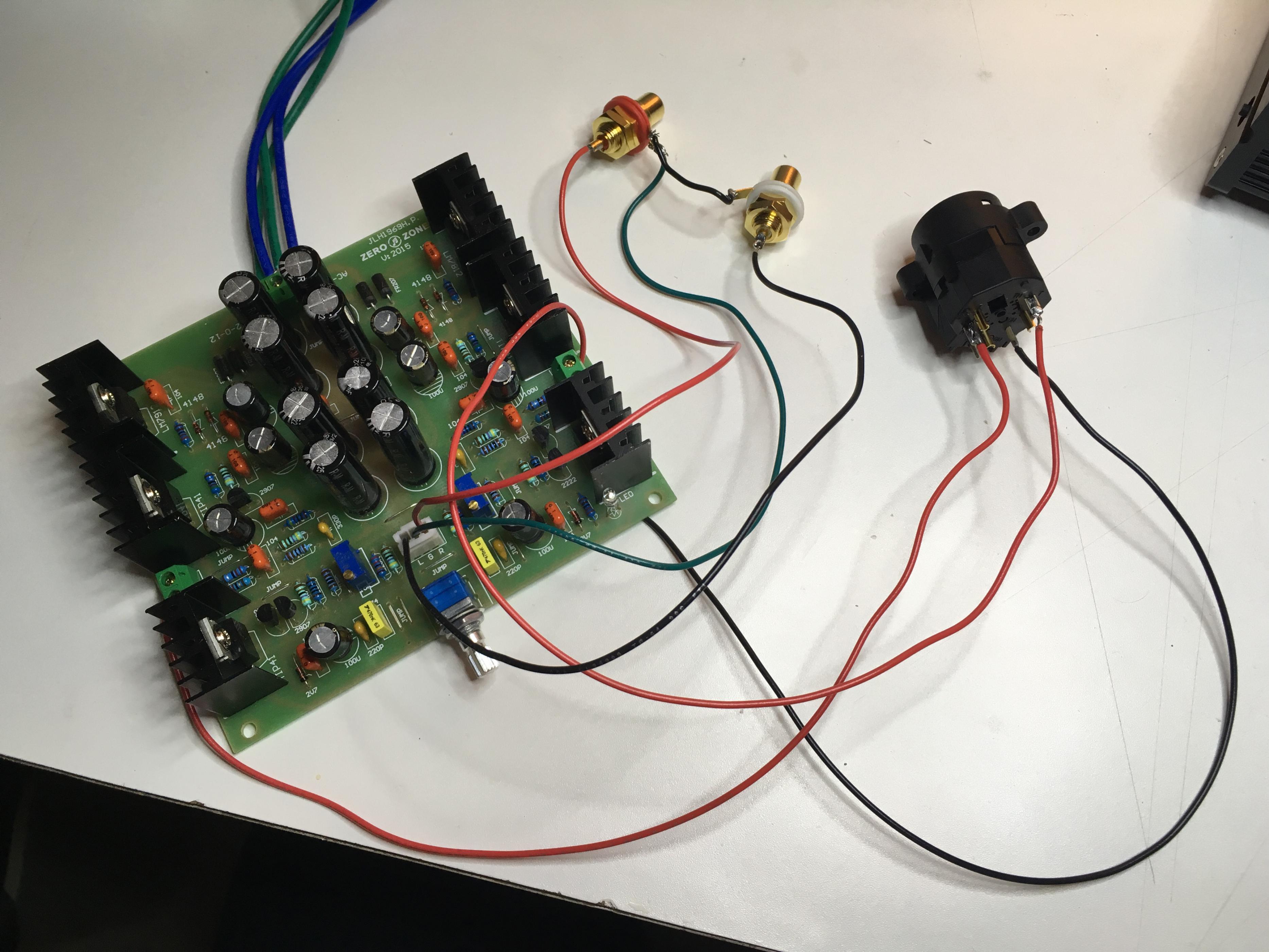

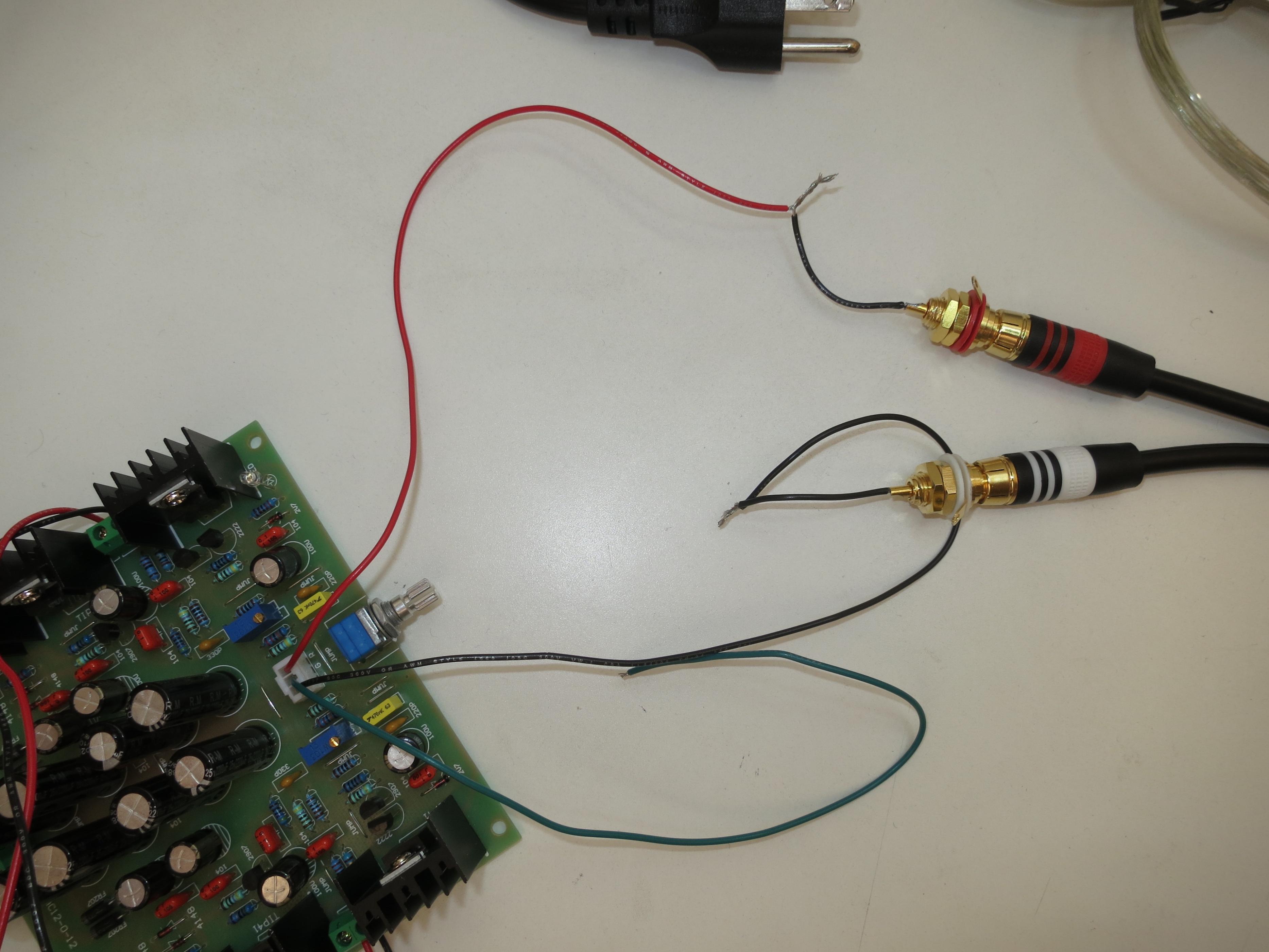

I took a couple of weeks off working on the JHL, was getting frustrated.
Still having trouble:
1. Have a loud grounding hum, gets louder if I touch any metal parts of the JHL, headphone jack, dac, etc.
2. No stereo separation, both channels playing the same audio.
Suggestions ?
Thank you !

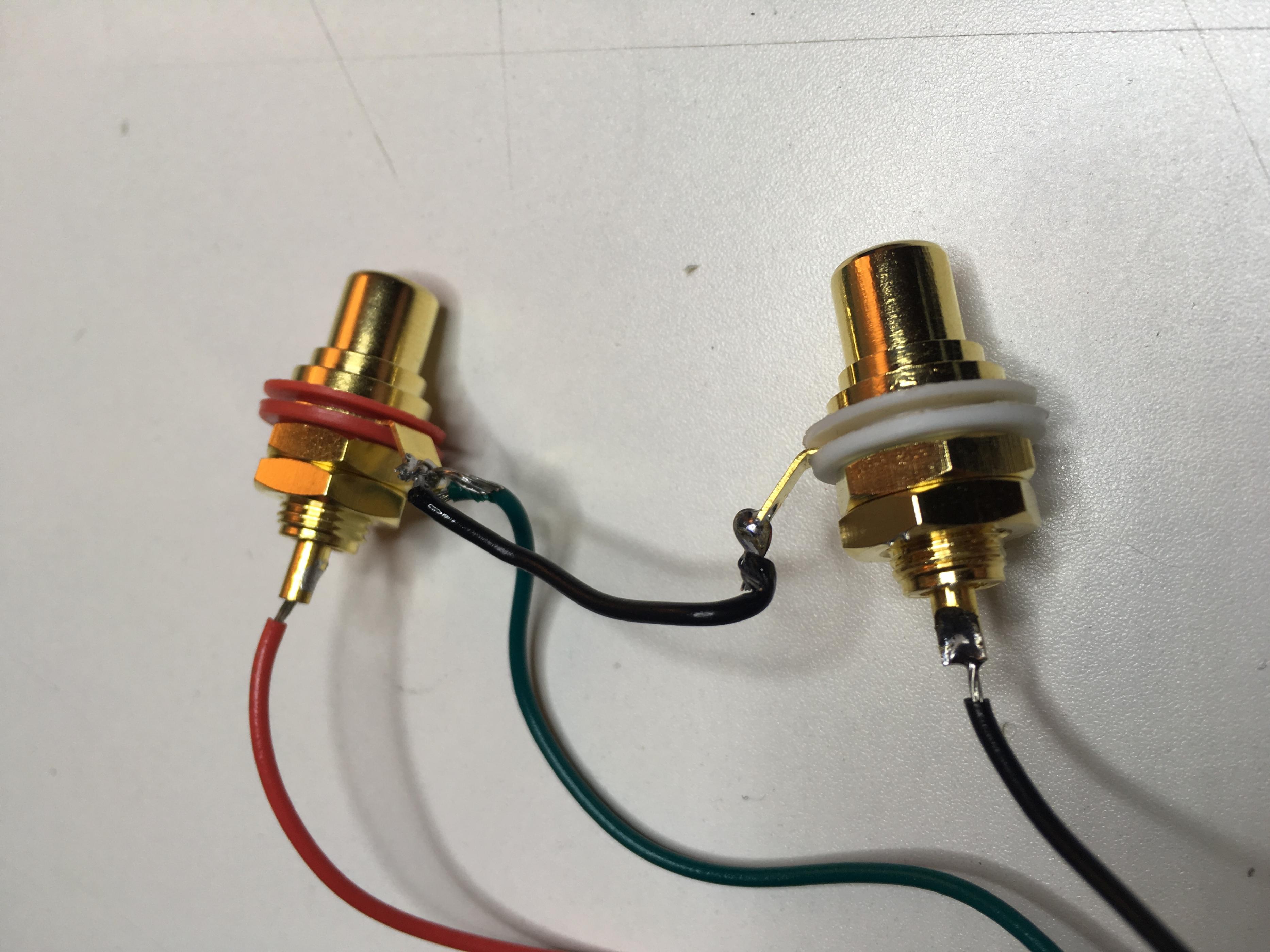

Are the two RCAs separate input channels?
The input to the amplifier should be a two wire connection and for loew emi these TWO wires must be close coupled. You can use coaxial or twisted pair.
For a stereo input you NEED two pairs of wires. One pair for each input.
What are the two red wires?
What are the four bue and green wires?
No you don't. I've used a common ground between both inputs before without any issues. Three twisted wires work just fine.
In addition, the board only has a provision for 3 wires on the inputs.
The red wires on each side are the L+ and R+ outputs.
The blue and green wires are from his Antek power transformer.
