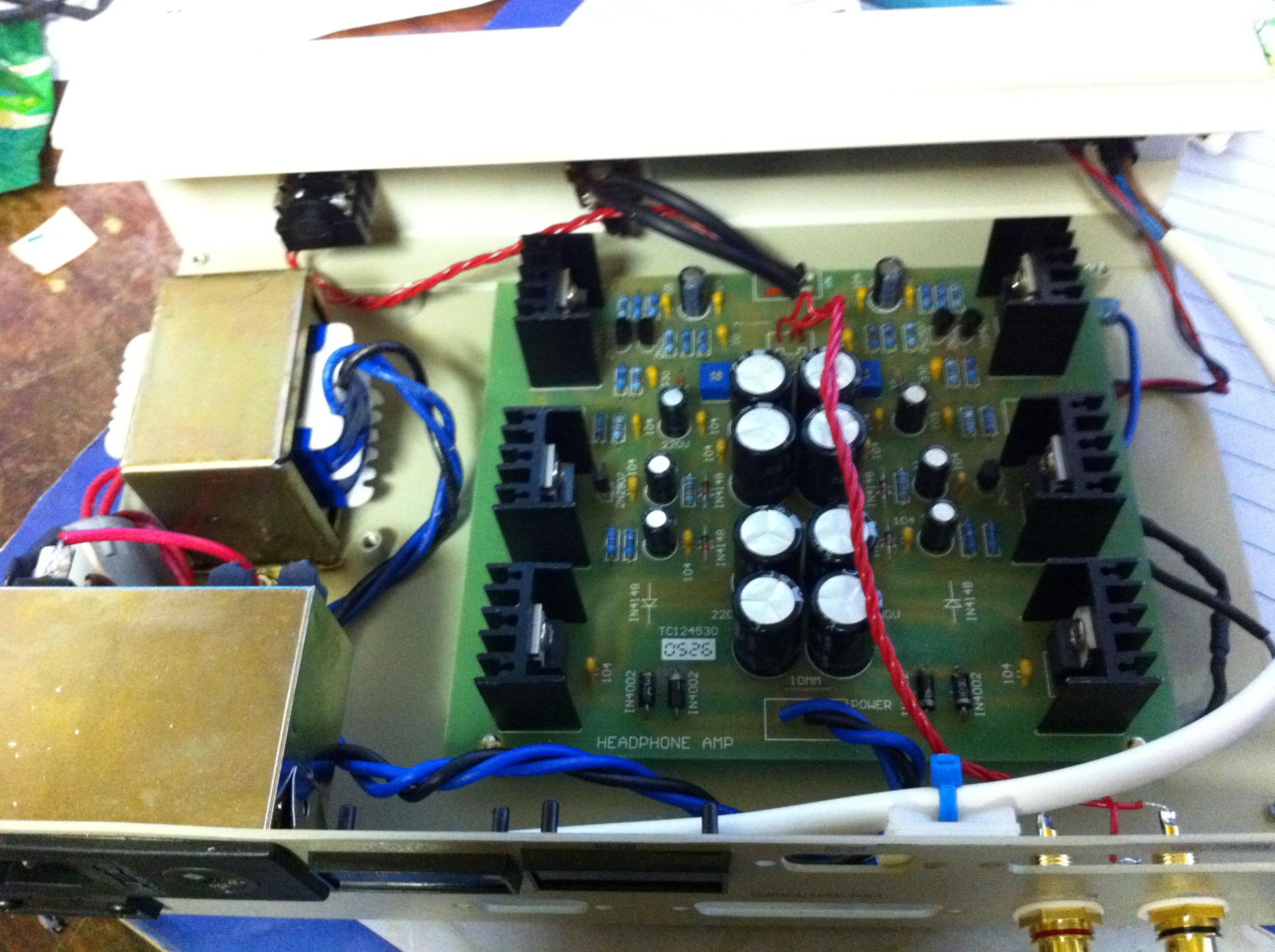

I followed these steps and wow what a difference, its still very sensitive to interference on the cabling but with careful adjustment of cable routing there is almost no background hiss at full amplification, I do notice some crackle when adjusting the volume; but I am certainly impressed. 🙂
Thanks to all for the suggestions
Lets try to fix your issues.
The ferrites will not solve your problem. You should remove them because they add no value in your situation - your problems are elsewhere as outlined below.
1. It looks like you are using non screened wiring to connect your volume control to the circuit board. I'd use some screened wire here - so inner two wires would be signal, and the screen the ground side of the pot. Reason: the pot wiper is a high source resistance, and therefore susceptable to a lot of noise pick-up via capacitive coupling.
2. You potentiomenter housing should have a good connection to ground - this should happen in any event because of the way the pot is mounted on the front panel. However, double check that your potentiometer shaft to chassis is open circuit. Highly unlikely, but just check it anyway.The pot housing acts as a screen, and prevents capacitive coupling onto the pot track.
3. Your cabling from the transformer onto the PCB - twist the wires tightly together so you minimize the area between the wires - this will reduce radiated noise (50/60Hz and harmonics). The way it s hooked up now means all this gunk is coupling into the volume pot wires and the PCB tracks.
4. Your headphone socket. Same story, twist the ground and L and R channels wires tightly together. Keep this bunch of cables well away from your pot cables and the transformer cables.
5. Use a meter and check carefull that your headphone socket is NOT electrically connected to the chassis other than via the headphone ground return wire to the PCB. To do this, unsolder the wires to the headphone socket and measure the socket ground to chassis - it should be open circuit. If you have a short, or low Ohms reading, you have a ground loop, and this will give you noise and hum.
6. Check that your input sockets are not connected to the chassis other than via the screen on the socket to PCB wiring.
7. You must have only 1 connection from your circuit board to the chassis. This must run from the junction of the filter capacitors to a secure point on the chassis. The incomming earth from the AC line receptacle must also be connected to the chassis. If there is any other path to the chassis other than via the single wire from the junction of the filter capacitors, it willl create an earth loop, and you will get hum and noise. Further, if you are anywhere near a PC or SMPS adaptor powered devices, the radiated noise from that adaptor wilol couple into your amplifier causing hum, hash and a lot of HF noise. Terrible stuff.
8. Final points: Keep the potentiometer wiring well way from the headphone and transformer wires. Keep the transformer wiring well away from the headphone and potentiomer wiring. Twist the wiring tightly as mentioned above.
Follow these simple rules and its quite easy to build audio stuff that is as quiet as good commercial equipment - so down at -100 to -120dB.
Lets tackle the problem you have when you plug into your PC after you have sorted the above problems out - I suspect however if you do 1-8 above, your problem will be solved.

great to hear you have made progress!
With respect to the crackle when adjusting the volume, there are three causes that spring to mind:-
1. If the input is direct coupled from the pot wiper into the amplifier (i.e. no input capacitor), then the input stage bias current flowing through the pot track and into the wiper causes a crackling noise only as you rotate the pot. Only way to fix this is to AC couple the pot into to your amp. Note that the higher the pot value the worse the problem. And, the higher the amplifer input bias current, the worse the problem too.
2. The second possible cause of this problem is a little more insiduous. If your amplifer is oscillating, you can get the same cracking sound as the oscillation is coupled into the potentiometer, and then rectified by the input devices. What you may notice with this type of problem is that the output is quiet, then as you rotate the pot a bit more you get cracking and noise, and then quiet again and so on.
3. The third one is when there is a high frequency, high level noise signal being picked up by the input wiring before the pot. You get a similar effect to that described in (2) above, as the noise is rectified by the input devices.
Do you have a circuit diagram?
Also, you did not mention anything about the hum - has it now disappeared?

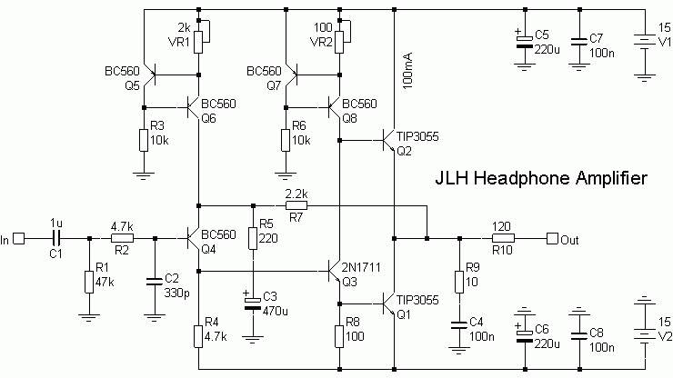

Here is a Headphone version of the JLH single ended Class A speaker Amp that you all maybe interested in I am collecting the parts so haven’t build it as yet
where did you get this schematics from? Have you already built it? What are the potentiometers VR1 and VR2 for and how should they be properly set up? I was planning to build original fig.1 schematics, so I suppose this one is better?
Can I use BD139 for the output transistors?
Thanks.
Hi
This Schematic came from Geoff of the Class Amps site he is the man you want I haven’t built it just getting the parts together V1/V2 Are for setting up the Idle Current and DC off Set this link will take you to his site and the speaker amp version email him he is very nice chap he will help you

I have built JHL headphone according to attached schematics. I have regulated rails and have absolutely no problem with offset, max +-10mV.

No, it's not a dc-servo solution. I uses two diodes as part of the biassing for the input transistor - the idea being that these diodes will vary with temperature and shift the input operating point to compensate for the effect of temperature on other devices in the amplifier with the end result that it will help maintain a stable dc-offset. This can work, I tried it initially in my TGM3, but I didn't use enough diodes to compensate for the changes. If the version in the link you sent is already built by others and known to work, then I would suggest it's a good choice as well as being simpler than the servo I implemented.
