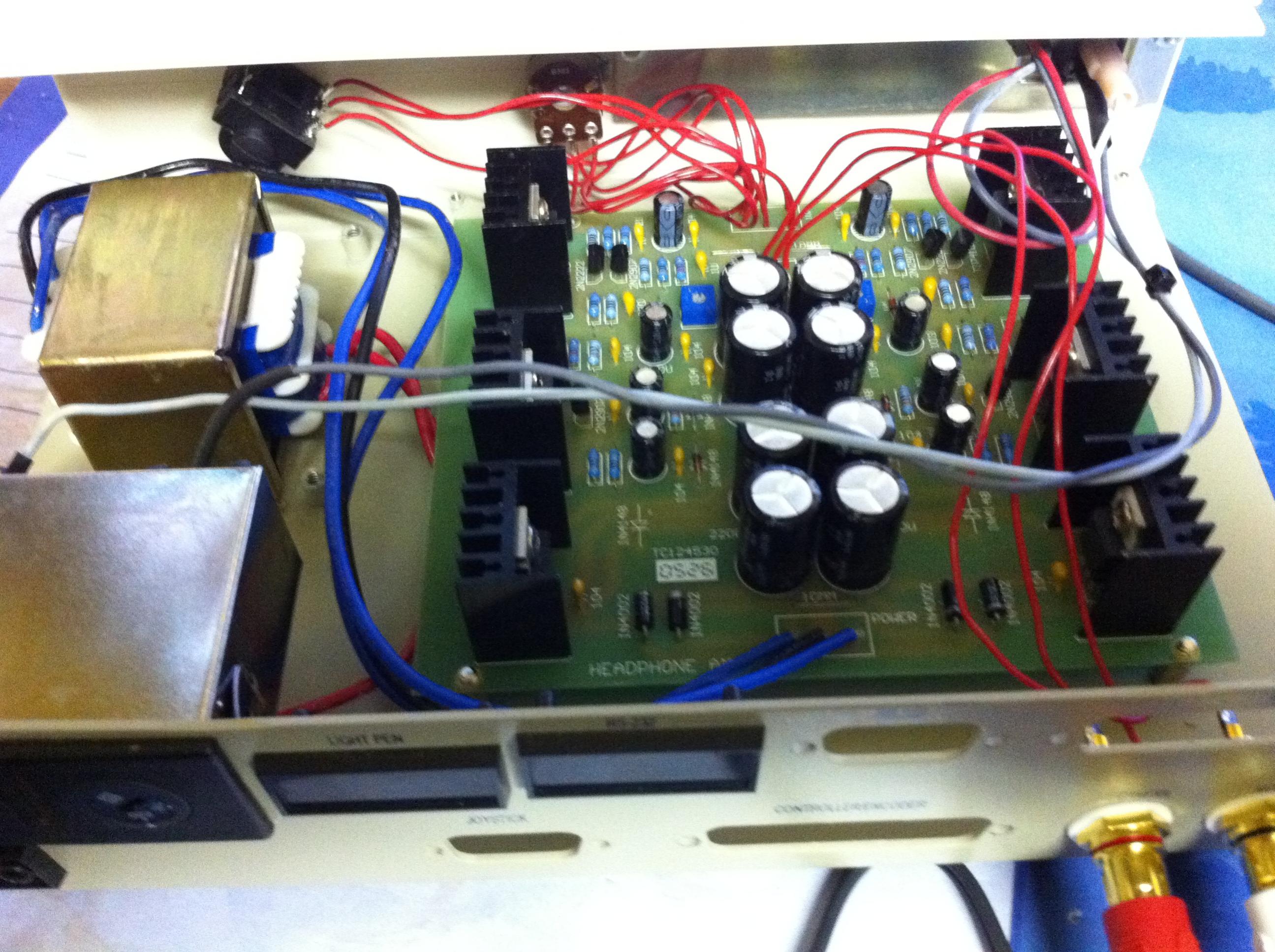

Some pics, its standard so far I wanted to get it working before I start messing with it. Setting the dc offset was quiet fiddly; it sounds excellent but its my first so don't have anything other than nothing to compare it with.
Heliguy, That looks excellent. Yes it's a very good headphone amp , you needn't have to compare it with anything else.

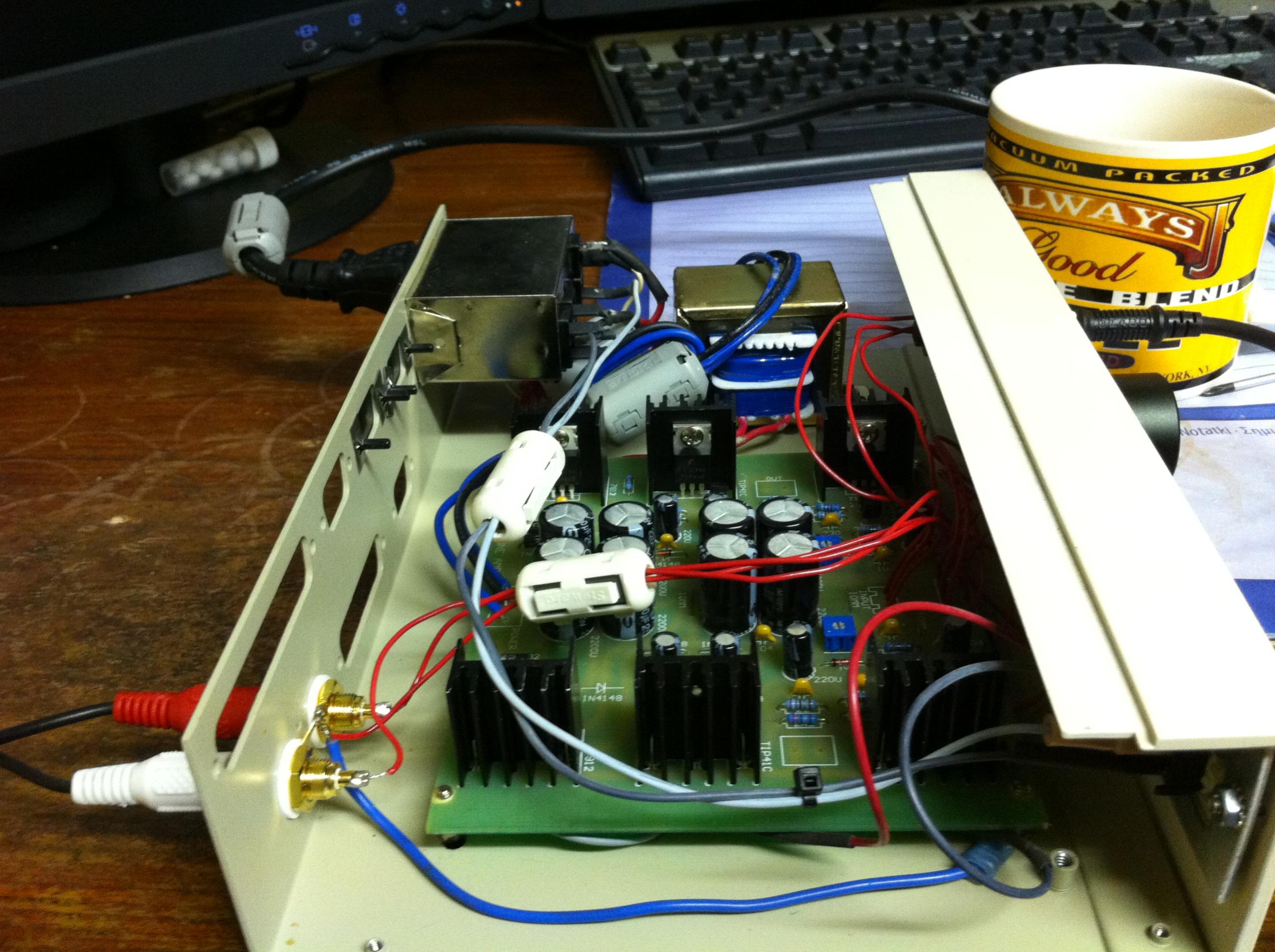

Ok I suppose it was to be expected but After more considered listening there an awful background hum; its not there or at least not noticeable at lower volumes but quiet irritating once I start turning it up a bit.
Should I tie the output ground to the chassis?
Should I ground the zero volts?
Would either of these help or should I be looking elsewhere.
Would a toroidal transformer help?
Would ferrite cores help?

ok the ferrite cores made little or know difference, but grounding the input made all the diff in the world, there is still a slight hiss any suggestions?
Also its input is an iphone; When its connected to the pc (iphone) there is horrible interference. Disconnect from pc and it gone obvious solution is not to sync while connected to the amp but it would be nice to charge it while listening, any idea's
Lets try to fix your issues.
The ferrites will not solve your problem. You should remove them because they add no value in your situation - your problems are elsewhere as outlined below.
1. It looks like you are using non screened wiring to connect your volume control to the circuit board. I'd use some screened wire here - so inner two wires would be signal, and the screen the ground side of the pot. Reason: the pot wiper is a high source resistance, and therefore susceptable to a lot of noise pick-up via capacitive coupling.
2. You potentiomenter housing should have a good connection to ground - this should happen in any event because of the way the pot is mounted on the front panel. However, double check that your potentiometer shaft to chassis is open circuit. Highly unlikely, but just check it anyway.The pot housing acts as a screen, and prevents capacitive coupling onto the pot track.
3. Your cabling from the transformer onto the PCB - twist the wires tightly together so you minimize the area between the wires - this will reduce radiated noise (50/60Hz and harmonics). The way it s hooked up now means all this gunk is coupling into the volume pot wires and the PCB tracks.
4. Your headphone socket. Same story, twist the ground and L and R channels wires tightly together. Keep this bunch of cables well away from your pot cables and the transformer cables.
5. Use a meter and check carefull that your headphone socket is NOT electrically connected to the chassis other than via the headphone ground return wire to the PCB. To do this, unsolder the wires to the headphone socket and measure the socket ground to chassis - it should be open circuit. If you have a short, or low Ohms reading, you have a ground loop, and this will give you noise and hum.
6. Check that your input sockets are not connected to the chassis other than via the screen on the socket to PCB wiring.
7. You must have only 1 connection from your circuit board to the chassis. This must run from the junction of the filter capacitors to a secure point on the chassis. The incomming earth from the AC line receptacle must also be connected to the chassis. If there is any other path to the chassis other than via the single wire from the junction of the filter capacitors, it willl create an earth loop, and you will get hum and noise. Further, if you are anywhere near a PC or SMPS adaptor powered devices, the radiated noise from that adaptor wilol couple into your amplifier causing hum, hash and a lot of HF noise. Terrible stuff.
8. Final points: Keep the potentiometer wiring well way from the headphone and transformer wires. Keep the transformer wiring well away from the headphone and potentiomer wiring. Twist the wiring tightly as mentioned above.
Follow these simple rules and its quite easy to build audio stuff that is as quiet as good commercial equipment - so down at -100 to -120dB.
Lets tackle the problem you have when you plug into your PC after you have sorted the above problems out - I suspect however if you do 1-8 above, your problem will be solved.
Someone else also had the hiss problem. He found that it actually came from his iPod equivalent source.
Short the inputs to ground and see if you get hiss. If you don't then thhe hiss is coming from the source. If there is a digital control for volume on the source the output circuit in it is going full blast and chance of audible hiss is very high.
If all else is fine and the hiss is always there, you might be having some HF oscillation. You can try a larger compensating capacitor. Try 50% more, then double its value an dthen triple. But doing that could kill the slew rate and affect the quality of the sound. It would b eideal if you get to see the output on a scope. It should tell all.
Dear all,
With respect to the ebay JLH amp. I had no problems with hum initially as I evaluated it powered by two car lead acid batteries.
I then wired up a transformer without testing so it ended up the wrong way and destroyed the power regulation capacitors. 25 V to 15 V is a lower tolerance than I would have done in my own design. I then replaced the power regulation input capacitors and bought a second ebay amp.
I then decided to power it from my preamp power supply of +-15V regulated. This solved most of the HUM issue.
I then found an old box of biscuits tin and put it in with an earth connection and finally the HUM was gone.
With the new amp I still have some high frequency noises, that sound like an old AM radio, so I guess I have some oscillation issues with it. I have to try my fixed version and see if that has the same issue, as I never noticed it before with the batteries powering the amp.
I will get back to you all with some scope measurements some time.
Regards
Owen
Regards
Owen
