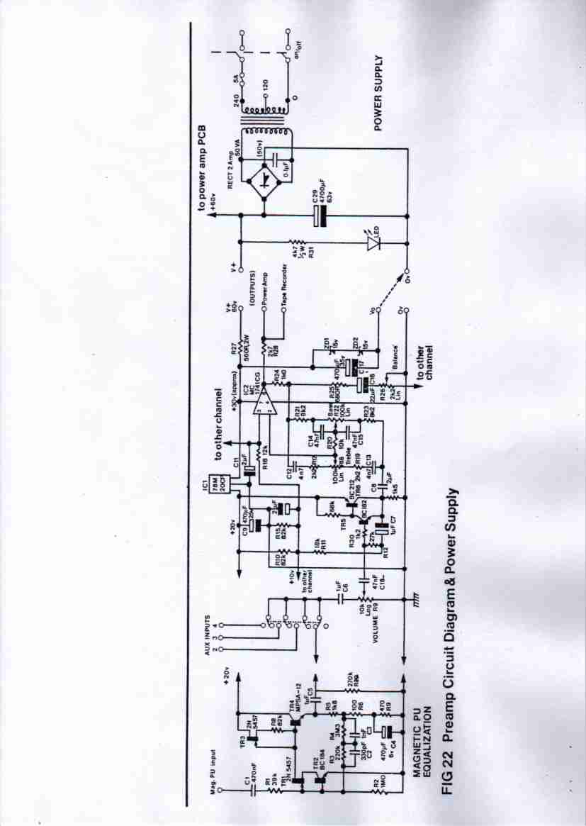

I´m back home again. Sorry for the delay.
Here comes the uploads.
Mjona, thanks for uploading parts of it. There is more.

@mjona: power supply integral part of the pcb.
No. What you see on the photos is not the power filter caps, but a parallel bank of output caps. No problem installing a series resistance.
upload scans courtesy of Geoff IIRC. I hope he don´t mind. There are more pages, but they have either nothing to do with the power amp or are already uploaded.
With JLH stuff it is pretty complicated. I wish those reprints were all available in some place. Nobody will have all the papers he ever published and sometimes valuable information will be missing and unobtainable.

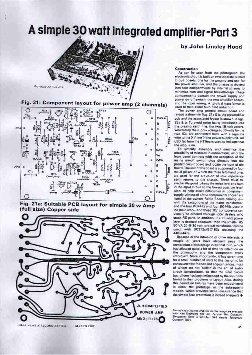

Helmut,
In regard to the foregoing comments I notice the red input capacitor is close to the multiple electrolytic ones at the output - I see that as waving a red flag in front of a bull. Bear's advice is nice in regard to the use of one output capacitor - it is advisable that you remove the ones that are closest to the input capacitor and reserve the spot for the one furthest away for the one you want to use - whatever the value. If you cannot resolve the other issues he raises, the question arises should you adopt the board layout devised by Linsley-Hood - with short flying leads etc.
Since MOSFET devices can be finicky and given the difficulties you are facing it would not seem a bad idea to build the circuit using the Linsley-Hood board with Darlington Output Transistors and get that going first - and then do the MOSFET modifications.

I get the swing. I bite the bullet and redraw the layout.
While I am at it, I will incorporate the changes Hugh suggested for the VAS.

I would not do a new layout or decide to change the input, or discard the caps in advance of figuring out to a higher degree of certainty what is going on now.
You want to limit the variables, and not change multiple variables at the same time.
If you do make ur own layout, you'd need to be aware of some basic ideas that relate to how to create a reasonable layout, ie. routing.
You might want to first layout the circuit using "manhattan" type prototyping or using a general purpose copper perf prototype board.
Finally, best to stick to one login?
_-_-bear
PS. pretty sure I have seen JLH circuit boards for sale online, maybe ebay.
@AndrewT: I can follow you now. Thanks.
So happened in post#31🙂. I know this thread is already pretty long.
I have done many many layouts, but none of them were any reasonable power, let alone HF.
I always avoid prototyping board, rather make a decent pcb - usually less trouble. At some point you are going to need a pcb and then everything is different anyway in the land of parasitic capacities.
thanks,
-helmut
Best to state what you have done when asked, for example, whose layout are you using. (apparently your own??)
aquataur said:>Is the layout on your board JLH, or yours or someother??
Mine.
Some very good advise.I would not do a new layout or decide to change the input, or discard the caps in advance of figuring out to a higher degree of certainty what is going on now.
Don´t understand you here.Finally, best to stick to one login?
thanks,
-helmut
