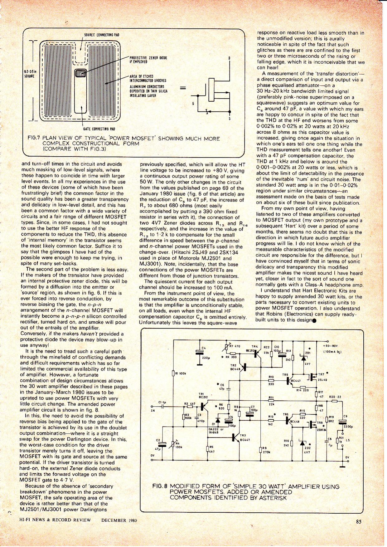

Typical JLH compensation directly on the input device. JLH claimed total stabilty with 47pF and perfect square wave behavior.
>Can you show us a picture of both your schematic and your implementation?
attached. I used the 2S type transistors for the preamp stages and the 2N types for the output pair. In case you wonder about the funny transistor sockets. These are my "universal" footprints that let me accomodate any transistor during evaluation.
>And to add, measure all the base/emitter voltages on all active devices.
Currently not possible. Waiting for new output devices.
The amp ran for hours with an actual speaker, just failed the reactive test and thus is not unconditionally stable and reliable.

> PS, did not spot a 47pf cap in the posted schematic?
From the input stage to the VAS.
>According to Hood's original circuit the ground is close the output whereas the >diagrams you have posted show this at the input.
That is true. I noticed the wrong path and made a more direct connection direct at the output devices, which you see on the photos.
The high current tracks are thus away from the quiet ones.
>PPS. mosfets sometimes like a larger gate ("stopper") resistor, and in some cases local HF degeneration on (iirc) the Nch side.
I tried 330Ohm gate stoppers - no change. JLH did not mention them in three updates. I thought the Sziklai pair was better in this respect.
>The values of the stopper resistors in each limb of the output compound halves differ
In the original article he uses different ones. In a later article (the one uploaded for better readability) he uses equal ones again. Sometimes there is a lot of guesswork why JLH did things.

Hood 30 Watt MOSFET articles
Hello,
I have scanned the original article authored by Linsley-Hood which is self explanatory.

Thank you! I wish I'd seen that back when, a few years later, I was struggling with many of the issues he mentions.
Frankly, so were a number of the professors (many, many power mosfets died unnecessarily 😀 )
But academia prefers peer reviewed articles in "respected" journals - at least those journals provided references to other work (unlike many trade magazines)
