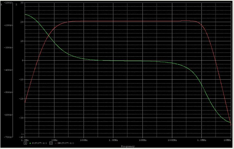

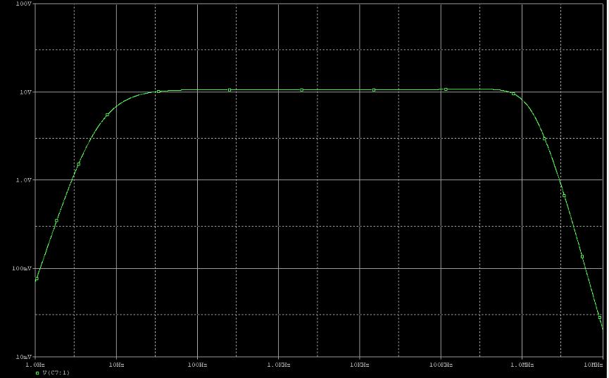

here is the ac analysis.
as you can tell, it goes down to about 10hz, far beyond what my ears can hear and what my speakers can reproduce. and I don't have any Cd players that output in the 0-2hz range, nor do I have any analog amplifier that takes spdif output directly.
note: C7 was there for stability testing. V4 to test psrr. the circuit can run on dual rails without modification but I don't recommend that as it has poor DC output control and without an output capacitor it can be dangerous to your speaker.
if the bass isn't good enough for you, you can use bigger bootstrap capacitors, or increase R4/R12 but you would need to recalculate the rest of the circuitry. in theory, the use of a CCS here (in place of the bootstrap) should improve bass but if you can go down to 10hz, it should be more than enough for most applications.
tlf9999 said:
I have yet to figure out how to do a phase plot.
Simply rename V(C7:1) to VP(C7:1).
Mike

Hi Mike,
It is very easy to understand this low frequency phase induced waveform distortion.
An amplitude plot of the original JLH is -3dB down at about 13Hz, and in its day this was fair enough.
However the phase shift at this frequency is in excess of 70 degrees leading.
At 30Hz the lead is 34 degrees; for 90Hz, 10 degrees.
Draw a 30Hz fundamental; overdraw a third harmonic; add the component amplitudes, and re-draw the resultant.
Now do the same with the fundamental leading the harmonic by 25 degrees, as per the JLH capacitor coupled design.
All of a sudden the redrawn resultant waveform distortion is considerable, even though the sine distortion of each component measured in isolation would be slight !
This is what the loudspeakers reproduce - no matter how imperfect they might already be !

DarkHorse said:but my walkman's headphone output can't output enough signal voltage to drives my amp,because it can only offer current to drive my headphone...
it should have enough voltage output as well. give it a try and let's say what happens.
I also simulated yours (2n5401 input, 2n5551 vas, and irf510 output). they are biased similarly to yours (1.3ma input, 4.5ma vas on 9ma ccs, and 600ma output). the gain is set at 40x. As I don't have a model for 2sk170, I used a perfect ccs in my circuit.
It performed identical to my version of jlh posted earlier. I tried to dial back the gain, or to increase the output impedance of the source (to 100k) and the perform is unaltered.
So in theory yours should work. I suspect now that the problem is either in wiring or in component selection.
