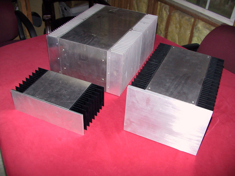

JLH 69 chassis and heatsinks
I just got a pair of JLH 69 boards. I have started planning and saw this thread. Perhaps I can get an opinion on size of heatsinks and drivers.
I realize the heatsink capability is related to Iq and at a particular supply voltage. And that the Class A operation demands the best heatsinking you can reasonably get.
So if you refer to the attached picture I found.....is the smaller case something appropriate to the 10W JLH 69 or bigger? The medium size case is fairly large.....is it appropriate or too big?
Also I am looking at using MJL21193 and MJL21194. Would these be a good choice?
thanks,
Tommytube

Re: JLH 69 chassis and heatsinks
Geoff tried MJ21194 (TO3 versions of MJL...) and reports that they sounded good but gave a low level hum that wasn't a problem with MJ15003. MJL21193 are PNP and not suitable.
There is no such thing as a heatsink that's too big.
These are nice looking boxes but you really need to know their degreesC/watt rating before you can be confident that you won't be able to fry eggs on them.
Have a look at the ESP pages http://sound.westhost.com, Geoff's site http://www.tcaas.btinternet.co.uk/index-1.htm and National Semiconductor's data sheet http://www.national.com/ds/LM/LM3886.pdf which has a very nicely written step-by-step guide to designing heatsinks.
Enjoy!
Enjoy!
