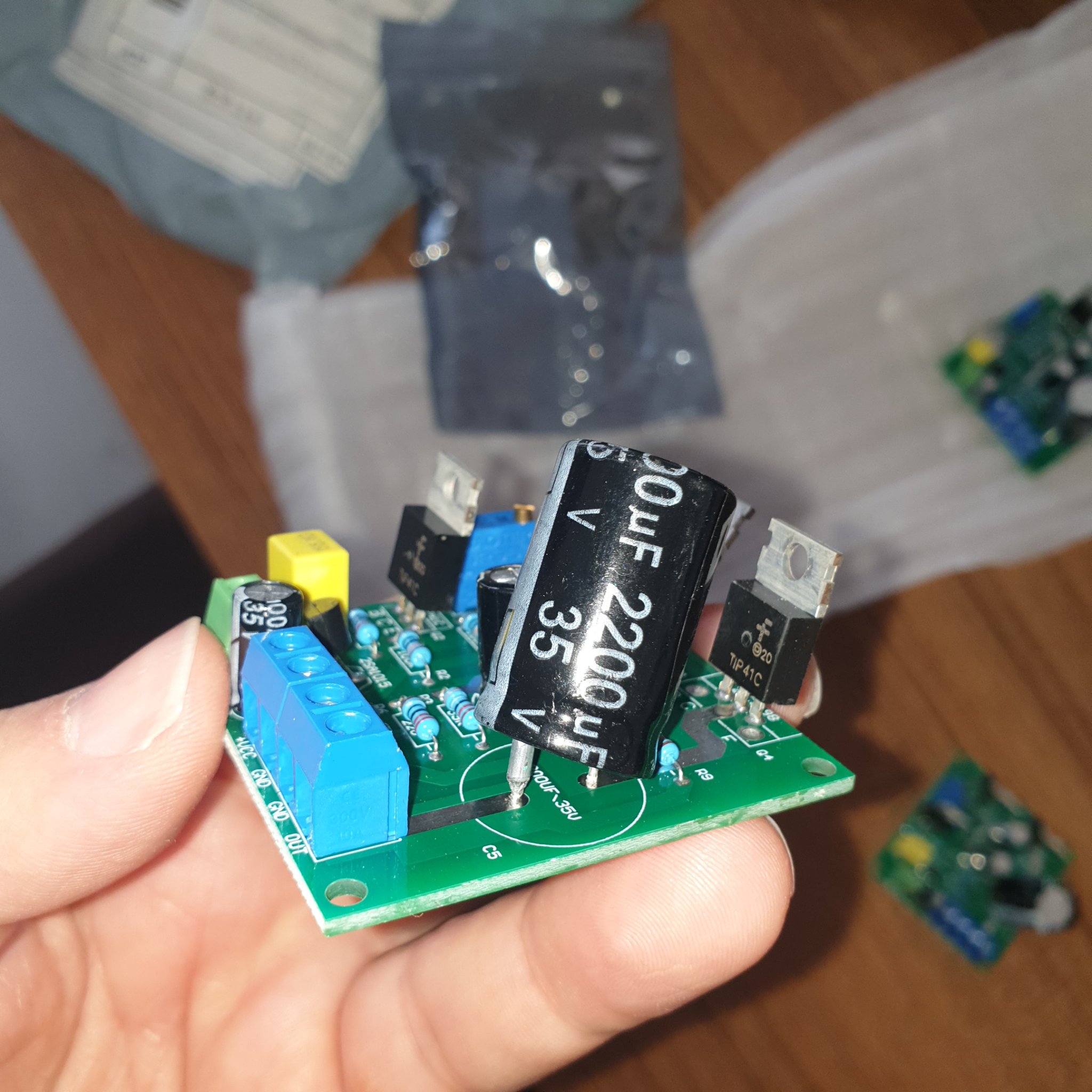

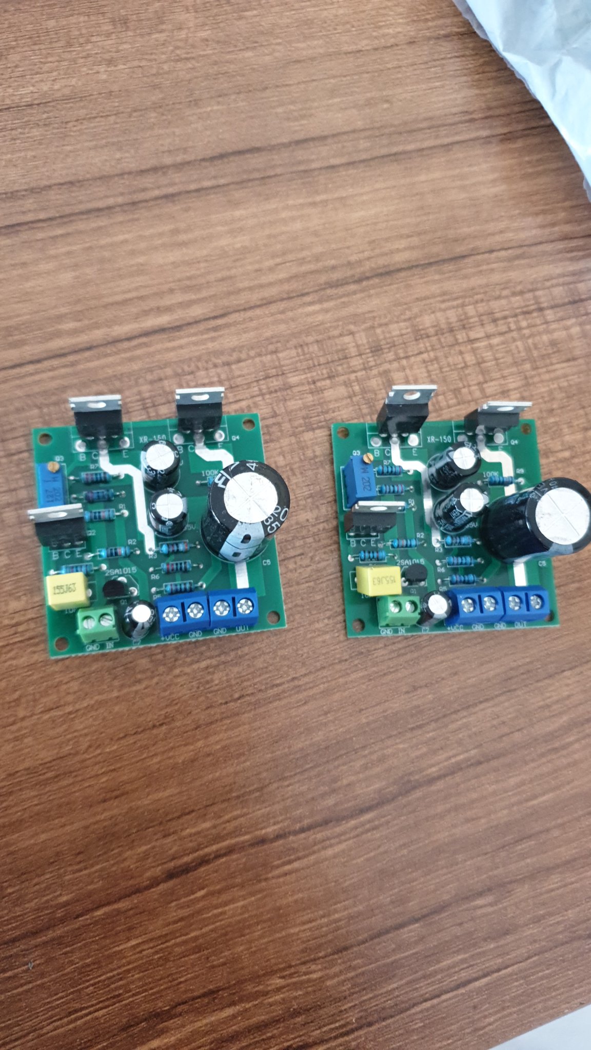

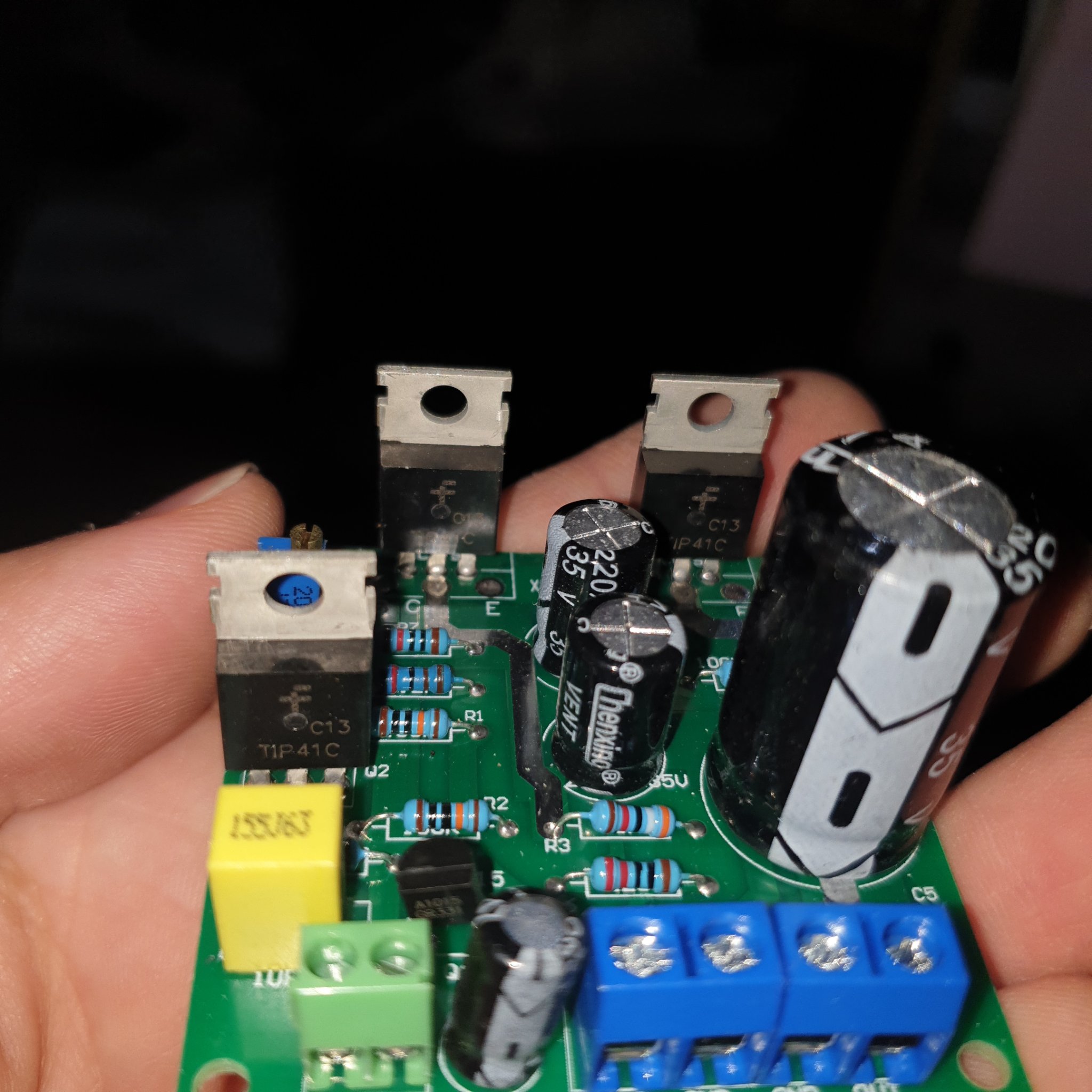

Hi. I have received Cheap Chinese jlh boards (1.5usd each plus tax plus shipping) today and tried with 12v with smps(adjusted to 14v and 1.5a bias ). I am surprised with the result. It sounds loud and good. Left transistor gets about 20C hotter than right one. I also bought another boards which have genuine transistors but this one also sounds good with all fake tip41c and 2sa1015
Yes, I listened to that one or a very similar little JLH amplifier and I was impressed too. It is electrically the same as an original type but uses small, very cheap power transistors. It is OK for headphones and many little desktop speakers but if you want to drive typical hi-fi speakers and make the most of the sound quality, you need at least a rated 5W of power output with 4 Ohms compatibility.
The circuit is similar to the original but you'll need a better driver transistor (TR3 on the JLH schematic) than TIP41. BD139 may not be the best replacement but it's cheap and available everywhere, otherwise 2SD669A (or maybe the smaller 2SD667A) will work better again but check their different pin connections against a datasheet and with your meter. 2SA1015 will be fine for TR4. You do have a small heatsink attached but I would look for something that is thicker, and will conduct heat fast, in order to keep the power transistors as cool as possible. 1.5A bias may not be necessary with a 14V supply anyway, unless your speakers are less than 4R and you push the amplifier to clipping on peak output levels.

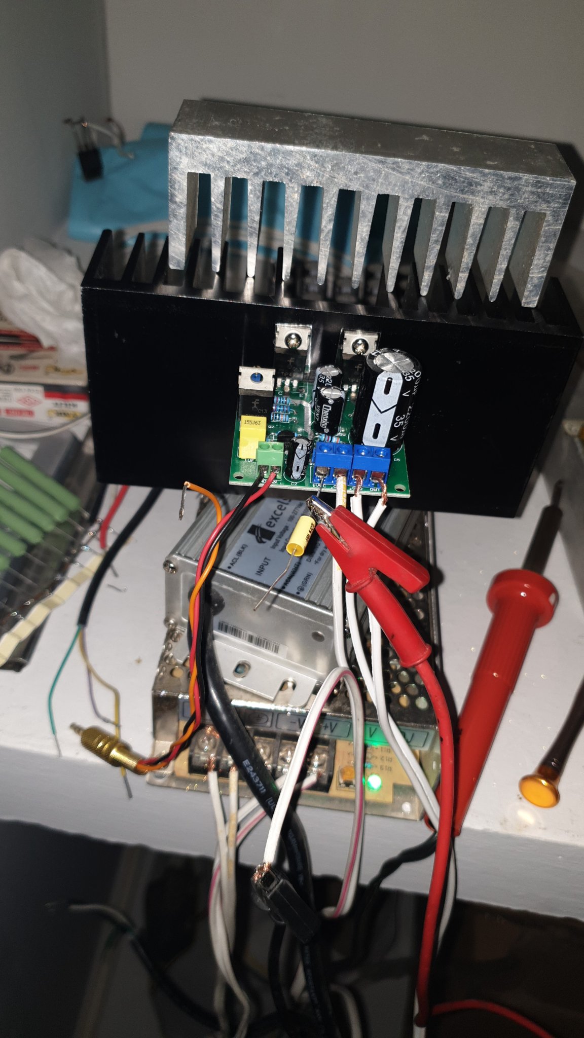

I just finished stereo and connected to Topping 20v 3A adapter for trying. Sound is amazing. I am surprised how 5w sounds such high volume.( I think I also just played 2w) Amplifier is very sensitive and there is some buzz on speakers but sound is very dynamic. I will make transformer version and with big heatsinks. Thank you all for your helps and suggestions.
