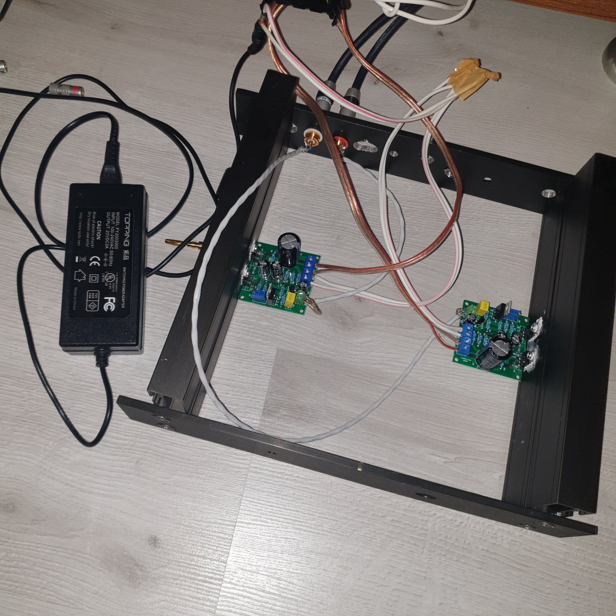

That's the same kit in #9178 but 3A bias current for each channel or both? I think 60W dissipation for one pair of genuine TIP 41spec. transistors would be too much and at >50C case temperature, derating should be applied anyway. https://datasheetspdf.com/pdf/1074675/ONSemiconductor/TIP41/1
You know, I've seen some with four heatsinks smaller than credit cards with the original 69 diagram and in TO220, I think we're more like stupidity.
Agreed, but if those credit cards were attached to the heatsinks, they'd be bubbling blobs of plastic if the bias current was 3A or greater.

Yes will do. We already made short listening tests. It was just a trial amp and l already checked the heat.66C left transistors and 45c right ones approx.Trial Heatsinks approx 50c. Everything is under control 😉I would distribute the transistors optimally to the heat sinks: move them apart.
I am just wondering if I change tip41c driver make a difference on sound now.

When you consider any power device, you should consider the SOAR!
Do you think there will be any sound benefit if we use lower capacitance bjt and cool it very well?
Maybe because of it is driven easier there will be improvements in sound quality
The TIP31/32 SOAR indicate that these transistors will be marginal at 10 w and 22VDC. Thus they should not even be considered.
The 2N3055 seems to exactly match the SOAR requirement for this amp. Why mess with parts you have not researched.
MJE3281 would be a perfect match, even if you want to push 25 watt

I also have used 2sc5200 Toshiba transistors in shelf but I am afraid if they cause oscillation because of high fT. Maybe I can give a try?
I would, with one channel only but start with the present low voltage and current settings before raising them to the full ratings. You may get a fault whether it oscillates or not, so keep an eye on the current, an ear at the speaker and stay close to the power switch or DC connector.
For reference, this is an alleged specification of the mini JLH kits, as they come, correctly assembled and powered as suggested. It was posted at "Survy 2014" store:
1. Model: 1969 small group A
2. Tube Model: TIP41C
3. Output power: 5 W per channel
4. Power consumption: 20 W
5. Power source: DC 12-30V
6. Current Static: Standard 25 v DC to 0.8-0.9A
7. Board Sizez: 5x5cm
8. Resistance: Fully five-precision metallic film resistor ring
9. Adjust Resistance: Sealed multi-turn adjustable resistance
10. Input Capability: Farah Campaigns Promise
11. Electrolytic capacitor: high capacity
As you can see, this has differences to claims made by other stores and obviously to the original JLH'69 but it is more likely to be correct for these kits and should be adhered to for safety reasons. Note that 30V maximum supply voltage does not mean you can also use that voltage with a maximum bias current setting. That will overload those little TIP41s! Some advertisers are listing performance figures that refer to the original 10-15W design. That's misleading and potentially dangerous if you power the kits according to the wrong spec.

Completely agree with nico concerning the SOAR and something else not to be overlooked, it is the specific pairing of the power transistors, it is not for nothing that I end up with more than 500 TO3 from the 3055 15003 family and other exotic from Tesla and others, it's really important.
I repeat, a jlh69 will always produce a correct sound but to obtain the quintessence of it you must carefully choose the components according to the original document and the work of those who worked on it a few years later.
