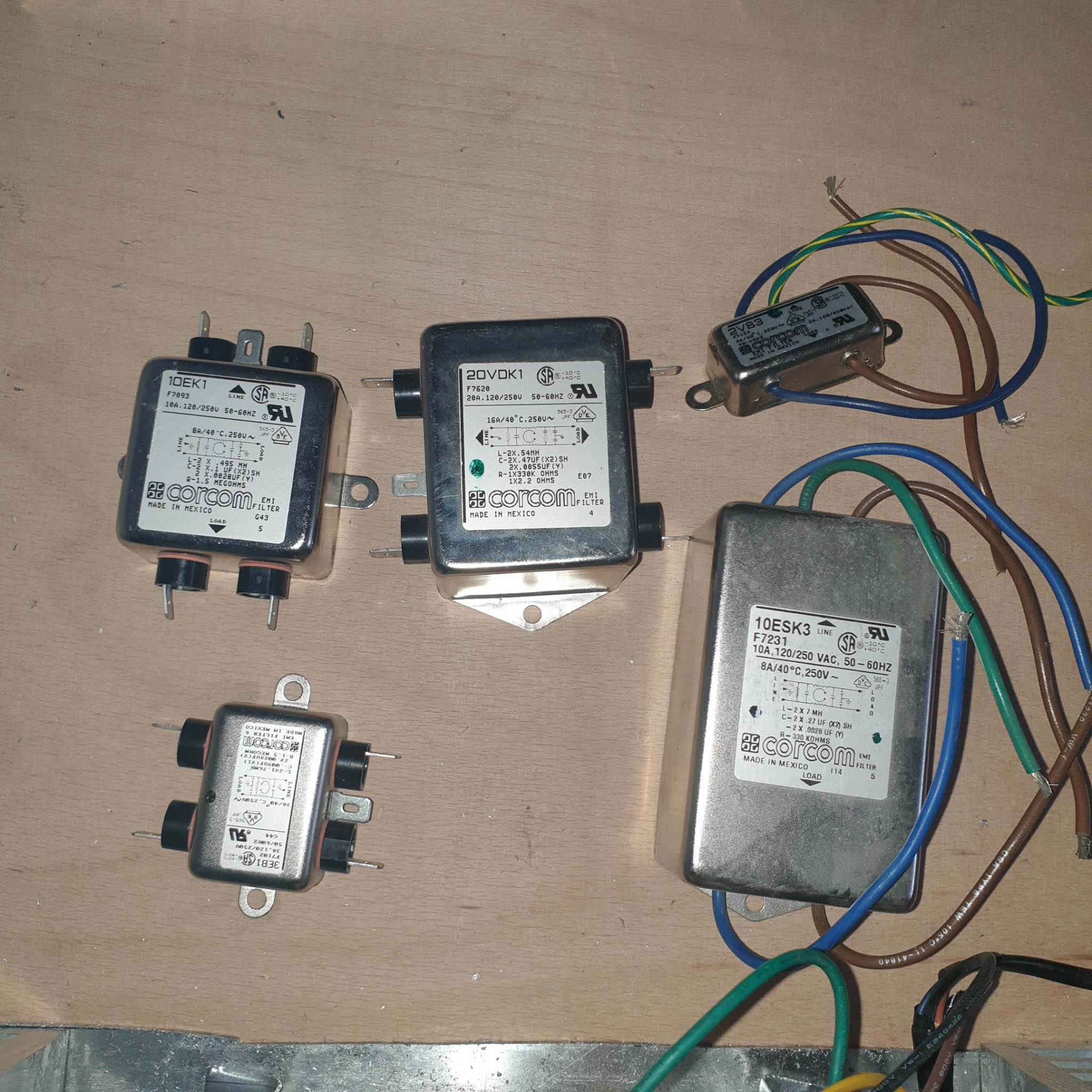

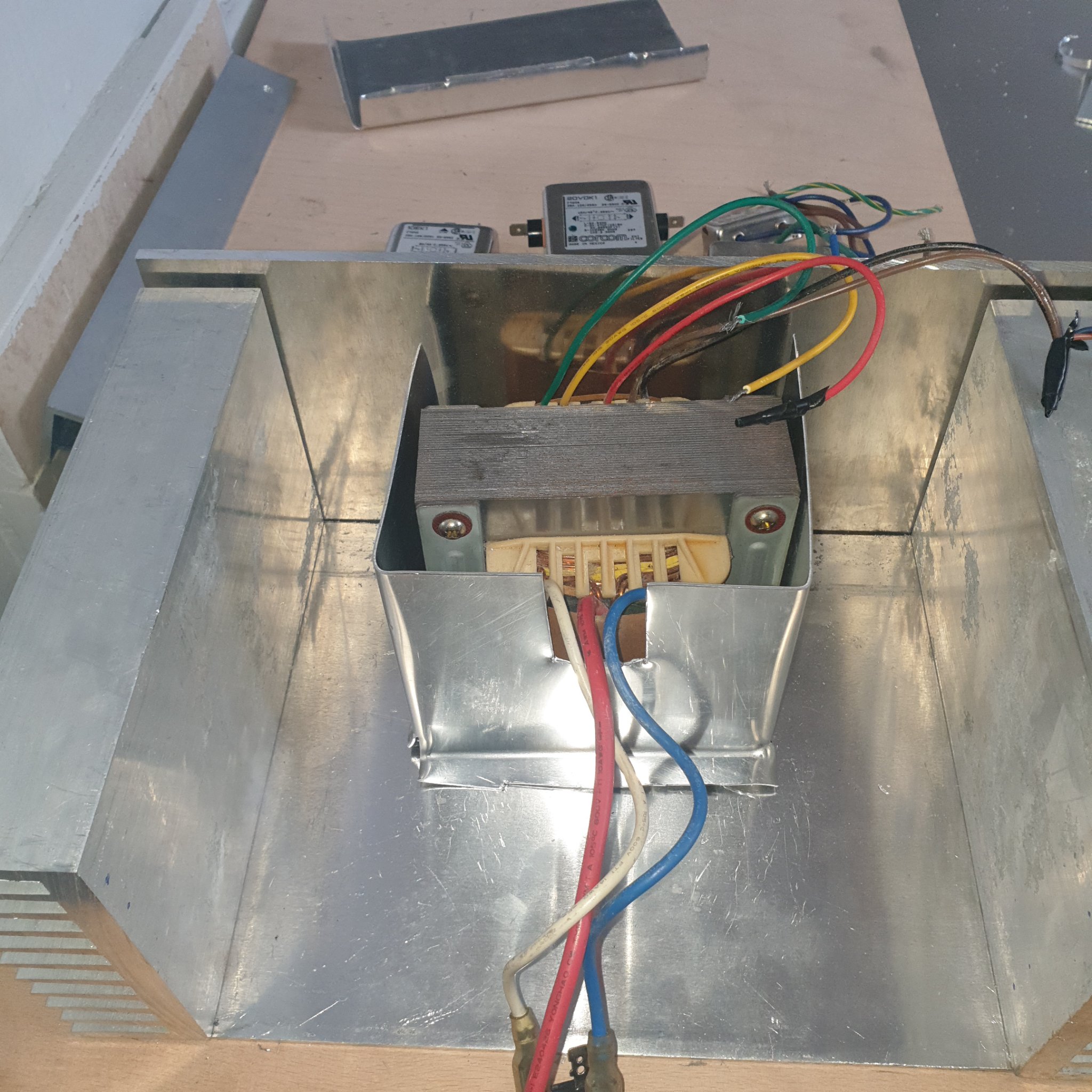

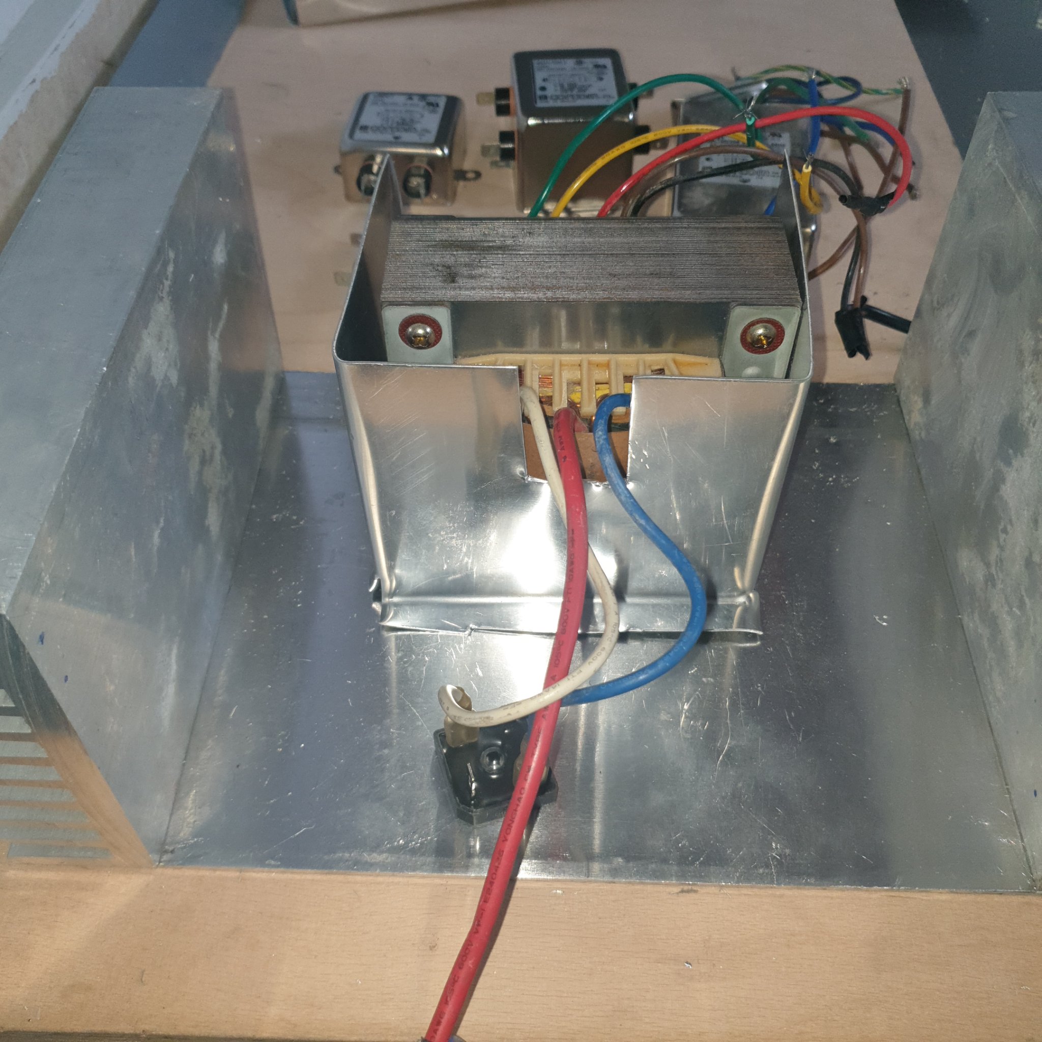

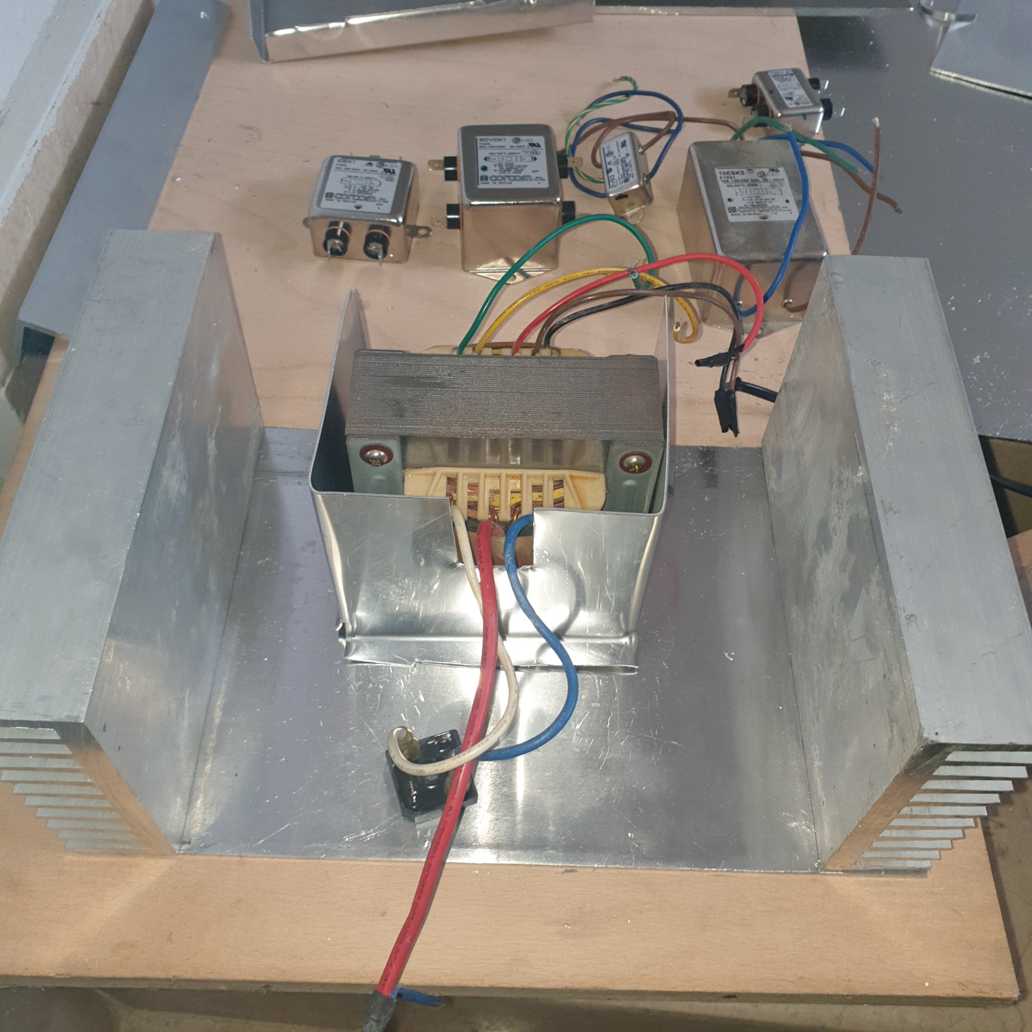

Hi. Because of i have transformer I made a shield for it from 1mm aluminum which also was in my storehouse. What is your opinion? Is it good or should I use stell sheet? I also have emi filters and maybe it also helps. Which filter to use? I have many of them.Do you think grounded or ungrounded is better for my application?

Aluminum is virtually transparent to magnetic fields so it won't do much or anything to shield your amplifier from the transformer's electromagnetic fields. You could shield low level audio circuits and PCBs with grounded ~1 mm steel and use shielded wire for audio signal leads to some benefit but with power transformers, distance and orientation (turn them around and listen) are the most cost-effective ways to reduce 100Hz hum.
