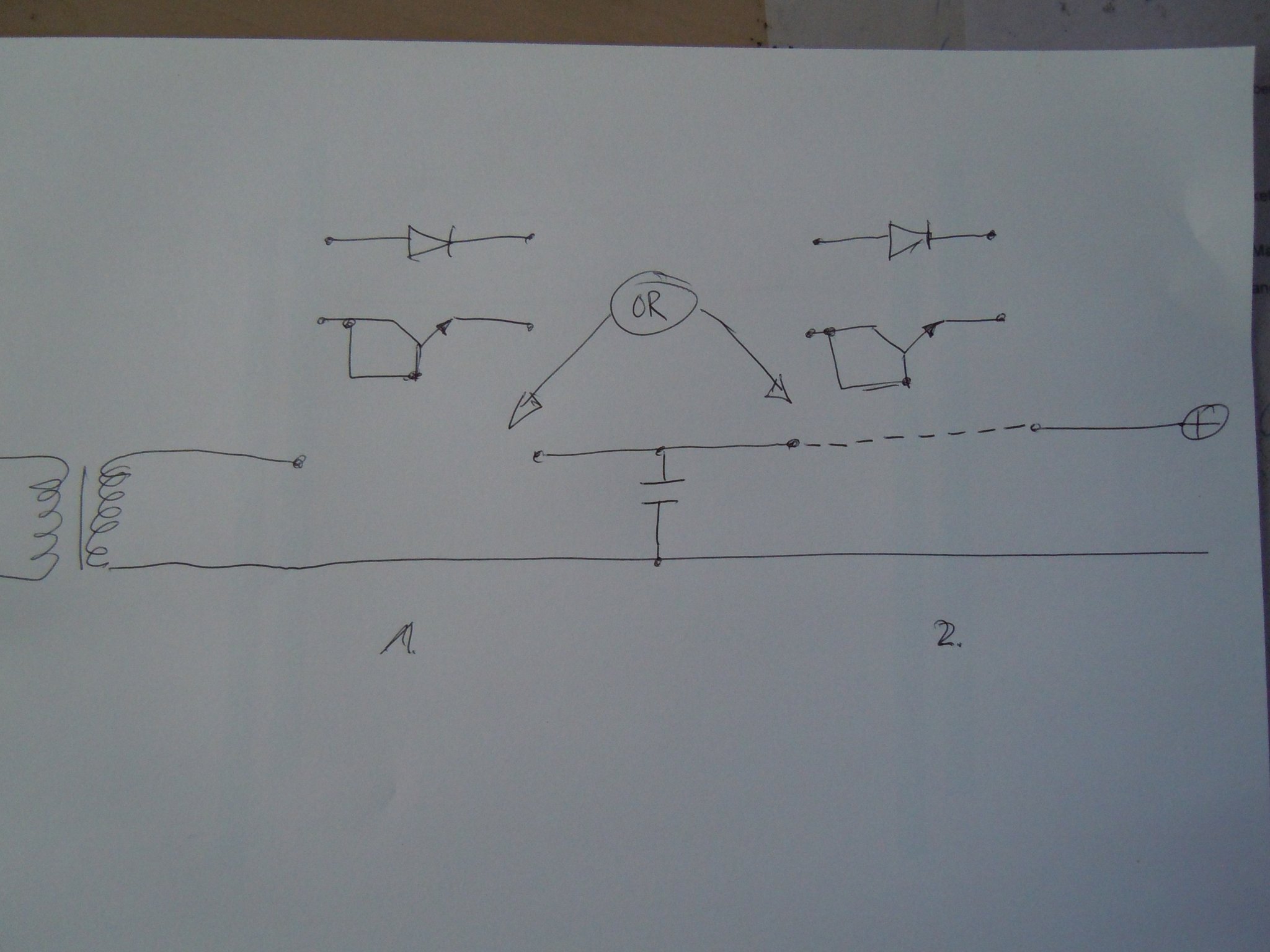

cummb, I would just develop a printed circuit board to test the different solid-state devices I have read about so far. 2N3055, MJ15003, TIP35C and so on. I also have some MJ480s to try out.
Maybe trying mosfets as well, in the output stage only.
Your approach is more complicated than mine.
In any case, I am very curious to see your schematic.
With what, exactly?Maybe another quote from the man may help
I don't think there is any doubt that the amplifier works with transistors with ft's in the 4Mhz region. What I am discussing is the best option to ensure stability with modern linear gain high speed transistors which JLH did not seemingly manage to address before they came widespread. I haven't claimed a circuit which has been tested in this configuration, only basing it on what I see in simulation, but I have suggested his solution to reduce high bandwidth is not desirable - as he pretty much said himself as you point out in your post.

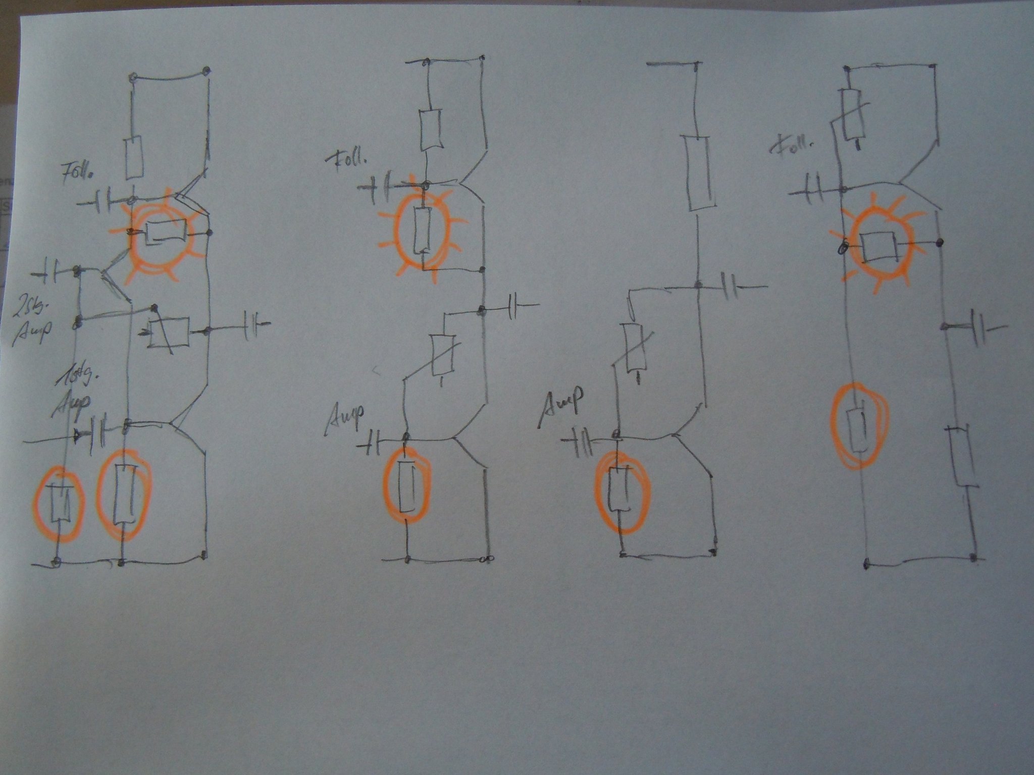

Pic 1:... to test the different solid-state devices
Test of sound character of transes easy in sketch 3, 4:
The resistors circled in orange could be omitted. Step by step;-)
Do not use wire resistors.
Uses only two legs of the trimmers.
Positive feedback in followers or current source is feasible (orange sun). Also works sonically comparable Darlingtons.
Pic 2:
Test of sound-character of diodes and power transes:
Power diodes and power transistors simply inserts into the power supply. Either instead of the original (1) or, if e.g. transistors do not survive this application, simply in the middle, whether before or after the capacitors or filter coils - no matter (2). Something like seen below.

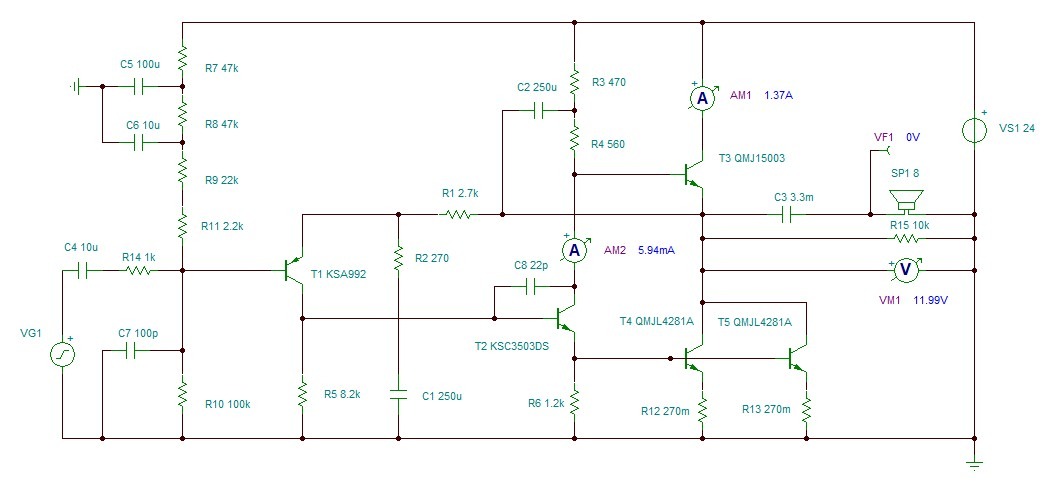

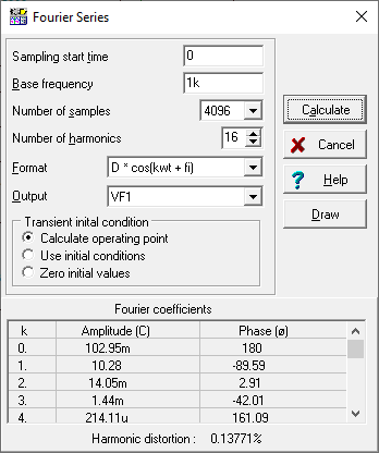

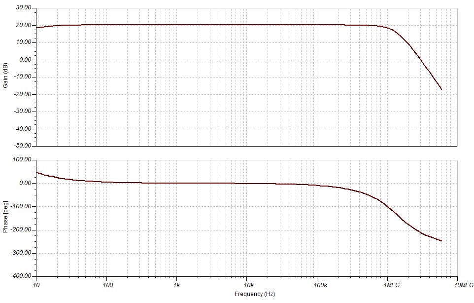

Simulation can only show so much. Problems with strays become apparent when something is actually built.With what, exactly?
It looks like there isn't much of a problem finding suitable output transistors with ft ~30Mhz aimed at audio amps. To achieve that things need to change compared with say the 2N3055 version that no on makes now. Various capacitances is one aspect that needs to change.
On the other TR that is a bit of a problem - a modern SOT packaged part could probably offer 100MHz and more gain
It looks like the gains are likely to be higher on all parts as well. That means more feedback factor and as he mentions likely less distortion.
Instability definitely does comes into it when the feedback loop is closed due to phase shift and maybe delays. Hopefully simulation can show that but parts vary, The faster output transistors should help with that. Strays - more and more of a problem as bandwidth goes up.
If it does need slugging the increased open loop gain can still have it's effects.
So far I haven't found anything worth replacing TR4 with other than the G version. I do think the later input filtering is a good idea to try and keep HF out of it. It might start receiving long wave. Shortwave too which needs less wire.
The Topology is incredible simple and inherently stable, otherwise in numerous examples C8 has been added to
Designs, and 18p to 27p is more than enough to stabilize amplifiers using output devices from 4 to 35 MHz
Using typical 24 volt laptop supply's around 3 to 5 amps and adding multiple modern high gain power devices you'll likely get almost
2 more volts output. Compared to the typical examples using older TO-3. Basically just use a low Ft T0-3 for the current source
to keep it stable. The amplifier works rather well. Same old " Magical" 2nd Harmonic and the usual .1% distortion @ 1kHz 10 - 12 watts
Using the original Bootstrap current source at cold start Idle current be around 1amp and as the devices reach 40c or higher temp
climbs to 1.3 amps which is about what is needed for full clean power.
obviously you should add power supply decoupling and if using a switch mode laptop supply. Switch mode likely
wouldn't tolerate much more the 450uf to 1000 uf max
He uses the same power transistor on the supply. That means 3 available and more chance of selecting more closely matched gain transistors for the amp. The heatsinking is needed so that could be done at the required current, Same if a stereo amp is built. If some one wants to actually build a regulator for it the same transistor could still be used,
Given his reported frequency ranges I wonder if some small caps need adding to decoupling and the AC feedback electrolytic. Especially that one. Bootstrap too I wonder but think so.
For the most part yes, its simplified and power supply decoupling would use the usual large/small capacitors.
And another basic RC network to decouple the gain stages better.
Real life Caps are close to Power transistors.
The low frequency phase reversal of a bootstrap is more than evident and normal for a bootstrap.
small value caps wont do much for a bootstrap. Dont like phase behavior or bootstrap, couple 100 examples
on the net were people get rid of the bootstrap and use feedback CCS. Distortion be the same old .1%
does nothing.
Far as phase margin for high frequency stability , Not sure why people get so confused when using high Ft transistors
when it is no different than any other amp. C8 would be well up to 47 or 100p. No differential input. Doesnt need to be very
high for this topology, but real life. Pretty much should end any ringing with a low value. Ive seen people claim it " ruins" the sound.
All based on wild speculation because anything not found in the original circuit gets added...oh no
Feedback loop at low frequency, no. Actually if you had a stubborn amp 47p to 100p across R1 would also work.
I could add a differential input lol, to hear people cry, the amp would ring like crazy. unless you follow basics
does nothing.
