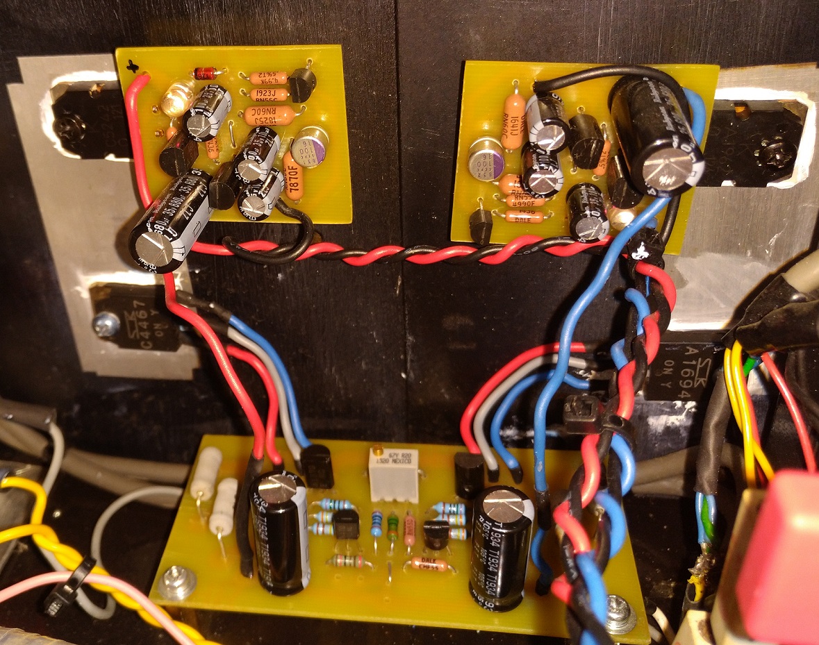

Just to remind you of my regulators for JLH69, current up to 4A, max. output voltage 25V, voltage drop min. 3V. https://www.diyaudio.com/forums/solid-state/3075-jlh-10-watt-class-amplifier-580.html#post6050539
I am currently testing La Monstre and with the same regulators it sounds wonderful, a few hundredths behind my version of the JLH69, it deserves the highest rating, the differences are in literally the details.
I think there should be no compromise around the regulator and the power supply in general if we want to get a good sound, every effort will surely pay off. I don’t have a lot of theoretical knowledge, but I’ve been doing amps since I was 14 and I’ve learned very well what good power supply in audio means.
