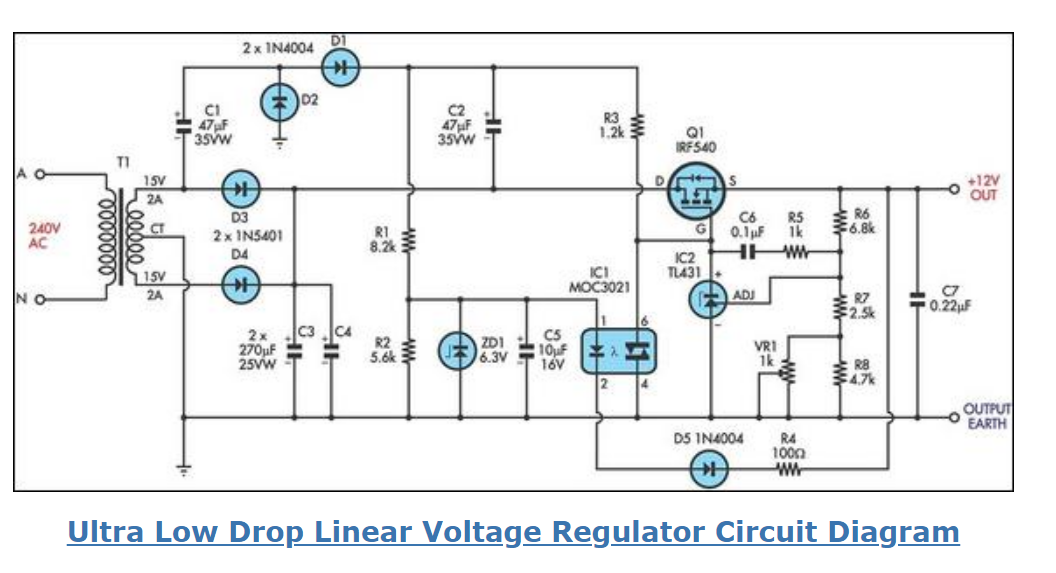

Still why not design uLDO? Less heat, less heatsink so less large.
LM317 also is a dinosaur surpassed by better LDO regulators. I recently helped a guy with JLH fed by 2 x SMPS. As expected no hum at all. My thought was to also try out an ideal rectifier based on LT4320 (had excellent results with that), CLC filter and a 24V capable LDO or a discrete LDO design with MOSFET.
I do use such designs on other low power amplifiers with very good results but those aren't so power hungry as class A designs.

If your uLDO regulates positive DC output voltage only, there are simpler ways to achieve the same result. Without needing a voltage doubler and without needing a center tapped transformer.

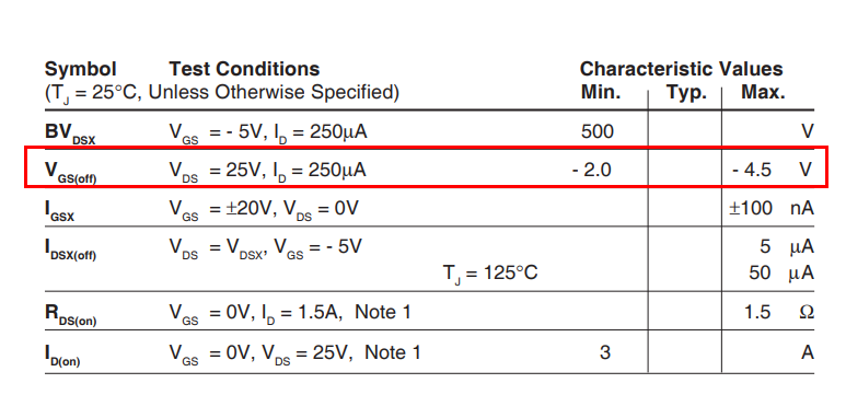

Depletion mode N-channel power MOSFETs accomplish the same function while operating with Vgs < 0V. No above-the-rail voltage doubler needed. These MOSFETs are available with current ratings far exceeding the LM317.

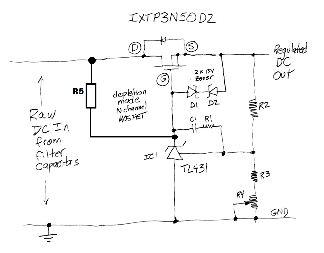

I received a Private Message asking me to please elaborate upon these remarks, and to please design an example circuit which illustrates them.
Figure 1 below is the "uLDO" schematic linked in post #6513 of this thread.
Figure 2 is an alternative implementation using a depletion mode MOSFET. I've added gate oxide protection diodes D1 and D2, which is conservative, standard practice a/k/a "good hygiene." As long as the regulated output voltage exceeds the transistor's threshold voltage {denoted Vgs_off in the IXYS datasheet} plus another 2.5V for the TL431, the circuit works a treat. So, in this case, as long as we require the voltage regulator to produce an output greater than or equal to +7.0 volts, all is well.
_
Thinking it might be best to involve the entire diyAudio membership, I'm putting the schematic here on the Forum, so that all can participate and learn. Anyone is free to offer a comment or a critique or a suggestion. Or to ask a question.Depletion mode N-channel power MOSFETs accomplish the same function {ultra low dropout regulation} while operating with Vgs < 0V. No above-the-rail voltage doubler needed. These MOSFETs are available with current ratings far exceeding the LM317.

Thanks for elaborating. The short circuit protection of the old circuit could be useful here I guess. Since most transformers have double secondary windings a dual mono PSU can be built by duplicating the circuit.
I will try the suggested circuit with IXTP6N50D2 (6A version of the depletion N channel MOSFET) when I am home again. The older circuit outperforms many 3 pin regulators.
