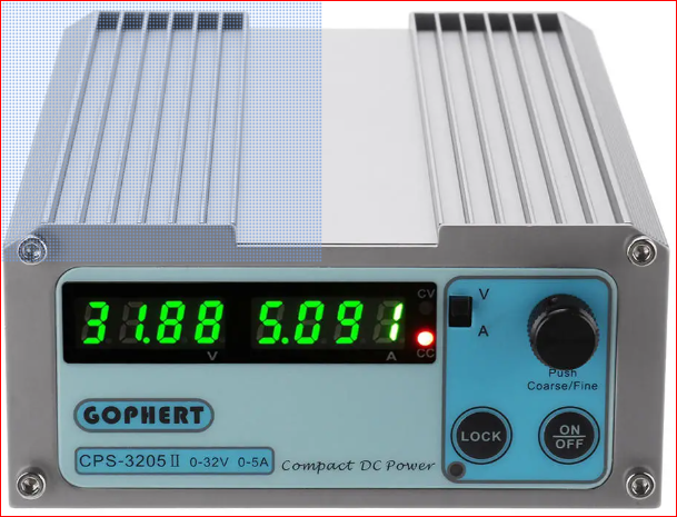

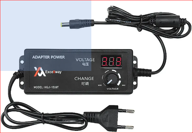

Thanks Nigel, I appreciate the extra effort you put in there to wring the last bit of noise out and write up the results. I expected the Meanwell SMPS to fare a little better, following your enthusiasm to to try it out for use with a JLH amp. Oh well, I think Ill stay with a linear supply in the hifi system for a while yet or at east until I see something better.
Currently, I'm using a 72W rated pair of the adjustable power bricks shown because they're safe to use where I have to listen to music at the moment, without too many precautions. Performance though, is mediocre but I'll measure with the scope when I have it set up again. The little bench supplies are very nice to set up and use, as they hold precise settings indefinitely but otherwise have a reasonable noise performance of <30mV @5A, about 8mV @1.5A with output set to 24V.

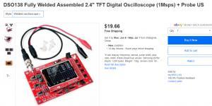

Now that complete, functional, "fully welded" (soldered) oscilloscopes can be purchased for USD 20, it begins to make economic sense to put a scope on the front panel (!) Have it continuously display the output of the power supply's capacitance multiplier {"ripple eater"} circuit. Then you could locate the power supply dropout adjustment potentiometer on the front panel, and encourage the equipment owner to jackk around with the pot in real time, while watching the oscilloscope trace.
_
They're not good resolution as far as mini-scopes go but for $20.... :cool:
If interested, take a look and listen to some comments on this version. It's apparently a forgery which might be why its so cheap but still works fine. YouTube
I don’t really care about the ripple and I will judge that with my ears but it might be handy to see when a low power amplifier is clipping
