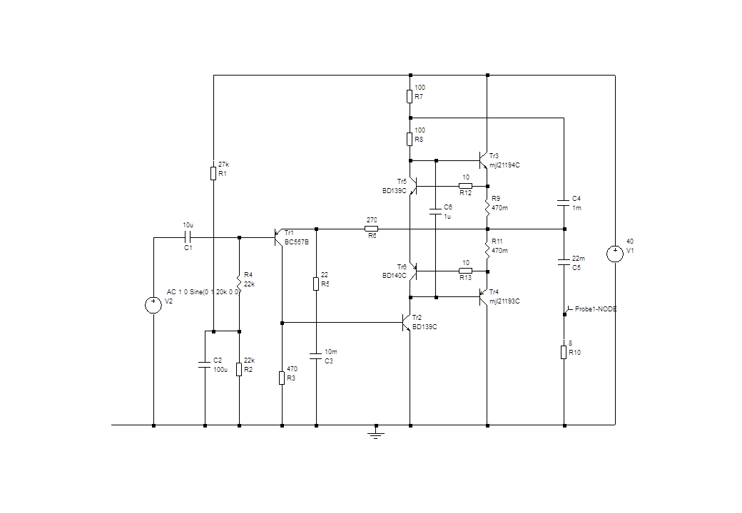

Hi all, i build jlh using this circuit. Power output use 2sc5200.power supply is +-16vdc.Problem is sound very slow? Which component need to change?

Do I understand your problem is that you are not getting much power output?
It may be worth checking the gain of your amplifier. Do you have a signal generator and AC voltmeter?
If you don't have a signal generator you could try using mains 50Hz from another (isolated, preferably double sectioned bobbin EI core type) and dividing the output voltage down to say 0.5V rms. Then measure this voltage and the output voltage from your amplifier with your meter. You should see a gain of about 12.

Now i use 1 single pair of power output. What voltage range i can test this circuit? And if use 2 pair power output what max voltage range? Thanks john

It won't matter too much whether you have one pair, or two pairs in parallel, as the output voltage is limited by the supply rails.
The gain of the amplifier is 13, nominally, and the output may be able to reach 12V before clipping but as mjona has pointed out the supply rail voltages are a bit low for this circuit.
Using 0.5V rms input you should therefore see an output voltage of 6.5V rms. Unless you have a means of checking for clipping (oscilloscope of some description) I would not try testing with higher input voltages as you may not know what the output is doing. A clipped sinewave becomes more like a square wave and that increases the effective output voltage, which an ordinary meter won't know it is clipped.
If you have a digital meter with distortion analyser you could check if the distortion increases though, but AC mains derived voltages may not be very low distortion anyway.
A better check might even be to make a very simple phase shift oscillator with a diode-limited gain clamp. It won't be low distortion but would give you an idea of how the amplifier is performing.

1.change supply from 12v to 20v to 25v to 30v:nothing change
2.change r8 to 220ohm and supply 30v:nothing change
3.increase bias slowly:nothing change

I change c3 to 1000uf also same..
Like gain no work.
Check that the bottom end of C3 connects to your earth. If it doesn't the gain of the amplifier rather than 13 will be 1.
Also make sure the resistor values in your feedback divider network are 2.7k and 120R.
I have seen resistors where the value defining colours are hard to distinguish - like between red and orange in the multiplier bands.
I have had instances where I have had to resort to measuring the resistance to make sure I had picked the correct value.
