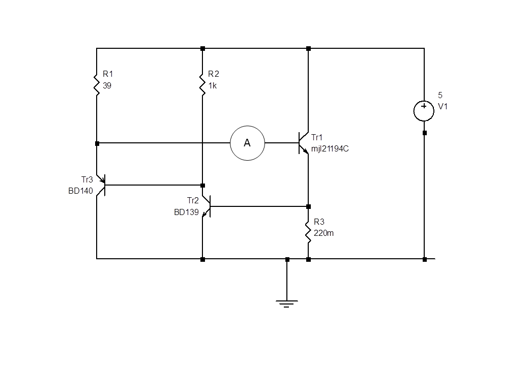

Perhaps the answer is to measure the gain of your output devices and select a resistor based on that. Here is a circuit which runs from a 5V power supply (old computer one perhaps) and sets the current to approx. 3A (adjustable with the emitter resistor).
Purpose of the additional PNP transistor is to allow the NPN to run at a more constant current without too much effect on the output transistor current.
Not shown, but an ammeter should be wired in series with the base of the OPT.
Not tested- just a proposal.
If I understand correctly , this circuit is to check actual hfe of output transistors. So my questions are where to measure, and what resistor value to be changed according to the readings.

manel - here is the test circuit with the ammeter added. The current should be set to 100mA if you don't have an autoranging meter.
This determines the base current needed for the transistor to pass 3A (this current can be checked by measuring the voltage across the emitter resistor).
The base current is therefore needed in the circuit to drive the upper output transistor at full current. That is set by R1 and R2 (plus any other series resistor like R12 in Prasi's diagram).
You need to add a small margin so that the driver transistor does not cut off completely.
That would be something like 10-15% extra, but any increase has a direct impact in output dissipation, and standing current, of course.
In Prasi's circuit if the base current of the MJL21194 is 50mA, say, then adding 10% means 55mA in the resistors. The supply voltage is 24V so the voltage across the resistors is half this, less a Vbe of the upper output transistor, or about 11.4V.
That makes the resistances needed total 11.4/55mA=207 ohms. These can be split 50:50 but reducing R1 generally helps. In Prasi's circuit R1 is 47 ohms, and R2+R12 is the remainer at 160 ohms, though probably the 10 ohm is not really necessary - but the output stage current will increase a little if omitted.
