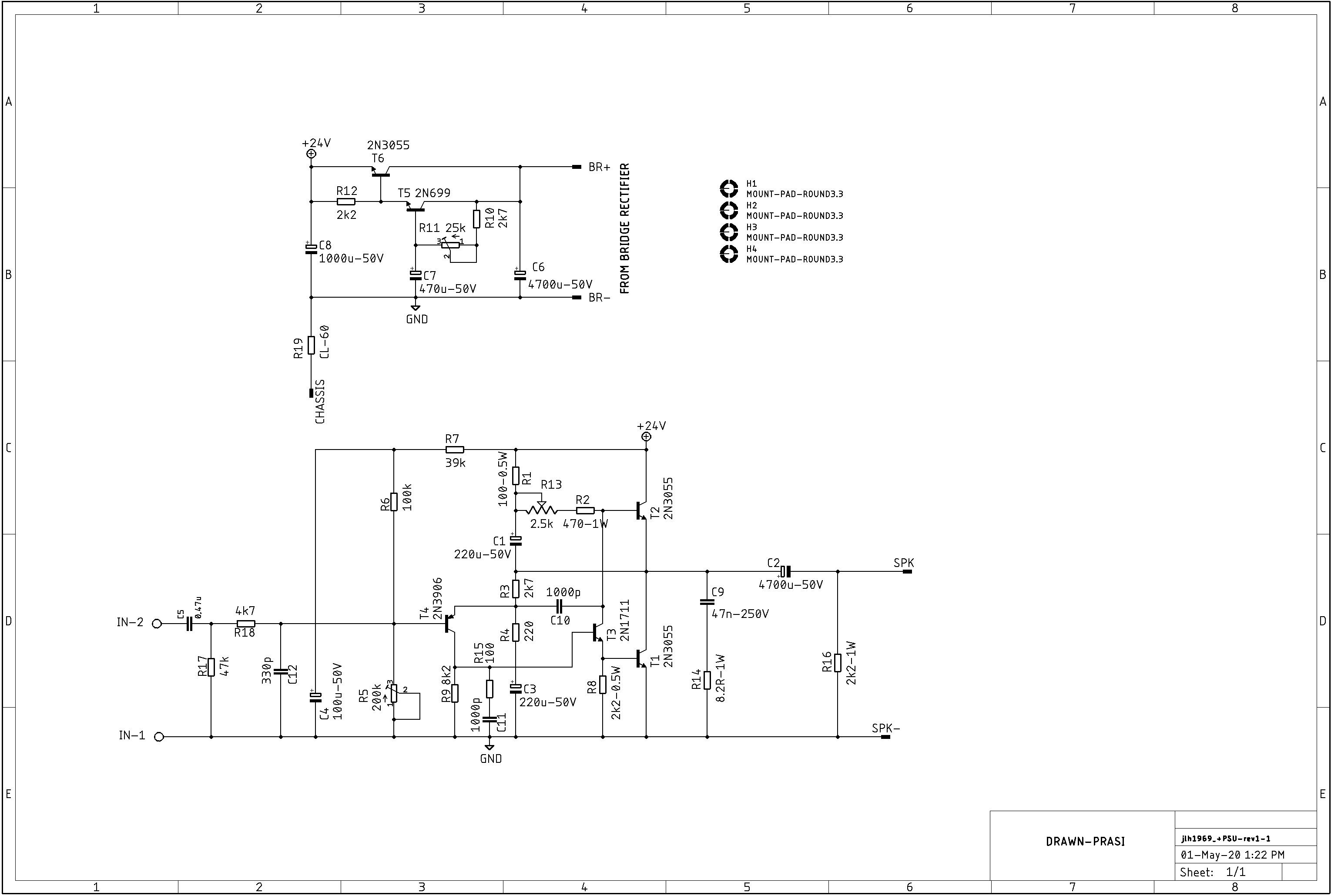

I think R16 has ended up on the wrong side of the output cap? It should be on the speaker side of the cap to allow charging/discharging of the output cap if there is no speaker connected.
Yes, corrected.

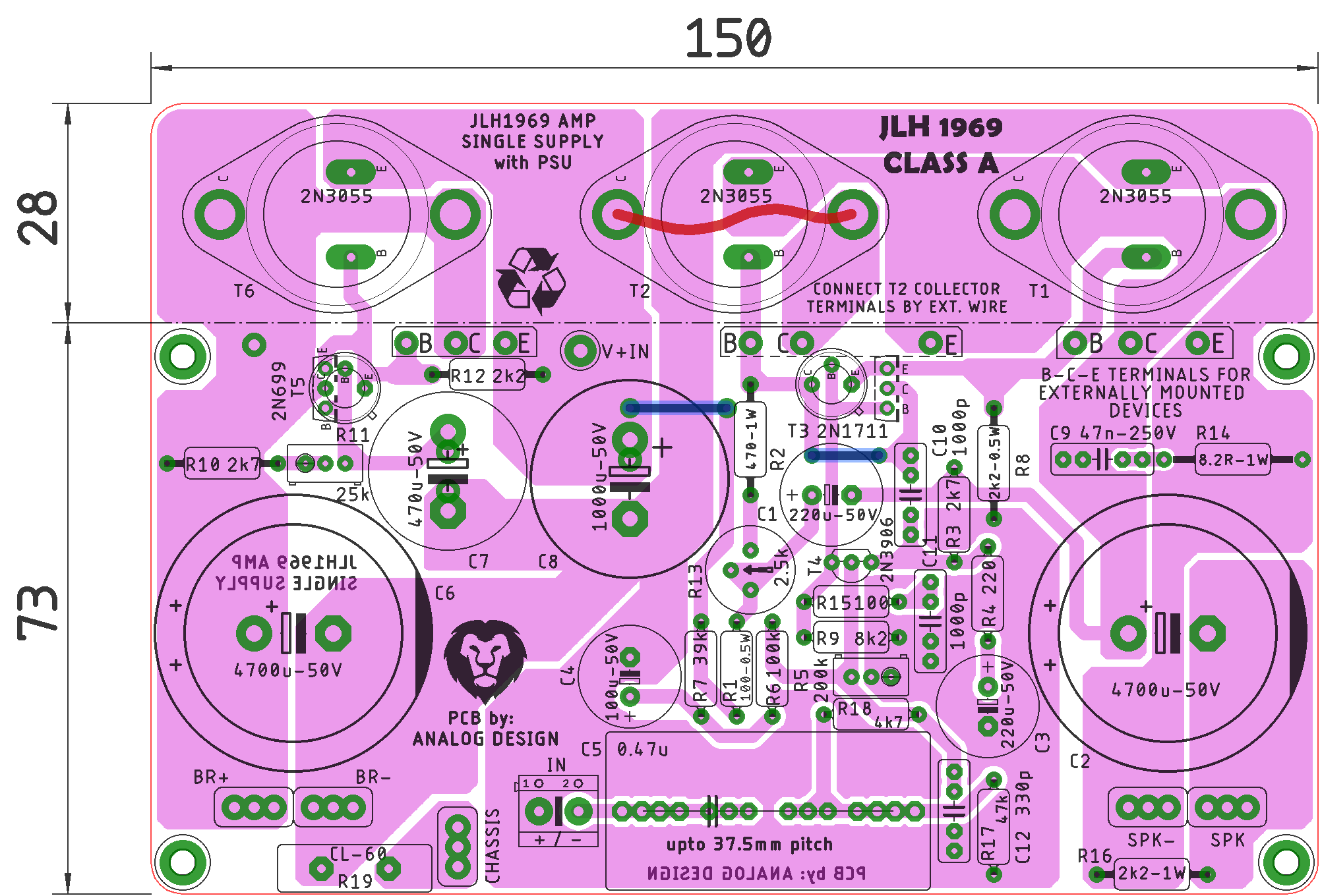

Also, I think we are done here..
1. added option to use to-126 devices
2. added cl-60 for chassis disconnect
3. B-C-E pads for externally mounted devices.
4. pad for V+IN if someone wants to use external PSU.
5. Added special logo for "JLH 1969" , if any one has better, share the high resolution image file. I will convert it to logo and add it.
6. Recycle logo & My logo 😀
If there are no more comments, I will post files😛😛
regards
prasi
Hello Prasi
Sorry this is a bit late, but I'm wondering about the physical dissipation in the preset pot R13. It needs to be able to handle the highest current possible, which may mean using a larger one than a 10mm(is that right?) pot.
The max. current a pot can handle is sqrt(power/R) and this should be at least equal to the max. current when set to a low or near zero value to avoid overheating the track.
If I am not mistaken (I haven't read all of the latest posts in detail) it is for a 4 ohm load, and at 24V psu the peak current out is in the region of 3A, which needs a possible base current of up to 150mA (worst case). I wonder if the resistors R1 and R2 would have to be lower?
It seems that there are not so many low gain transistors around these days but 2N3055's also suffer from quasi-saturation, meaning the gains could well be low at low voltages, unfortunately compounding the problem for 24V operation.

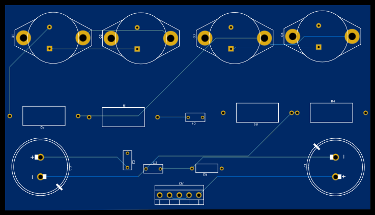

the jlh thread is busy, very good.
i am making a dedicated output board for jlh 2003, rails connect directly to pcb, i added 2 100nf snubbers and 2 6800uf caps, it also has the output filter, and off course the feedback.
it still needs alot of polishing, comments ideas are welcome

Hello John,
I dont know, if i am doing anything wrong, but pot dissipation appears to be quite low. The pot i have there is a bourns 3345p wirewound single turn 1W.
I did a sim too, could someone have a look and tell me if its correct?
interestingly, i had to lower both R1/R2 to get the bias up even for 8 ohms. and for 4 ohms, they have to be nearly halved.
As per the JLH documentation "post script" , the 2N3055 can be used provided TR3 is 2N1711. ofcourse there are MJ1500X AND MJ2119X or as per the new layout, people can even try with TO-264 type packages.

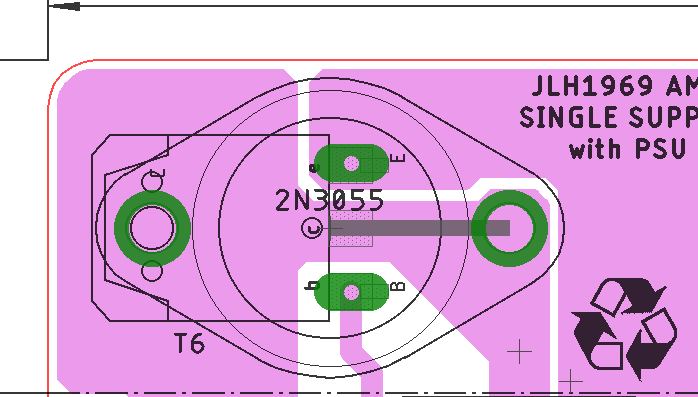

A thought: If you adjust the spacing of the BCE-pads, the PCB could cut and used with modern devices mounted directly without leads?
1. Done!..😀:wiz:
A side note: Even TO-3P devices can be mounted directly in the same pads as TO-3 and the second collector hole can be used for mounting bolt, provided , you bend the legs very close to the body. But many builders wouldnt bend it that close.
Hi prasi, just a small point - in your post #6378 of the 30th April you mention you changed the pot R13 to a Bourns type 3345. The schematic shows this with a value of 2.5K. The datasheet for this pot type does not have that value (either 2K or 5K is shown).
Looking forward to your BOM, and otehr doc's, thanks.
Gary..
Hi again prasi,
Looking at this pot, I can find them at Mouser - but they are listed at $20.88 USD each!! Ouch.
Do you have any other subs - does it need to be wirewound and 1 watt rated?
Could the Bourns 3362P which is cermet and 0.5W rated be OK?

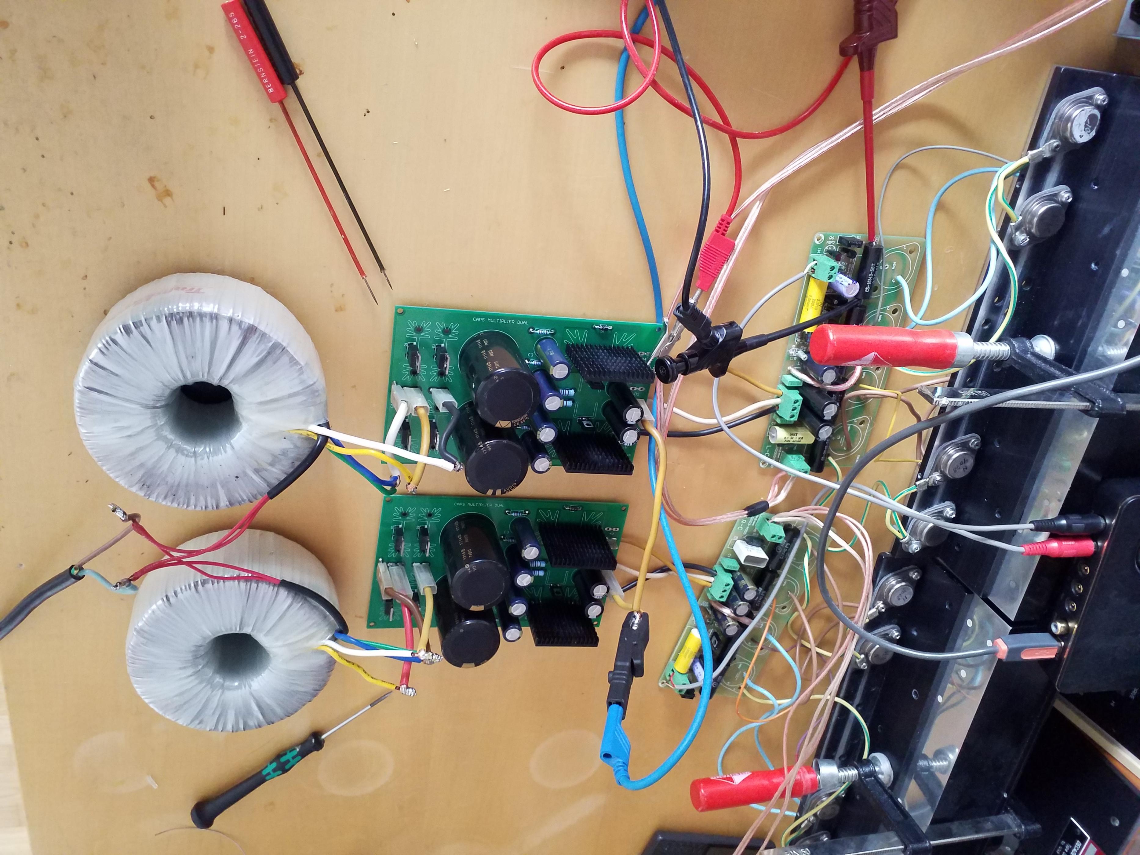

This is the final, I've tried different parts, capacitors and transistors, this setup sounds the best, I've also added some heavy duty capacitance multiplier, with mjl1302a mjl3281a, the amp is dead silent, at 24 volt 1 amp bias ripple is less than 2 mv rms.
I'm gonna discard the Pcb, and make my own, but only as driver boards, output and filter go separate, with rail directly to collectors.
So now it's tedious chassis time.
