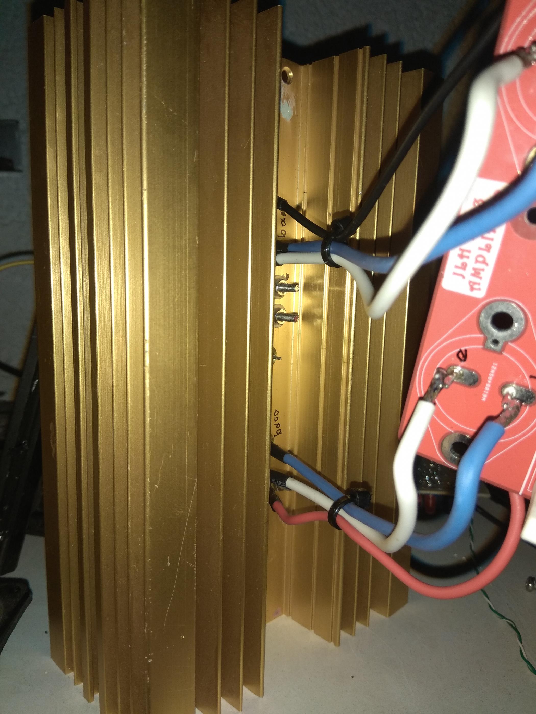

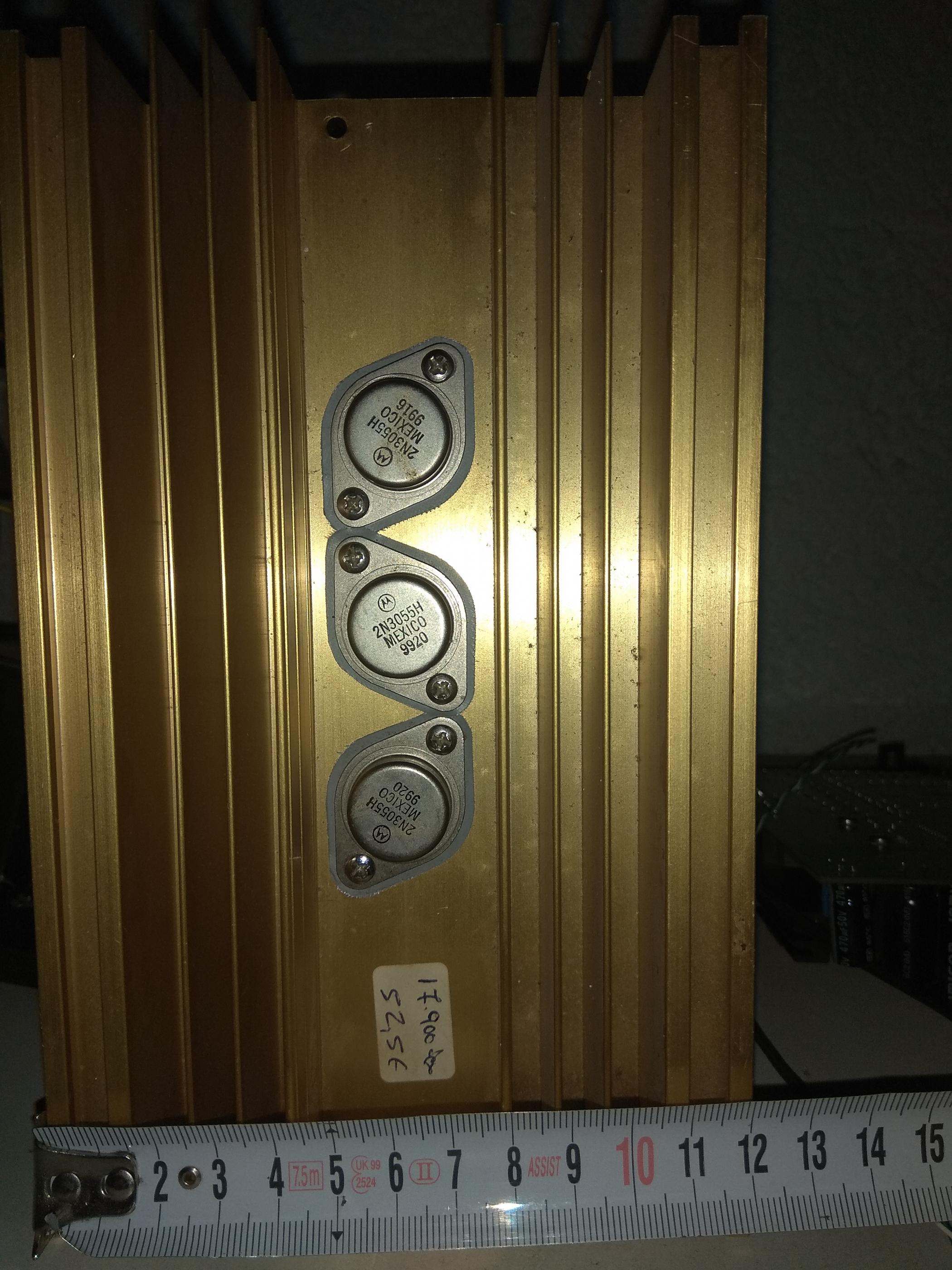

What kind of C/W value should I be looking at then?.
And thank you!
Temperature now in Greece is about 23°C.
Mine jlh using this heatsink jump to 48°C after 10 minutes when the transistors body is 55°C.
What is the room temperature?
Denmark - Currently we have 22 degrees inside - can get hot in the summer, but that can be dealt with when that happens..
That's not too far off the 20x10x4 cm one I asked about. And I assume that 55 degree body temperature is acceptable?.Temperature now in Greece is about 23°C.
You also have a regulator on yours which I assume is there for a reason.
No l haven't a regulator, just one more transistor that isn't connected.Denmark - Currently we have 22 degrees inside - can get hot in the summer, but that can be dealt with when that happens..
Transistor's case temperature isn't semiconductor's temperature!
Clever ( :
And very well aware of that.

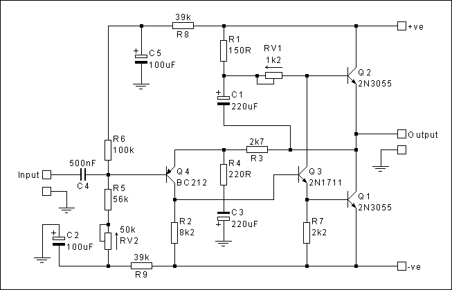

Hi Nigel
This 2.2k resistor is the one on the base-emitter junction of the lower output transistor?
You raise interesting questions on the JLH design and this is another. I have indeed considered this resistor, but after a "walk around the park" it is best left alone.
One of the problems discussed in this thread and elsewhere is that the speed of the output transistors limits the practical frequency response of the amplifier. A typical modern 2N3055 from ON semi has a gain cut-off frequency of about 50-60 kHz. That may or may not be a problem depending on the signal source material i.e. your preamp etc. To increase the speed of a transistor, more base current has to be supplied if it has to work beyond its fhfe, which means taking current out of the base (to turn it off) as much as putting current into it. I recall in Doug Self's WW article, he complained about the old 2N3055's drawing more current in a Class AB amp. at 30kHz - those old ones had an fhfe of only 10kHz. (What he did not say is that this could be addressed using 10 ohm base resistors instead of 100 ohms, but that would have meant increasing the driver current and dissipation etc).
So the point is that to increase the speed without a negative bias supply in the JLH, this base resistor should be lower. But there are consequences. A lower resistor shunts the base-emitter junction and reduces the open loop gain which is already rather low (about 600). But it will speed up the design.
As a rule of thumb the base resistor needs to take as much current out of the base as goes in if the overall current is not to increase at high frequencies. In a Class AB amp, a complementary driver arrangement can do that but not in the JLH,
If this resistor is reduced, the driver current has to increase. But that will lead to a thermal problem.
As the base-emitter junction voltage reduces with increasing temperature, a lower impedance source will allow more base current to flow into the transistor and so make the thermal stability worse - probably a lot worse. One of the points about the JLH is that by feeding essentially the output transistors with current, rather than voltage, the current gain change with temperature is less and the thermal stability higher than might have been expected without using emitter resistors etc.
So the rade-off which JLH made is to keep the resistor high, which does virtually nothing for improving speed, but keeps the low frequency open loop gain high and respectable, if not ideal, thermal stability.
To summarise, yes, the circuit would benefit from a lower resistor but that would create other problems.
Thanks John. My thoughts went in a similar direction. As some may have noticed I have been a bit unconvinced by some of the " better " tansistors and thought gain would be the factor more than vast hf. Doug Self calls some Super Beta types. From his graphs these not only do high gain into low resistance they are also higher gain. For our needs most transistors give their best gain wise when below 2 amps.
Empirically, imho you can get this resistor down to cca 1K2. Best values will possibly be in 1K5 - 1K8 range (plastic TIP3055/MJE2055). But note that I wasn't ever interested in 27V (or more) classic version, but a scaled down 15-18V version (for precision nearfield listening). This means lower value resistors in bootstrap section, and there may be a this scenarion-only connection!
