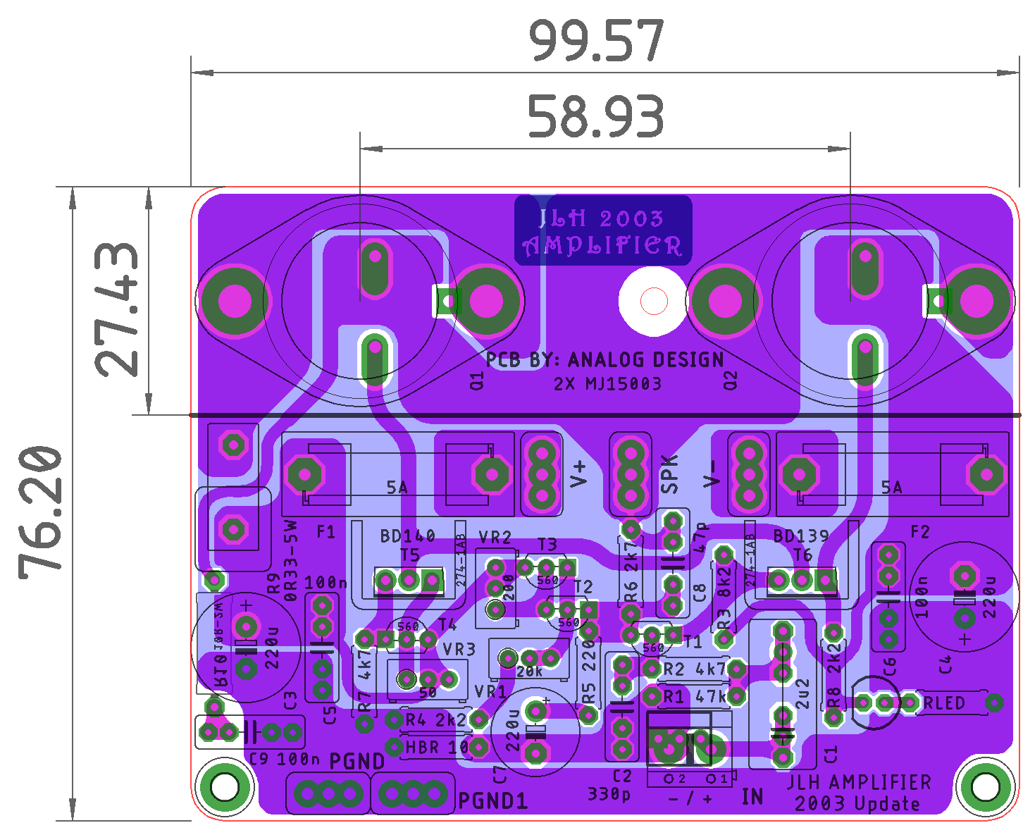

Pcb designed by Prasi.

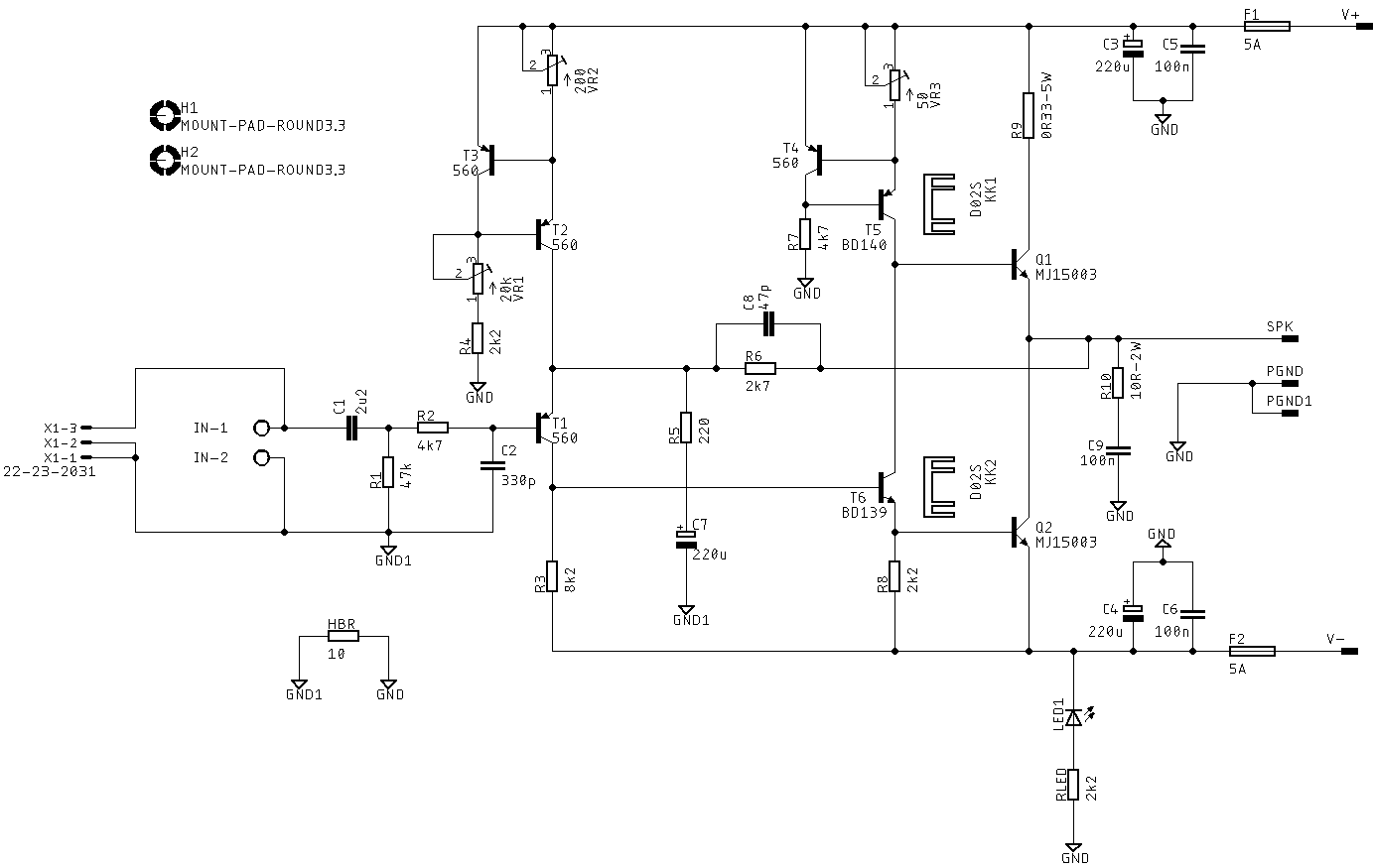

Prasi, please can you post schematic diagram that match this pcb?
+15v/0/-15v
I think you need a secondair with a midpoint
Yes that is what i mean
+15v/0/-15v.
As I read it, you have
V+ / spk / V-
Pretty sure V+ and V- goes directly into the fuses next to them (left and right respectively) and the common speaker rail to the SPK pin in the middle - with a common ground at the front of the board.
So I think it's correct (if I am at least) ( :

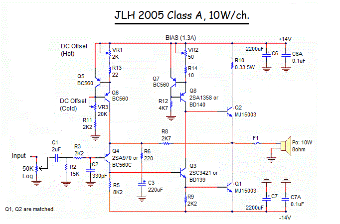

http://www.keith-snook.info/wireles...ss-World-1969/Simple Class A Amplifier - .pdf
I was looking for loop gain which is a very low 600 or 55 dB. Of this 34 dB is used as feedback resulting in 0.16 ohms output impedance or damping factor of 51 at 8 ohms ( excellent really ). Distortion is 0.05% of which most is second harmonic. This implies about 2.5% open loop, I have been told it's higher.
What JLH never says is why the amplifier is so simple. There is every reason why he would strongly question his own wisdom here. It's always said transistors were more expensive then against wages. The hardware would then as now would be the bigger cost. I can only think like me JLH thought that every extra transistor colours the sound. JLH says the laboratory can not duplicate everything that happens. Like Oxford do I know 1/3 of how this really works?

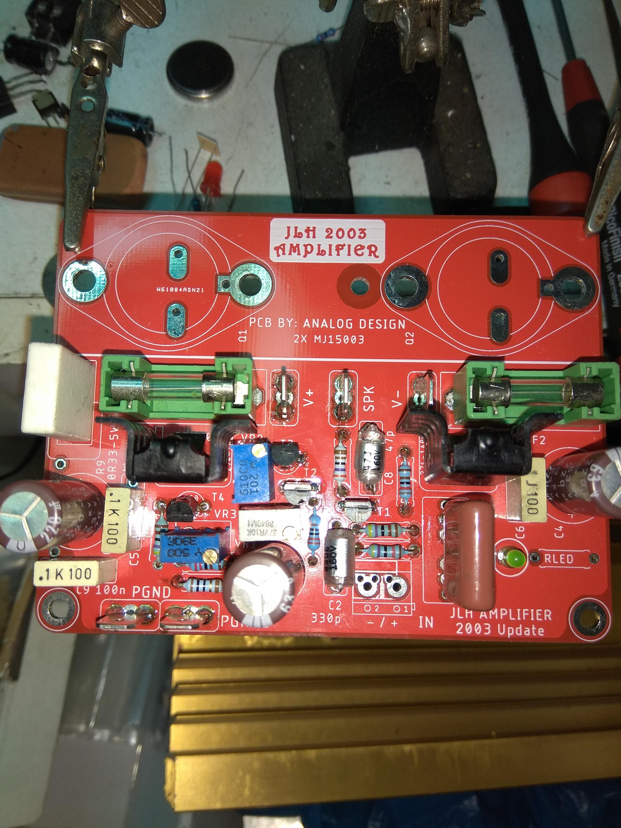

Some photos from first test after debugging.
Last photo the solder side after debugging still dirty but playing nice!
