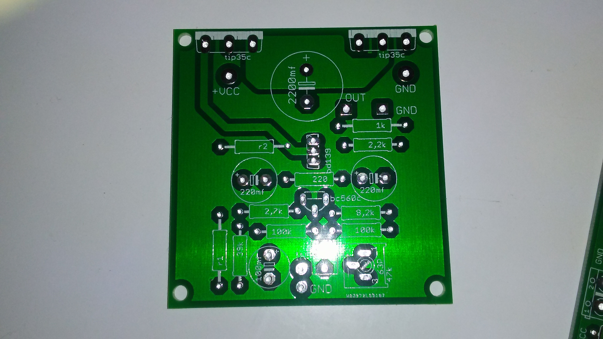

JLH 10 Watt class A amplifier
I would think about +/-20 v max for 8 ohm. what are your rails?
My first test done using +/-15v.
Later tested using +/-18v.
The first test with two stabilized bench power supplies.
Then with existing +/-18v non stabilized power supply.
Now i have ready the second chanel.
This time using ksc3503, TTC5200, and an empty, C8.
Lets wait what scope will say:yikes:

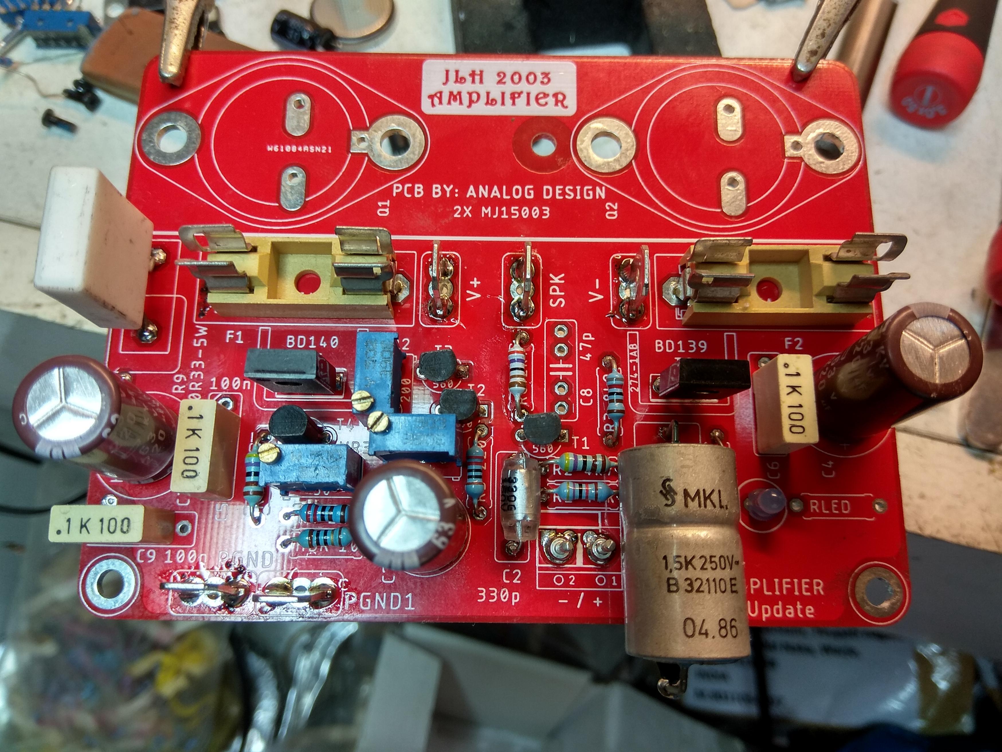

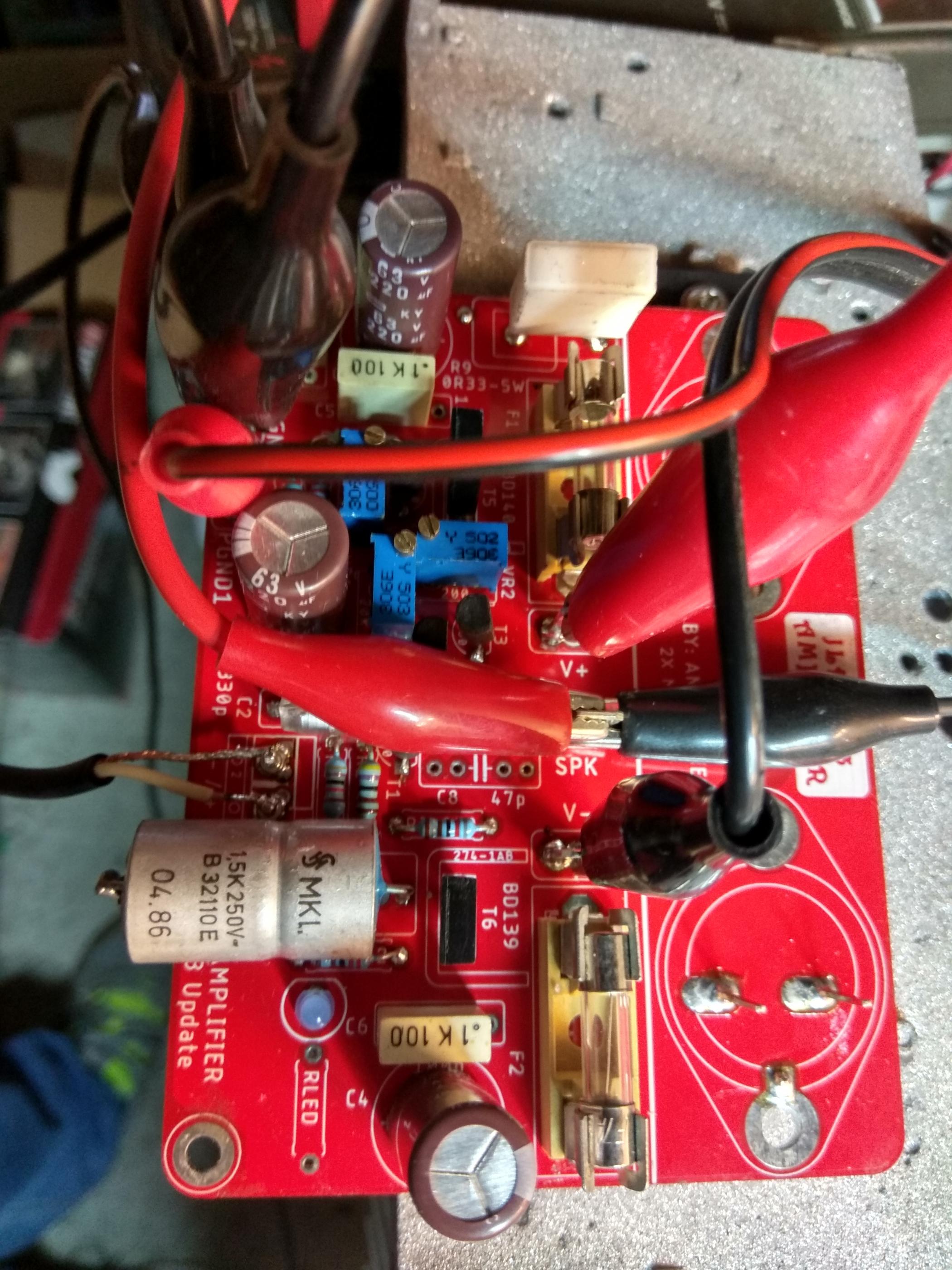

Do you recognize this capacitor?
I don't know about this,just salvaged from a scrap from telephony company.😕
yes ,i know this capacitors,I have a good big bag at home.
from what I have seen, they have a "sound" not at all neutral.
I use it only for decoupling out of the way
of the signal.
on the other hand, they are of a formidable precision, all those I tested were perfectly in the original values

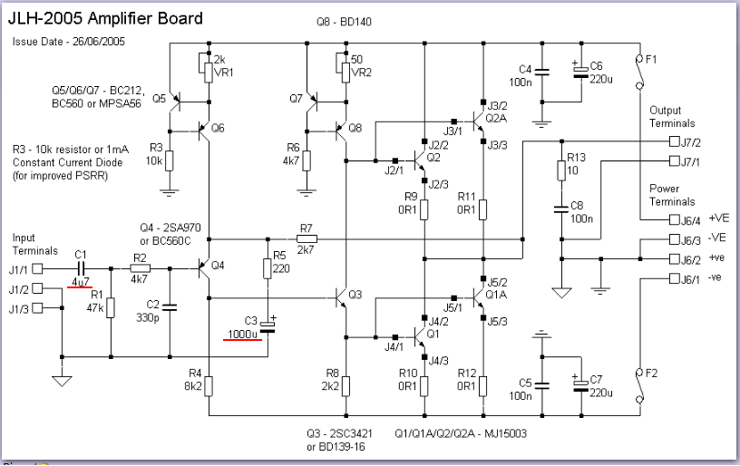

Hello Thimios ,
yes, the schematic is as per The Class-A Amplifier Site - JLH Class-A Update
figure 2.
My sch and layout is attached here.
regards
Prasi
Prasi
Do you know what is the V ratings of the C3 capacitor?
I just ordered parts to the high power JLH and I ordered 16V type, I hope that will be enough.
Because I use 1000uF I was a bit worry if I buy a bigger capacitor will not feet the PC boards.
I can still change my order until tomorrow in case you think the 16V rating will be not enough.
Prasi
Hello Gabor,
Yes, 16V would be enough.
regards
Prasi
