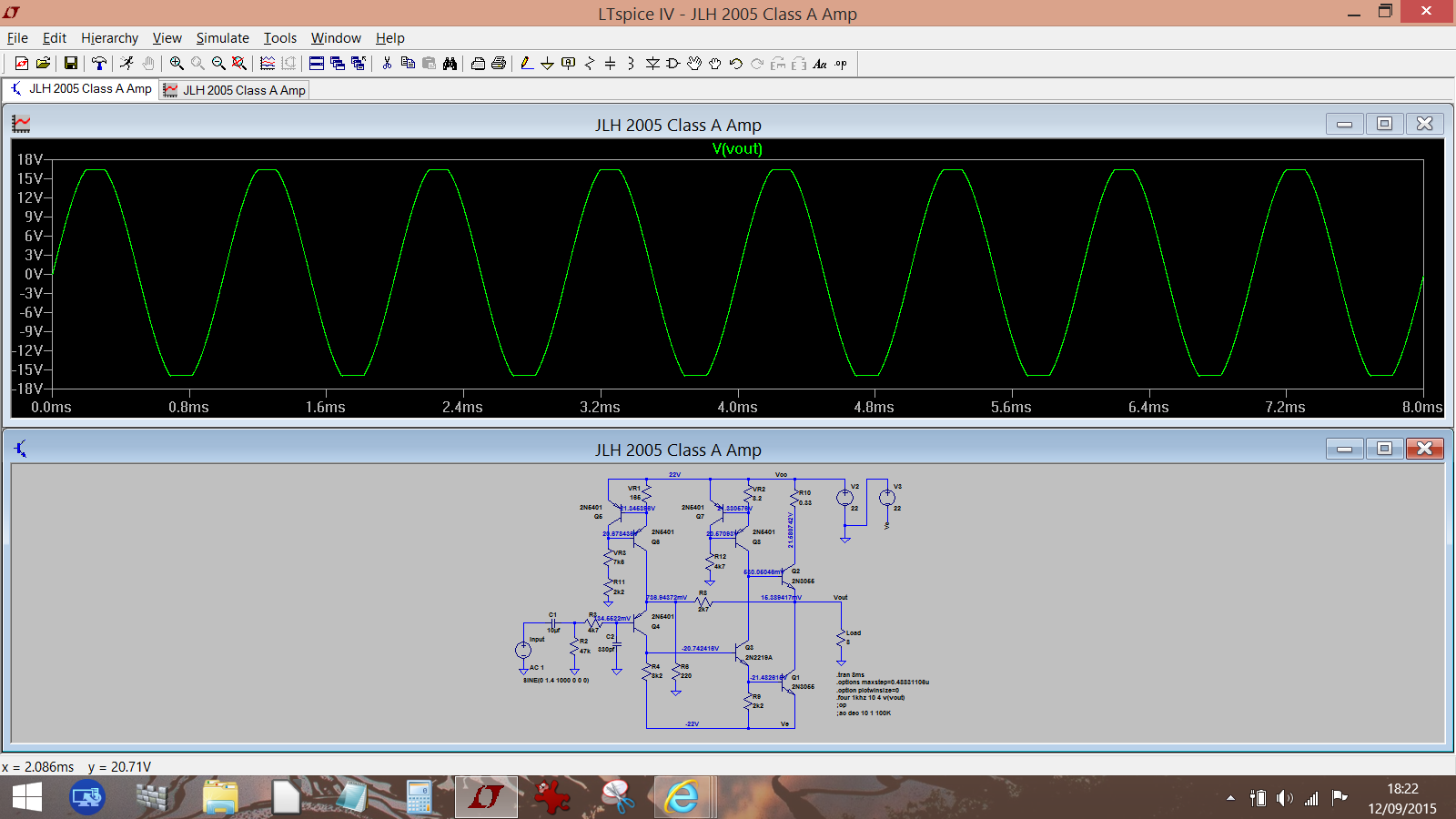

My original simulation file for this amp had such a cap in place... I can't remember how I came to have created the file tbh, but it must be related to an earlier post in this thread. It does work without though although the DC stability will be, erm, interesting.
Those pots VR1 and VR2 need some modification to make the circuit less likely to self destruct when bumped and what is VR3 meant to achieve?
Maybe some attempt at temperature compensation... hard to say really because at face value it does little.
Here is the file if anyone wants a play.

Inserting a capacitor of about 100uF to 470 uF in series with R6, removing VR3 as davidsrsb suggests and replacing R11 with about 10K as well as replacing VR2 with 47 ohm and adjusting VR1 to get as close as 0VDC at the OUT terminal, you are good for about 24 watt pure class A.

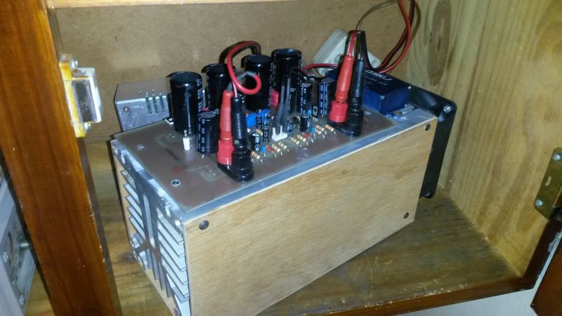

I built the amp on a breadboard, point-to-point. I have the output transistors mounted on a big heatsink...

Ok, your feedback is great!!! Thank you all for jumping in and sharing ideas.
After reading several of the comments above I went back and double checked everything I was doing and I wasn't doing everything right.
Below is a picture of how I have things grounded. I know you probably can't tell much other than I'm not very good at soldering. 😉 I have the ground lead coming from my power supply clipped to the big bare copper ground wire running the length of the board.
When I attach the negative probe of my DMM to the ground post on the power supply and check voltages I can measure -22v on the negative rail but only 0.4v on the positive rail.
When I disconnect the ground clip and measure across VE+ and VE- I get 22v.
Obviously I've done something wrong...
Sorry to say this but I see a disaster waiting to happen or rather happened. In my very humble and honest opinion, I would urge you to find a PCB on eBay for this amp and build it properly.
Based on what you've measured, I'd say you burned out Q2.
You've got way too much space between your components for a circuit with high stage gain that relies on negative feedback to establish operating points.
Find (or make) a PCB for this amplifier.

I agree... time to find a nice PC board to build this amp on.
Nico thanks for the link to the PC board. Does anyone else have any recommendations for any tried and true JLH96 two output transistor board?
