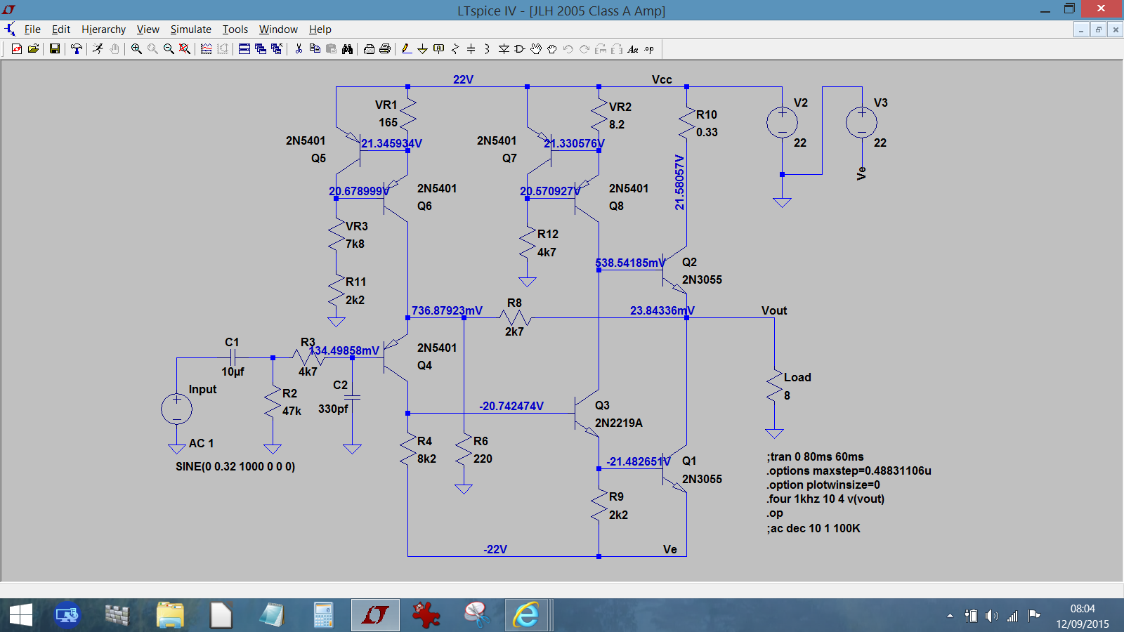

I'm checking R10 and I get the same voltage on both sides... time to replace?
Nope, same voltage on both sides suggests its OK. Check the transistors out of circuit. John makes a very valid point over the possibility of zapping transistors due to there being no limiting resistor in series with the pre-sets. If that has happened then the pre-set itself could be damaged too due to excess current flowing in the tiny moving wiper contact.

That just means There is no bias. R10 is likely OK.
R10 has no DC current thru it due to C3, therefore no voltage drop.

So I spent a lot of time checking voltages according to the chart you gave me. Unfortunately everything seems to be in order. Nothing obvious that jumps out at me.
One thing I find curious is I have an 8 ohm resistor across the output and I can measure ~330 mv on R8 (see circuit below) but I can't read any voltage across the output.

You shouldn't read any DC voltage across the load resistor at the output unless you have and offset, which you don't want. You should only read AC voltage across it if you are feeding a signal into the input. You are likely just fine.

The important things to check are,
1/ That VR1 and VR2 are intact. This applies particularly to VR2 where any dead spot or anything intermittent with the wiper would cause a large and destructive current to flow in the base emitter junction of Q7 and that would carry through to Q8.
You can only test these resistors with Q5 and Q7 removed. VR2 should never be turned so far that it effectively shorts out the B-E junction of Q7 because that would cause a large destructive current to flow in Q8. The same applies to VR1 because there is a low impedance path via Q6, Q4and then the B-E junctions Q3 and Q1 to the negative rail.
So never turn these pots down to the low resistance end of their range. If you replace them then set them midpoint to begin with.
Assuming these resistors are OK then you should measure around 0.65 volts across each.
Every one of the transistors should have this magic 0.65 volts or so across their B-E junctions. For the NPN devices the base will be the more positive. For the PNP's the emitter is the more positive.

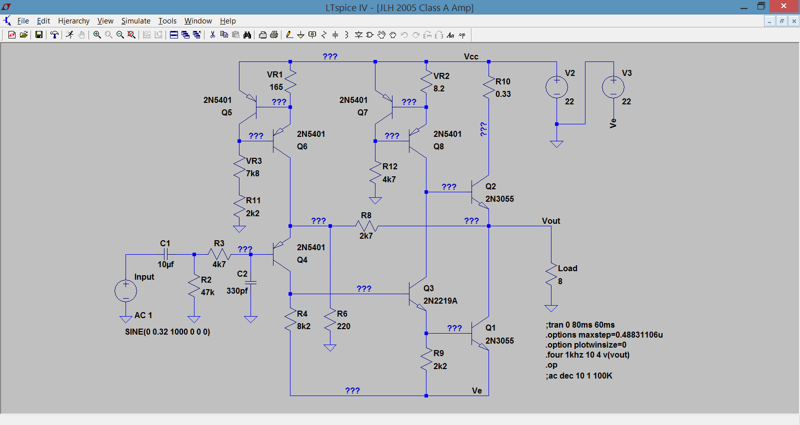

If you get stuck then copy the second image here and write your measured voltages onto the diagram and we'll see where the problem is. Readings to a couple of decimal places are fine.

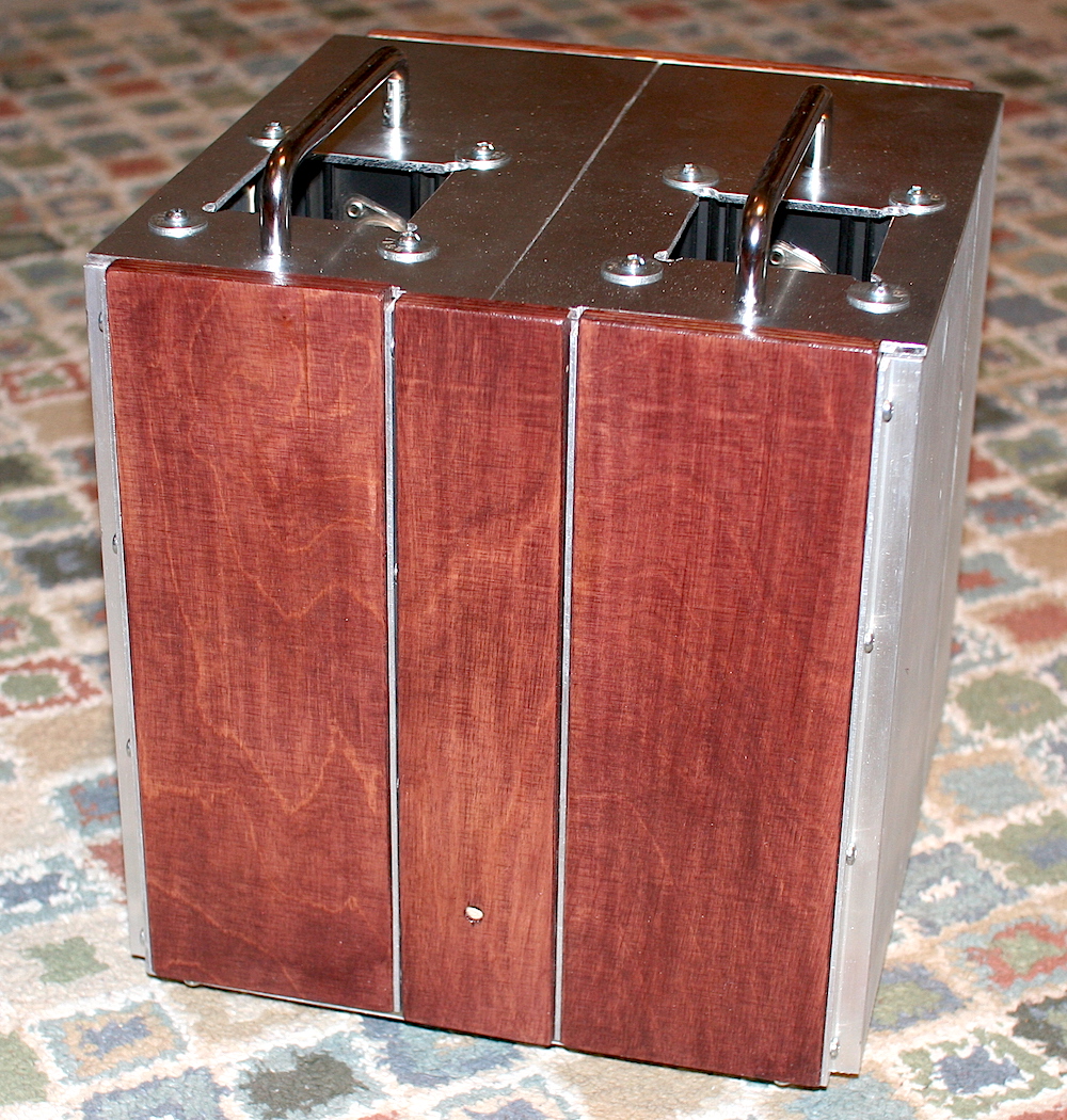

You might find the driver stages need to supply significantly more current to bias four output devices.
Why not simulate it and see how it behaves ?
My version has 4 pairs of 2N3055's per channel and the driver stage appears to have no issue at d.c. In fact, with so many output devices you can bias the amplifier so that it is at the peak Hfe of the output transistors (as recommended by Hiraga in his Le Monstre article) and for normal music you'll have no issues with beta-droop.
Of course at h.f. you have more base capacitance to drive but again I don't have any complaints. I did try using a CFP phase splitter to reduce the drive impedance but it did NOT sound as nice so I reverted back to a single device. It's still in use as my main amplifier, having edged out my 6AS7 SET amp for prime spot in the living room.
