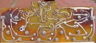

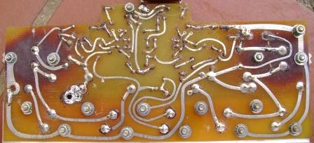

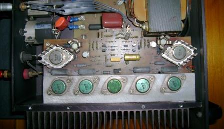

Here they are gents. Very roughly drawn on paper; I don't have software to do this neatly unfortunately. Notice the lack of regulation in the psu - very basic. When I rebuild the Bedini will add in regulator module to see (hear) the difference. This is going to take some time to get to but hopefully not more than a year. BTW I've had this amp for more than 25 years and only switched it off when we moved (3 times) and when minor repairs had to be done - replaced reservoir caps and feed-forward caps (47uF went soft to 25uF and gain climbed considerably in that channel; did both channels). The rebuild is going to be done into a new chassis (bigger) with separate transformer per channel and better heatsinking.
