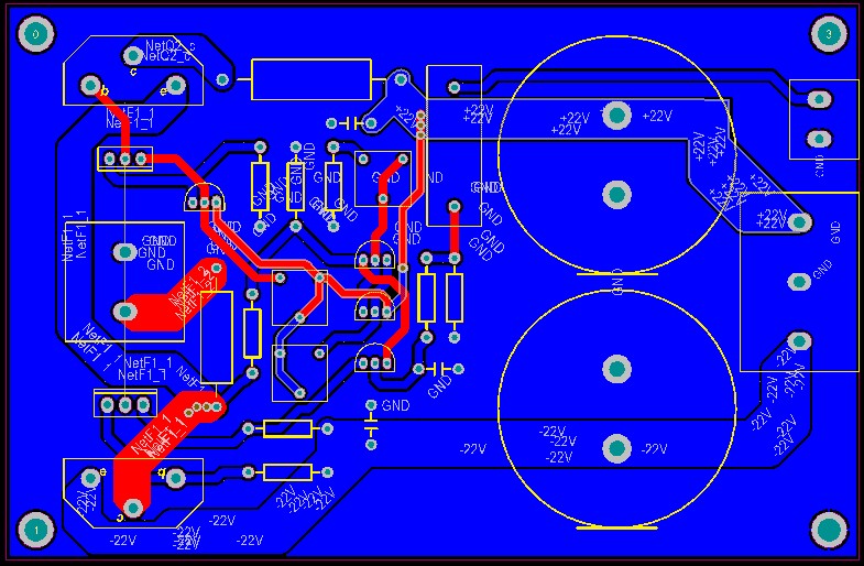

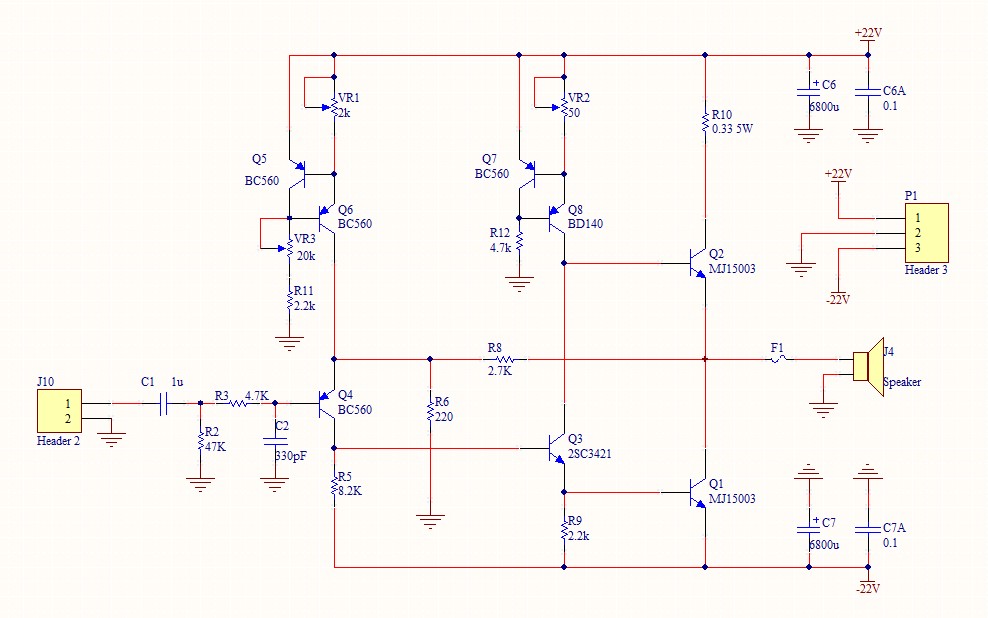

my jlh-2005
Repost it here by Johnathan's suggestion...
Just finish my first JLH-2005. The circuit is from this link:
The Class-A Amplifier Site - JLH Class-A Update
schematic and pcb attached.
A few thought about the design
1. The original 1969 design use 2N3055 as Q1 and Q2. Then changed to MJ15003. I'm thinking of some other subsititutes such as 2N3773, MJ21194 or 2SC5200
2. Can I use 2SA1358 as replacement of BD140? it's complementary of 2SC3421.
3. How to set the value of VR1, VR2 and VR3? in other words, what current should those 3 current sources be?
4. Is the large polygon pour on PCB good for audio amplifier?

Sil,
I suggest you add a series resistor to each of the current setting Vr1 Vr2.
Try 100r for Vr1 and 10r for Vr2.
This allows you to check and set the target currents for these two stages.
Initially you set the Vr to maximum resistance. This passes minimum current through each stage and that way you don't blow up the amplifier at first power up.
Start with Vr3 set to maximum. This will leave Q5 becoming current starved as you increase IcQ4. The current through R11 must be >>IcQ4/100 and could rise as high as IcQ4/2

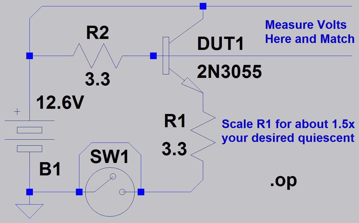

it's better to order pair matched parts. hfe doens't mean all. The curves should be matched.
As for power transistors: Beta droop at ~1.5x quiescent
current should be matched. If they don't match at lower
current, its no big deal, the global loop and offset CCS
can handle it. But if droops are wildy different, you are
screwed! At that point you might look to SRJLH if you
still determined to make use of mismatched devices...
The npn driver and pnp error detector are doing completely
different things. Not optimal that they should compliment.
PNP should be optimally sized for gain at only a few mA.
And the NPN driver sized for best gain at around 250mA.

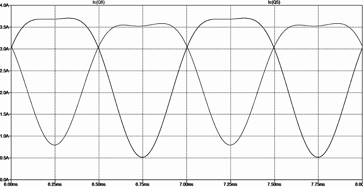

Here's a plot of currents showing some serious droop
The peak current is "supposed" to be 2x the quiescent
but we can see it never gets there!
Illustrating why matching of this flaw is important.
Its not hard to set up a quick test...
