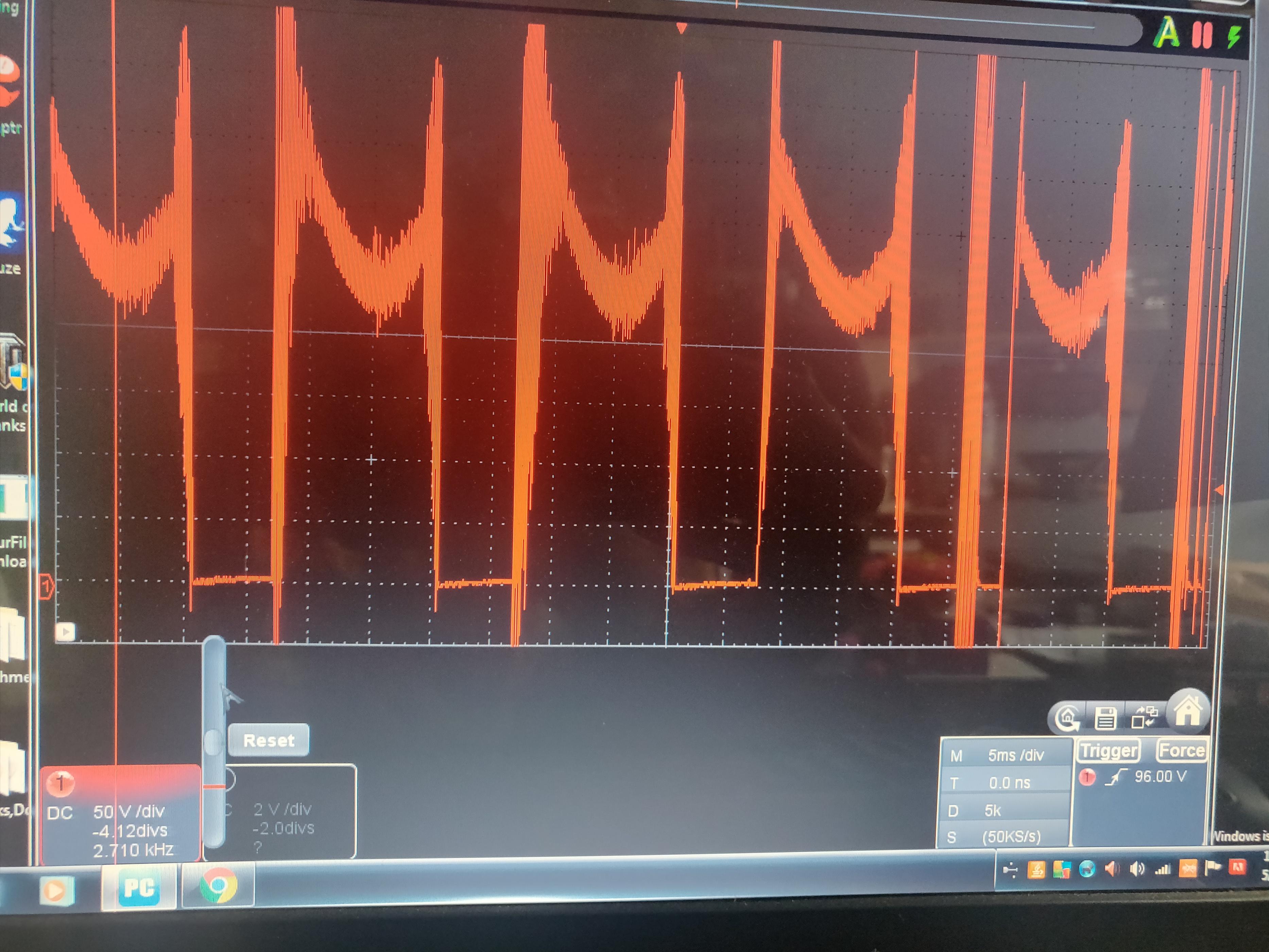

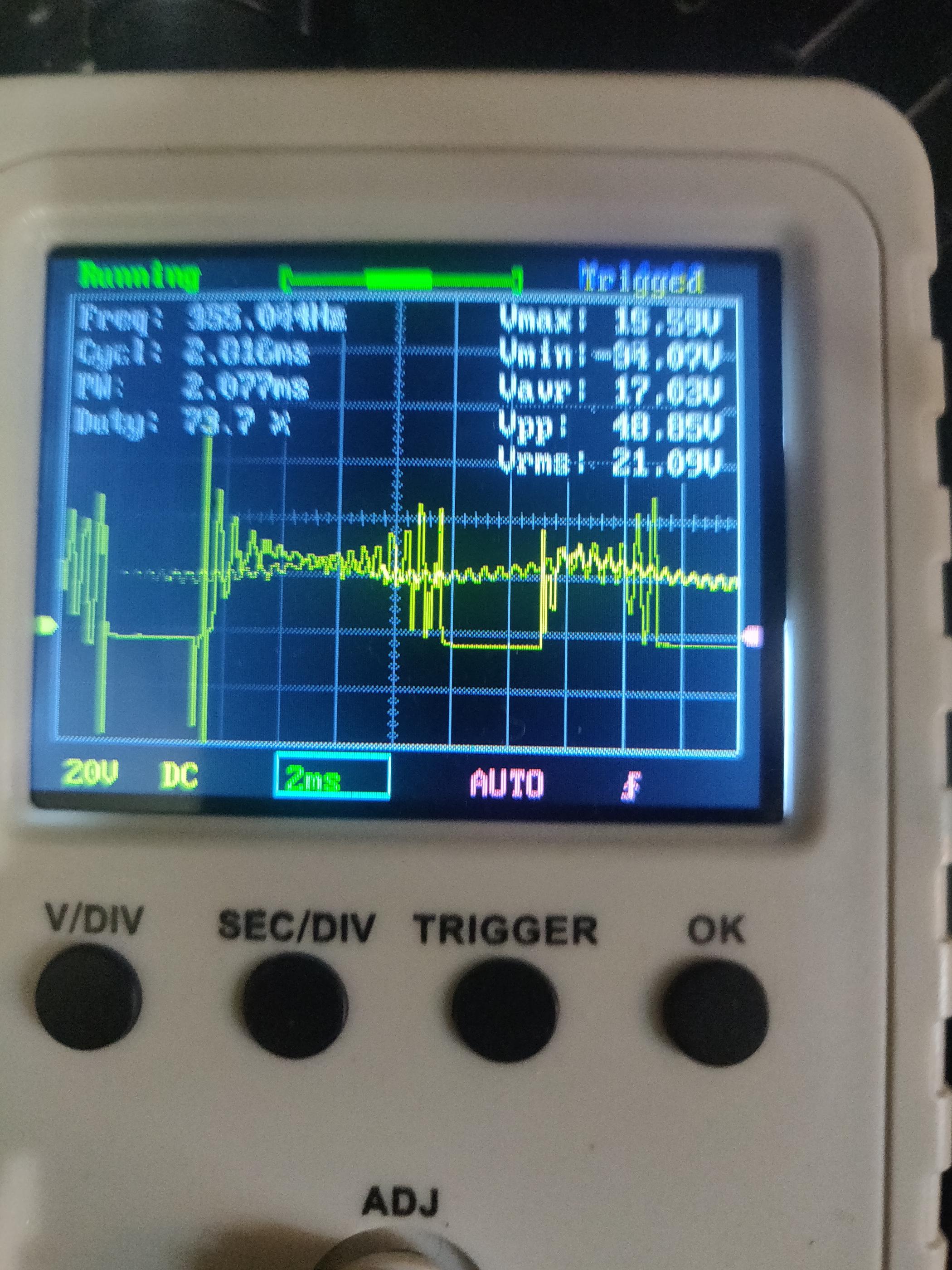

If you mean post #28, that was on the bench with a 50hz tone, with the 2SC3200 transistor, that shuts down the 3525, removed. At the point when the noise occurred, and the amp would have shut down, it remained on and the noise just repeated itself.
With pin12-3 jumper in place, the amp has no output.
Tracked down the noise to the 2 vertical wrapped inductors. You had mentioned those previously. Do you suspect those of being bad. I have had to rewrap inductors in a JL 500/5 before, but those were visually overheated. The inductors in this amp have no overheating evidence and appear generally in good condition. I do not have anything that can measure inductance.
There is no rail to rail oscillation and no output when the pin12-pin3 jumper is in place. As soon as the jumper is removed, the amp works normal, except for the underlying cutting off issue.
I can also confirm, as you already suspected, the outputs have nothing to do with the issue. I swapped in the 8 IRF3710Z and tested. The amp made the noise at almost the same input voltage as the original outputs.
What can I try next? Would lifting pin12 off the pad be something to try?
Yes. The audio is interrupted and dragged low.
