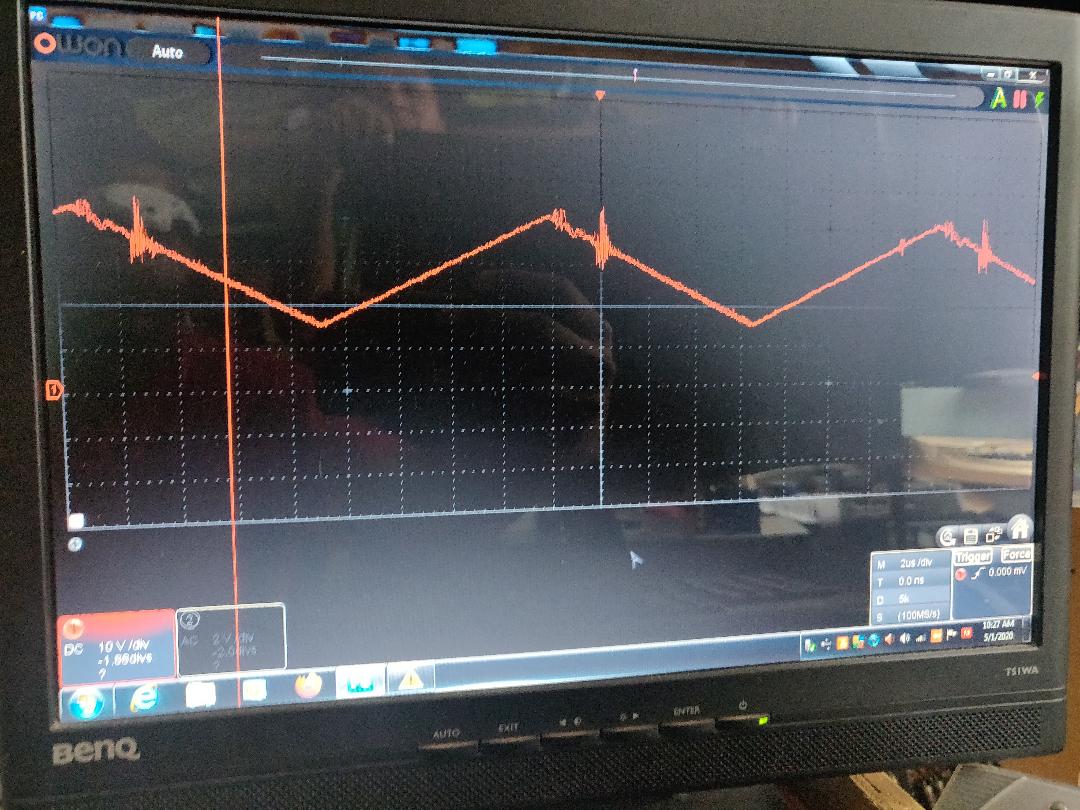

How were you testing when you posted the waveform of relatively low amplitude with the gaps in it?
If you mean post #28, that was on the bench with a 50hz tone, with the 2SC3200 transistor, that shuts down the 3525, removed. At the point when the noise occurred, and the amp would have shut down, it remained on and the noise just repeated itself.
