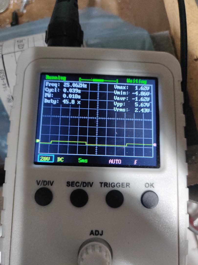

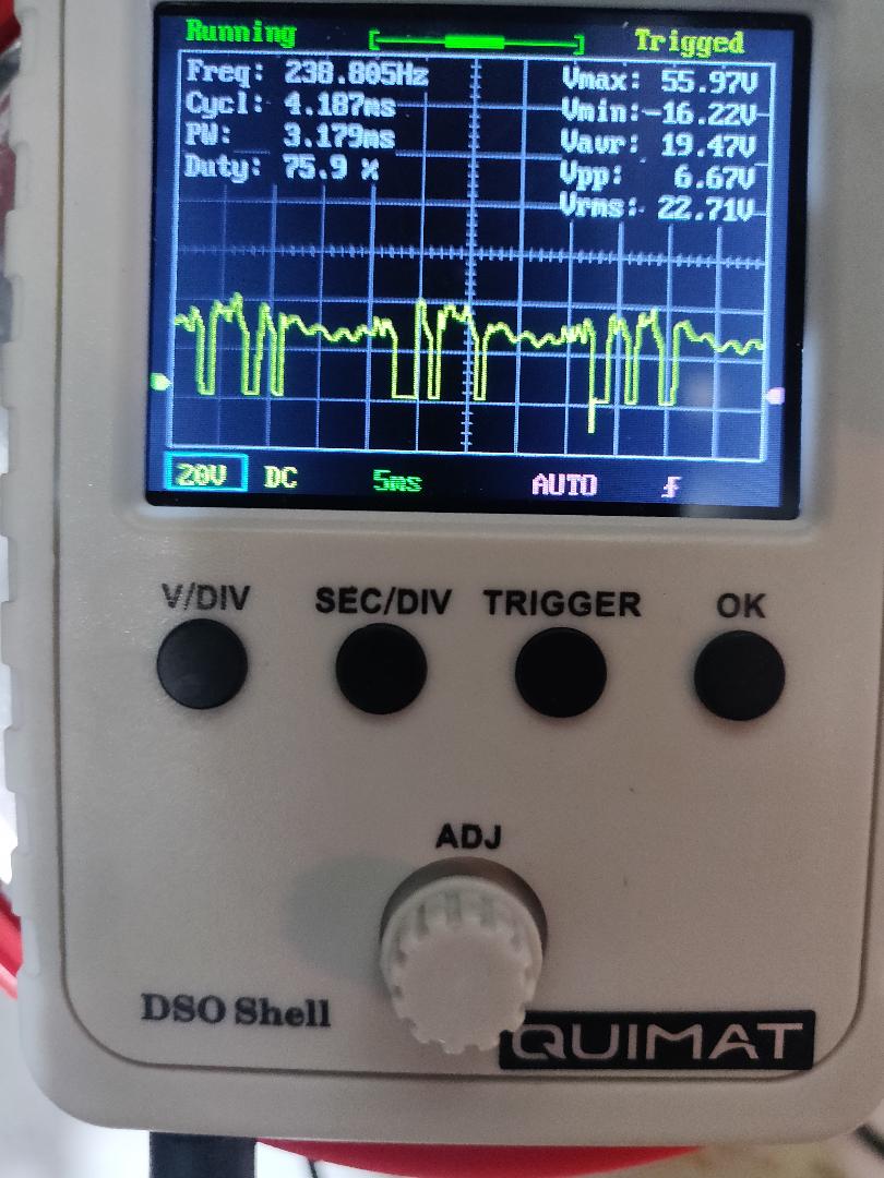

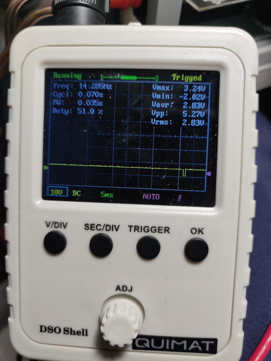

So whatever is happening is causing the transformer(or some other component on the board} to buzz as it occurs. I removed the 2SC3200 transistor responsible for shutting down the amp so I can capture what is happening on a scopeshot. I did the same thing in the vehicle and all that was heard in the subwoofer was a scratching/scraping type sound every time a heavy bass note hit, but the bass continued playing the lighter notes uninterrupted.

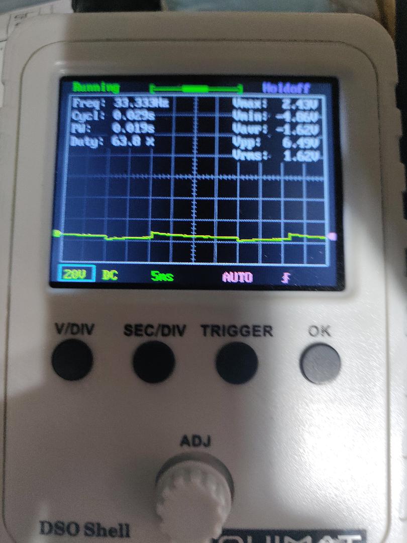

These scopeshots are inside on the bench with a 50hz test tone, with the protection transistor removed, with a 2ohm dummy load connected. The sine wave is clean right up to the point when the amp starts buzzing and the noise shows up on the scope. Maybe seeing what is occurring may help with offering a possible cause. This occurs way before there is any clipping of the output signal.

The noise does correspond to the activity seen on the LM319.
shot1 is pin4 when the noise occurs
shot2 is pin12 just before the noise starts
shot3 is pin12 when the noise occurs
what could be causing the trigger on pin4? do i need to trace pin4 back to its source?

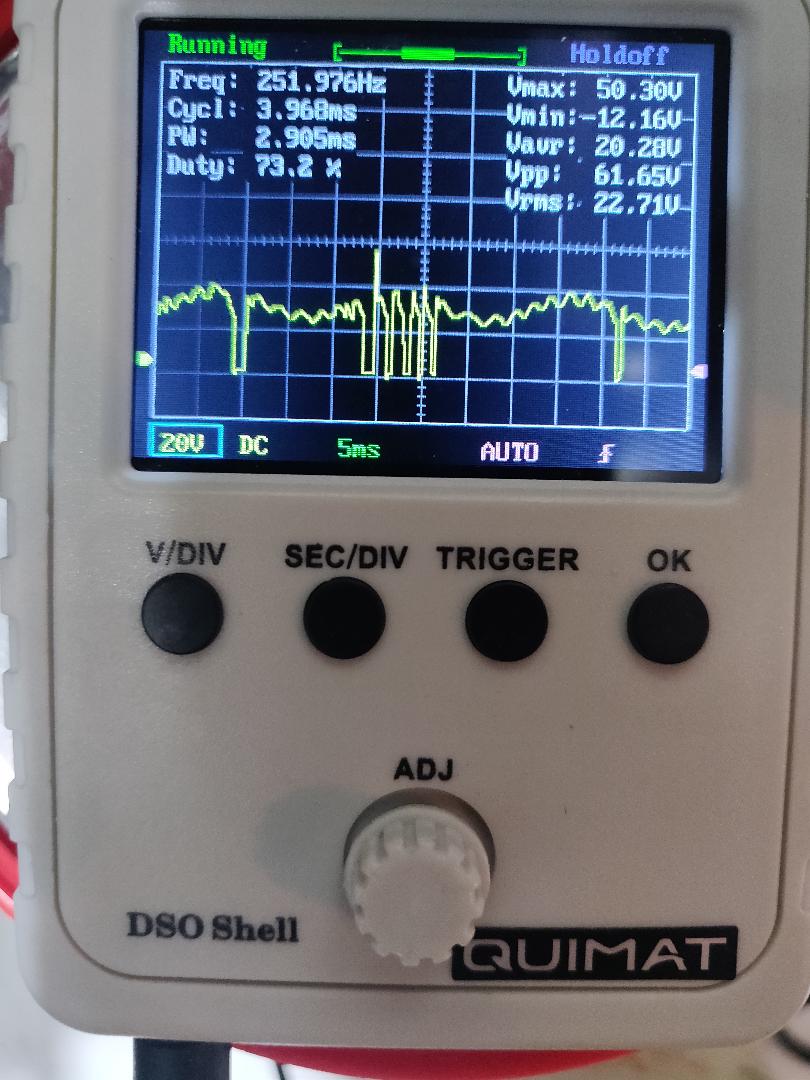

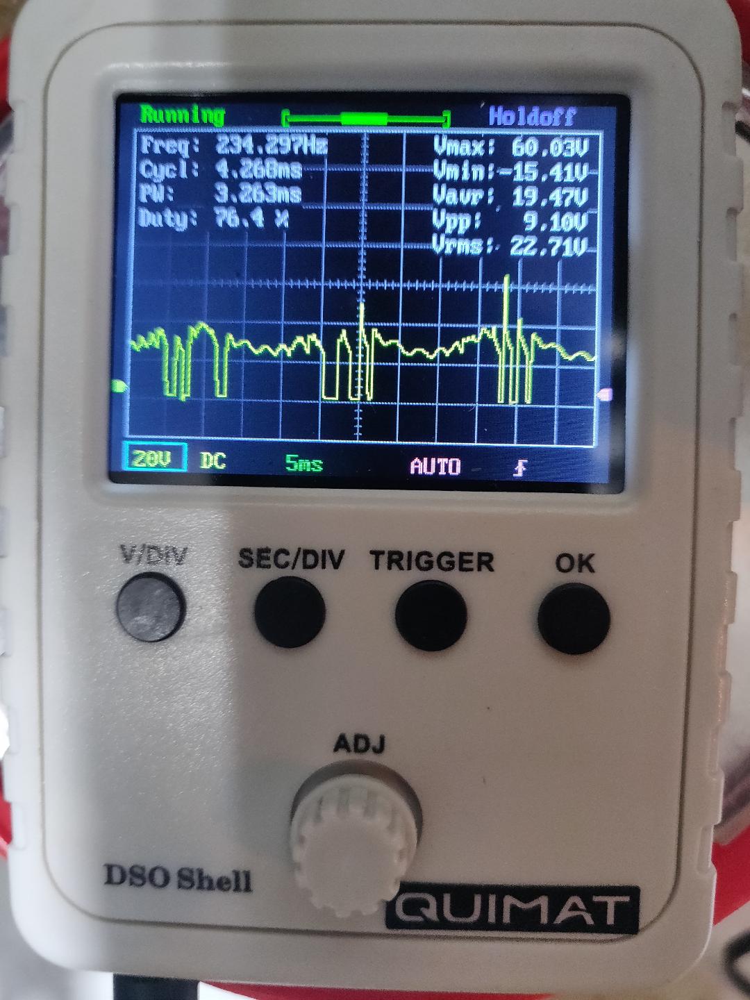

tested the LM319m on the driver board. it prematurely triggers the noise when the scope touches the pins, but turn the gain knob a bit more and the amp makes the noise.
pic1 is pin4 when the noise is audible
pic2 is pin12 when the noise is audible

Both inputs are being used on this IC. I will post the voltage readings on all the pins. I am still figuring out ICs but how come pin12 has 5v on it when the +/-inputs are both less than 1v? Or is that 5v originating from somewhere else? Is that 5v the low voltage supply? So when pin12 of this LM319 has an output, it is interfering with the 5v power supply to the various ICs which triggers the protection, and also causes the buzzing, like a feedback? Just trying to figure out what I don't understand...
