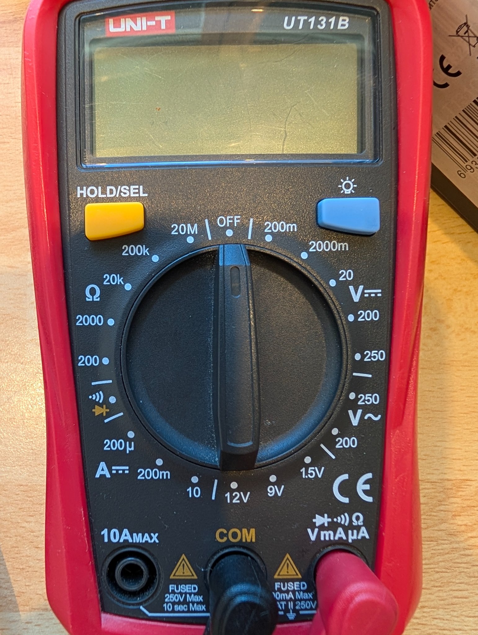

If you switch your meter to ACV, what readings to you get on pins 4, 5 and 12 of the 319?

Unfortunately i don't have a scope. What spares do you have on your mind?
Pin 4: 0VAC
Pin 5 0VAC
Pin 12: 0VAC
Pin 4: 0VAC
Pin 5 0VAC
Pin 12: 0VAC

Was the amp powered up and building ~±15v on pins 4 and 8 of the op-amp when you measured all zeros on ACV on the 319?
If you have a different meter, try it.
Meters have a 'bandwidth' like a speaker or amplifier. Outside of that bandwidth, they're unreliable. The frequency at the points you were measuring for ACV were likely near 80kHz. A typical meter will start to lose accuracy above 400Hz. Reading all zeros is unexpected and why I asked about the DCV on pins 4 and 8.
Try both of them across the gate and source pads for the PS FETs. Do they both read 0v there as well?
Better? Why wouldn't you default to the better meter?
They both show 0V (one probe on B-, second on gate/soure) and also show 5.9V if measured between gate/source on ps fets.
Why didn't i default to a better meter? Just remembered that i brought one from work that was jus lying around.
