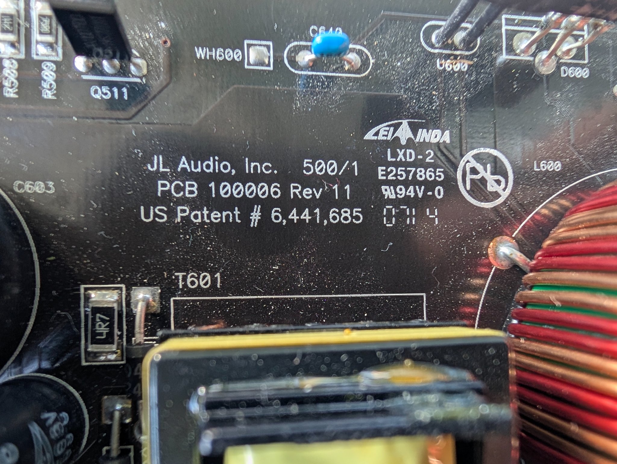

JL Audio 500/1 V2 repair question
A couple of general notes.

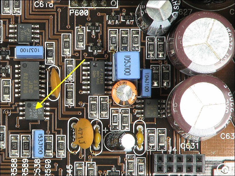

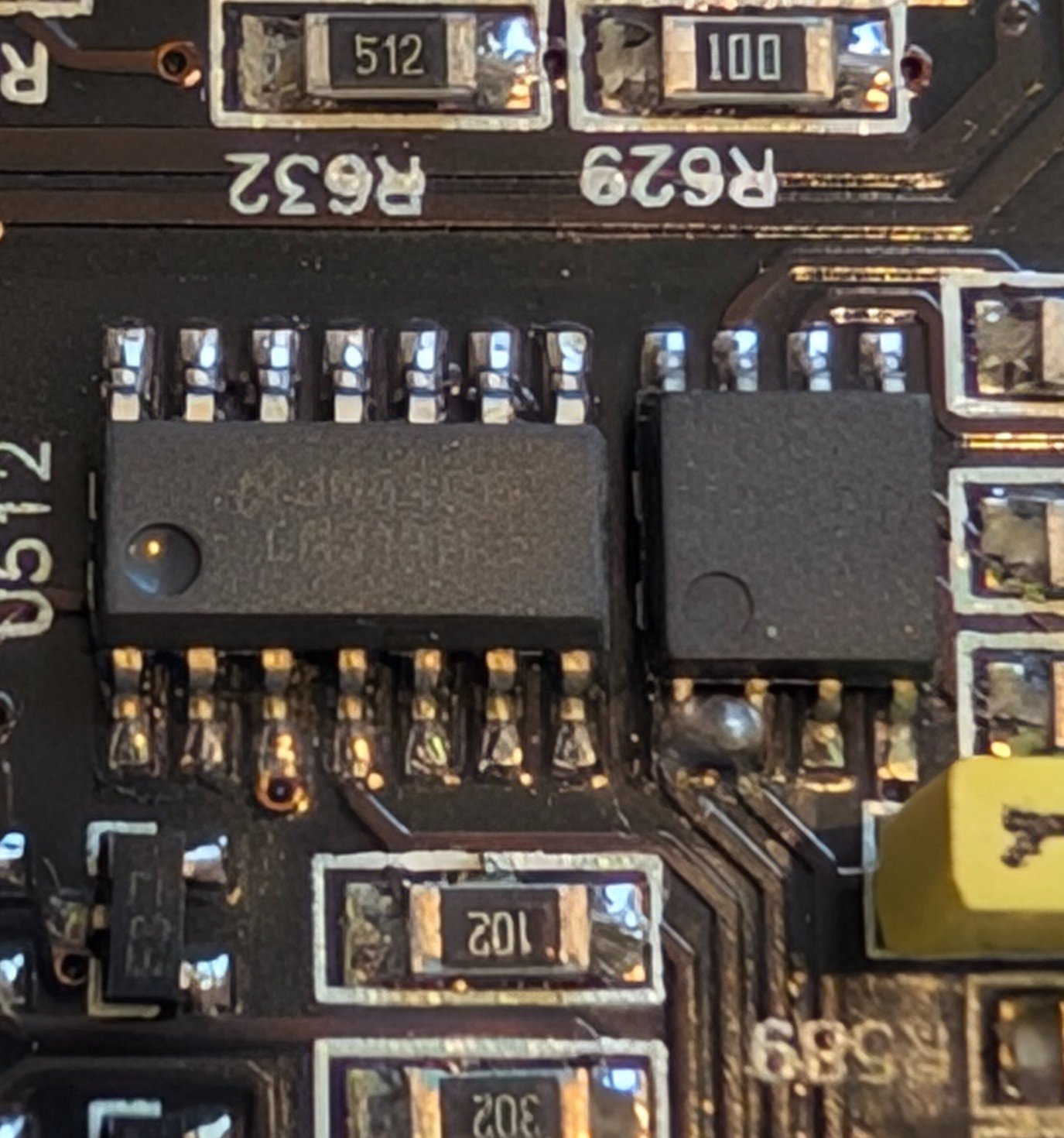

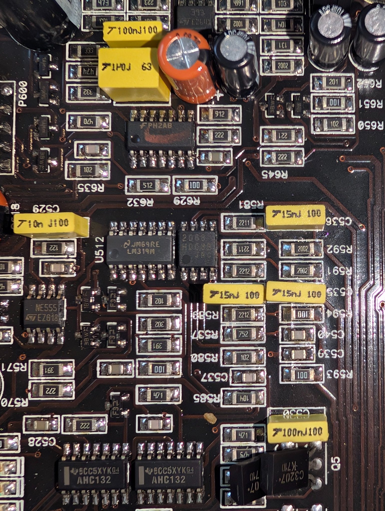

For the amps I've tested this on (not a rev11 but a 3 and 10), the 10 pin connector is all you need for the jumpers when testing only for drive signals. You can leave the others connected but if they pull loose, you can leave them out.
The 4.83v on the supply pin of the LM319 is OK. The voltage is dropping across a 10 ohm resistor that they use to improve filtering.
