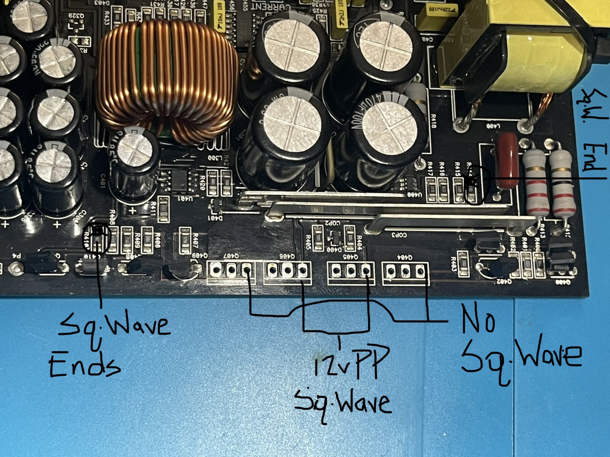

I didn’t even think about the low side, only seeing one gate get a wave on the 4 output FETs (2 high / 2 low) should have been an indicator, didn’t even realize each side has its own chip, is that common? Are there always separate chips for both high and low side? Just thinking about it now the Alpine M650 I’m repairing has 2x IR2010S chips, assuming on for each side?
I am not getting a wave on the low end, which is 4.3v @ each FET gate, both high side FET gates now have a 5.3v square wave.

Is the 4.3v pure DC?
What do you have on the output of the 4427?
The 4427 drives the low-side.
Why do you want another 4427?

Looks to be -4.3v dc, no frequency although scope says 1-1.2vPkPk?
4427 out pin 7 @ 12vPkPk w/square wave
4427 out pin 2 @ 6vPkPk square wave
both FET gates with waves @ 12PkPk squarewaves

So I can see the wave stops at each of the 1281 resistors on both sides, but they both read within spec 1.82k Ω, would I be able to see the wave between each component or is that now how it works when going through resistors and such?
all other resistors I can see in path are in spec, I’ll keep looking for out of spec components.

O geez ...I didn’t even know the FETs had to be installed on low side for the high side to work, or is it high feeds low? I’m assuming that cuz there is no FETs installed therefore no FET legs are connected to source to give off a signal for the other side to ...crazy how a realization can feel like a wow learning moment and still make you feel dumb af ...
all FETs installed, amp seems to be running perfect, high and low side waves now present, testing with a signal before reinstalling back into chassis.

The FETs don't have to be installed. If you jump the d-s for each low-side FET, you can see the high side drive signal.
