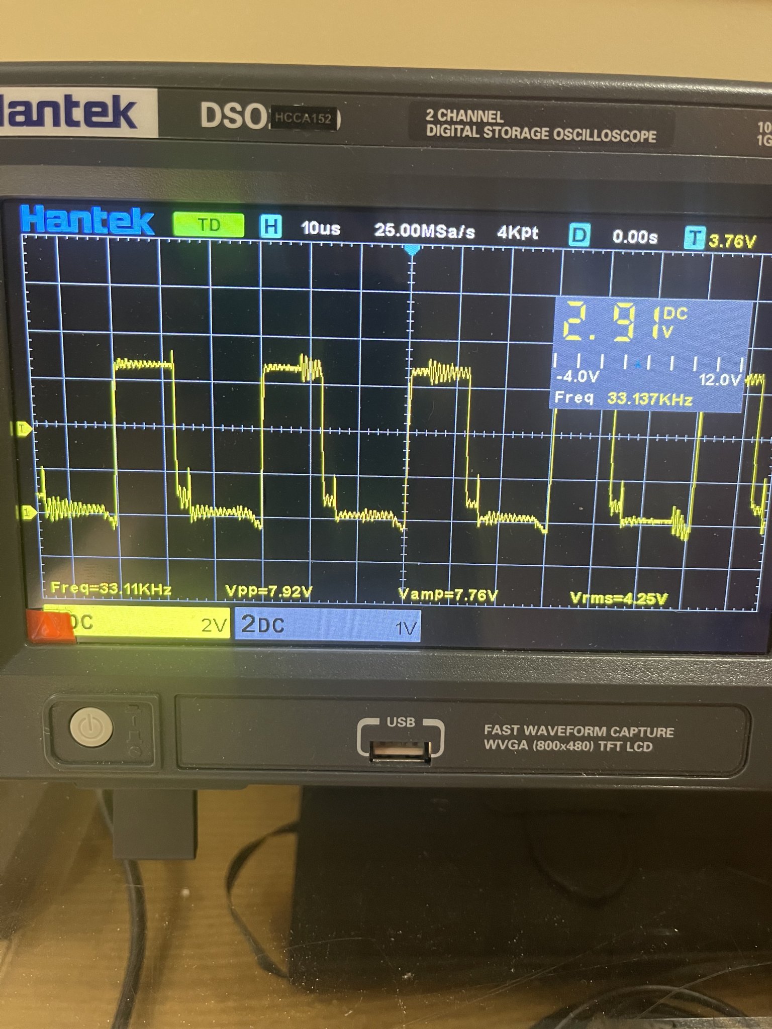

Looks to be -4.3v dc, no frequency although scope says 1-1.2vPkPk?

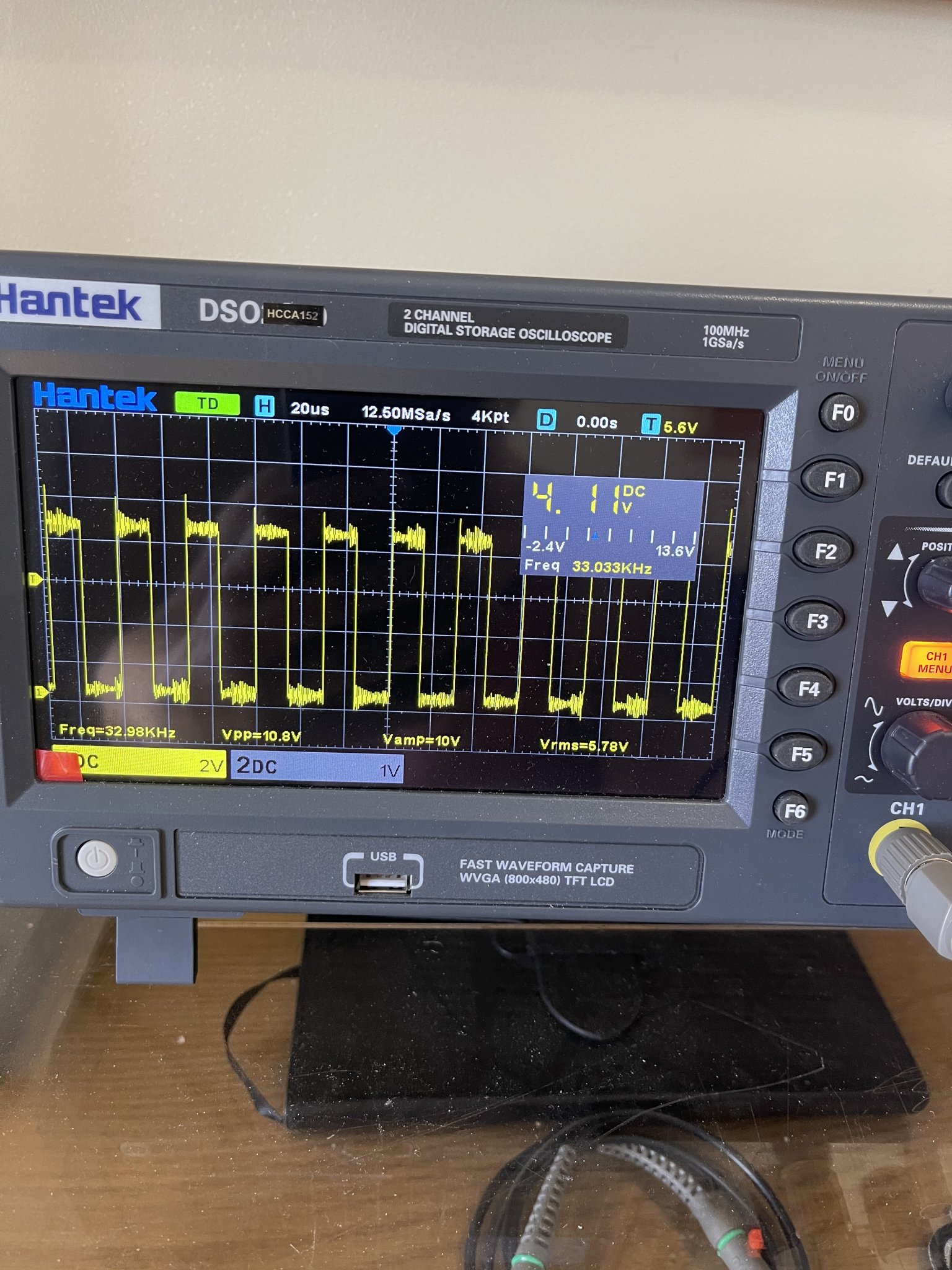

4427 out pin 7 @ 12vPkPk w/square wave
4427 out pin 2 @ 6vPkPk square wave

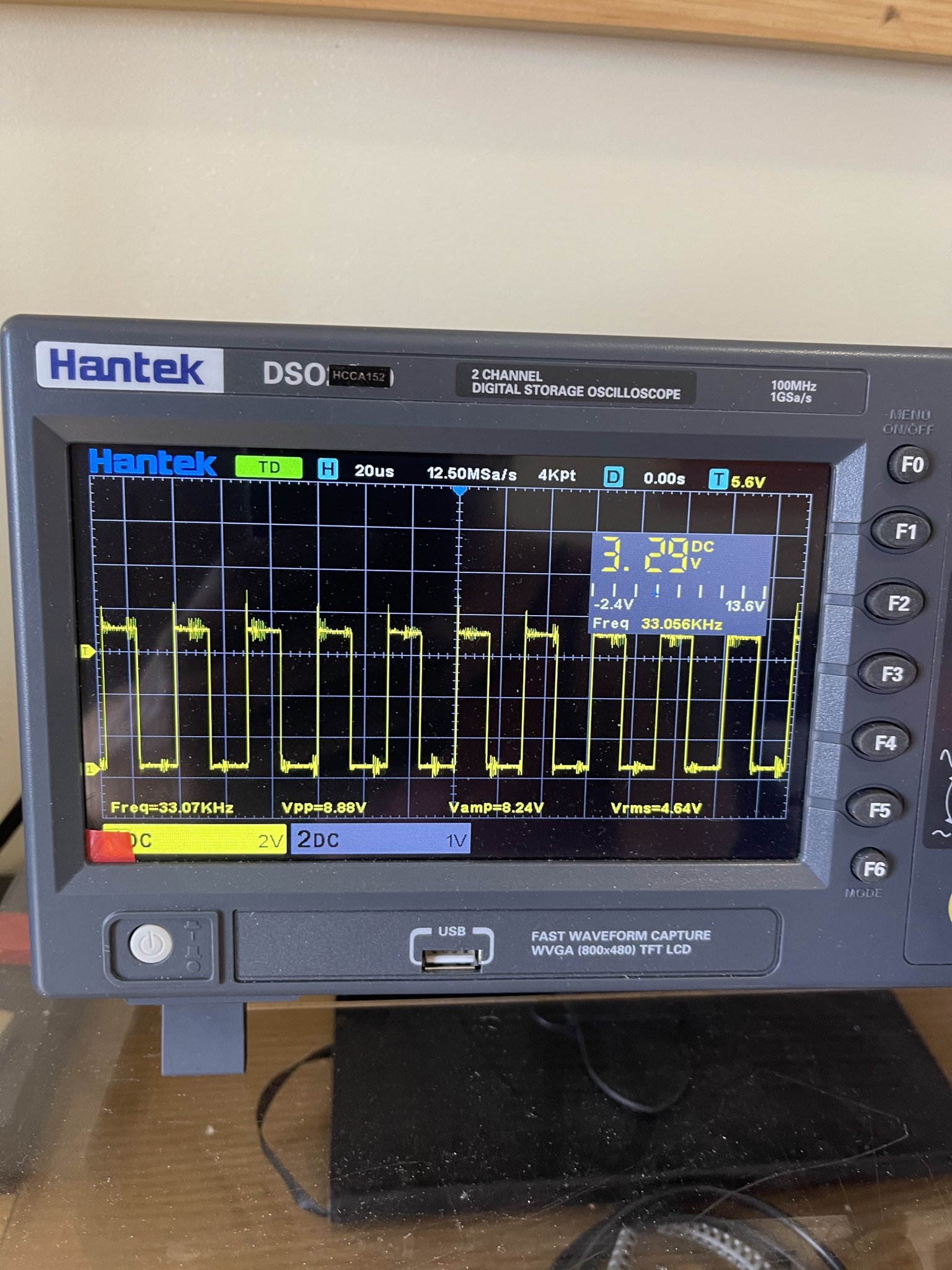

both FET gates with waves @ 12PkPk squarewaves
Just my newbness assuming is all, sometimes I forget just how many different ways there are to do the same thing with amplifiers, I know some tech still being used is 10/20+ years old and then there’s new unique 1 off designs, need to take each amp as its own and try not to compare to other boards I’ve worked on in the past.

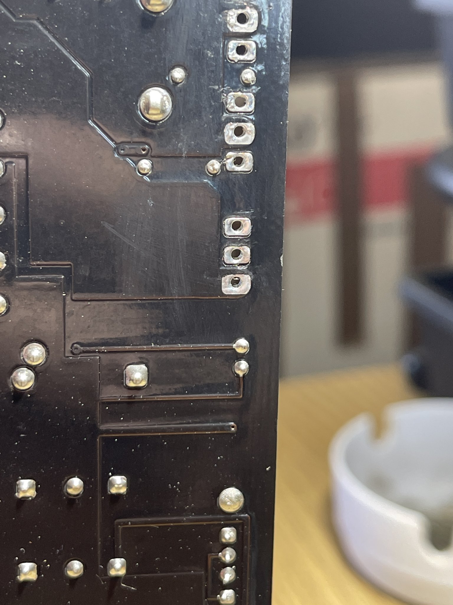

I can trace the Square wave back from the 2 inside FET gates back, but path for outter 2 FET gates stops at the top of each resistors circled, R410 & R414.
