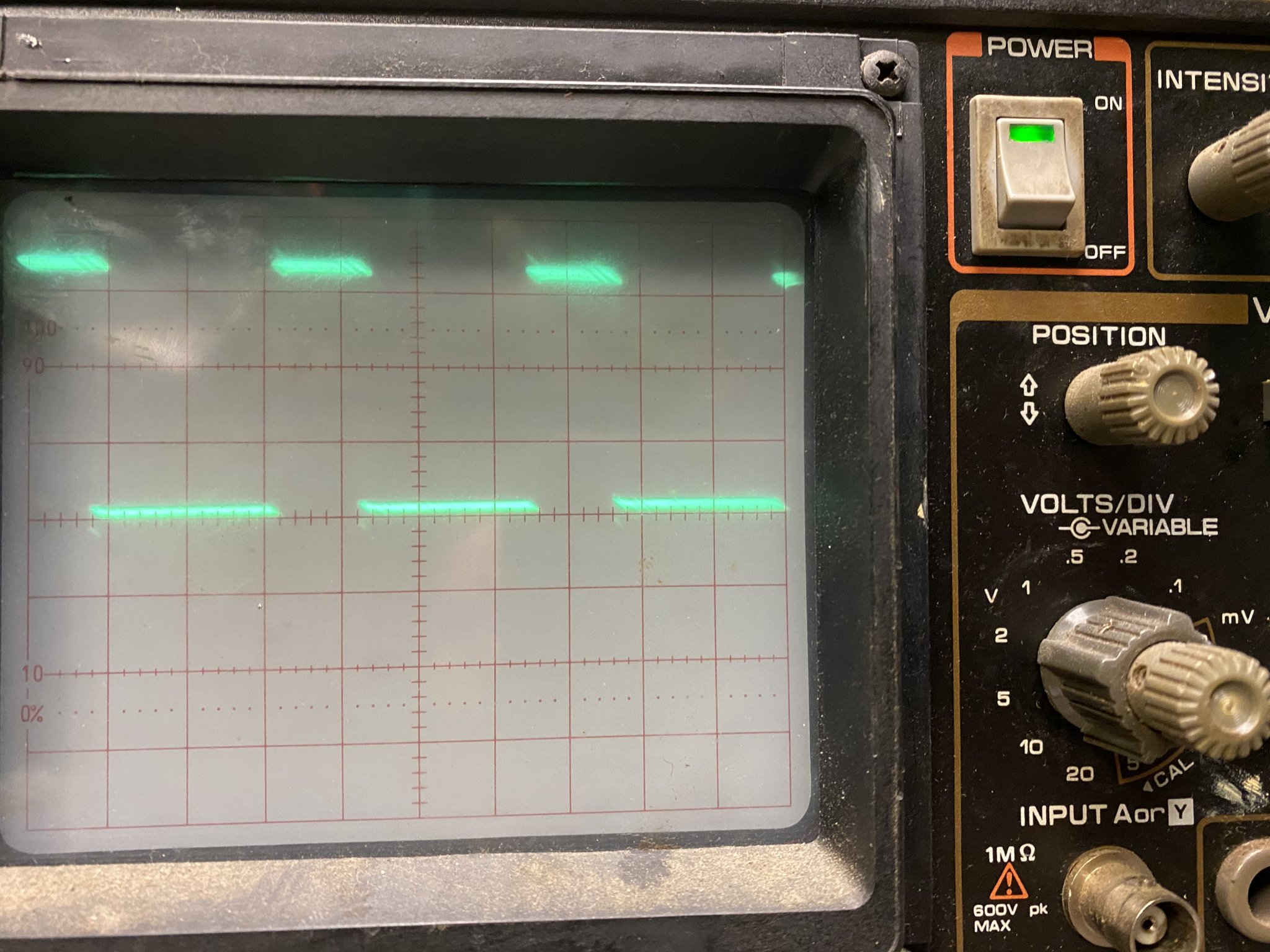

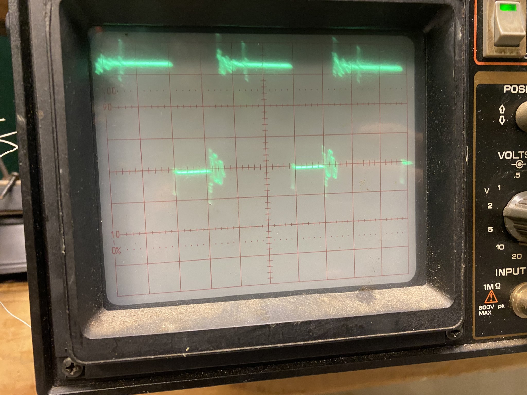

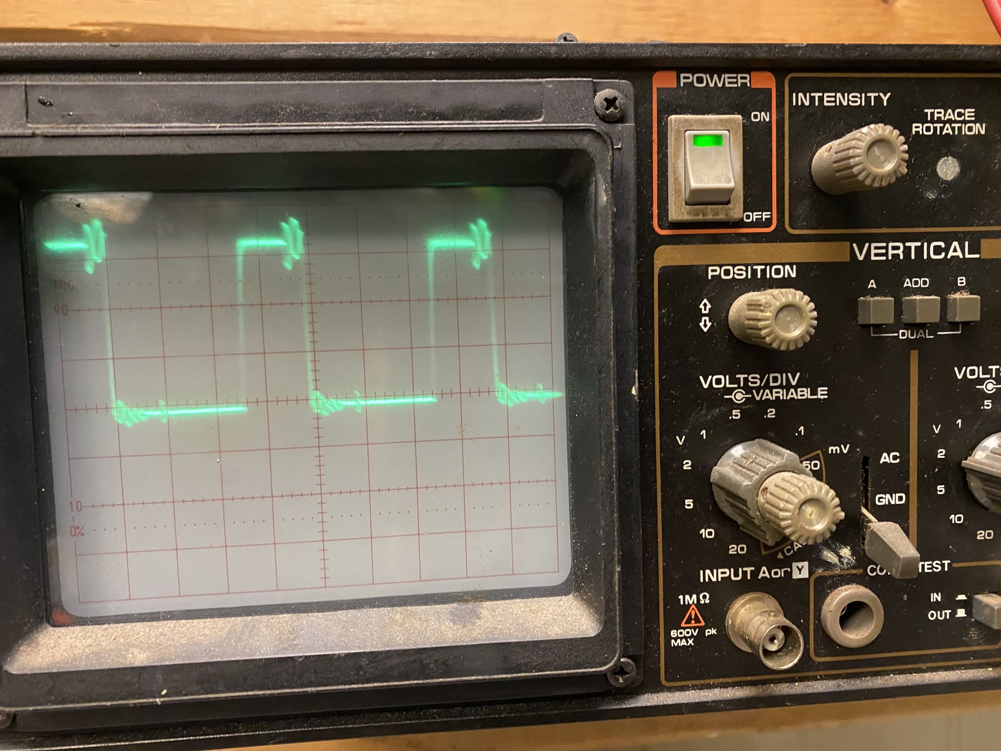

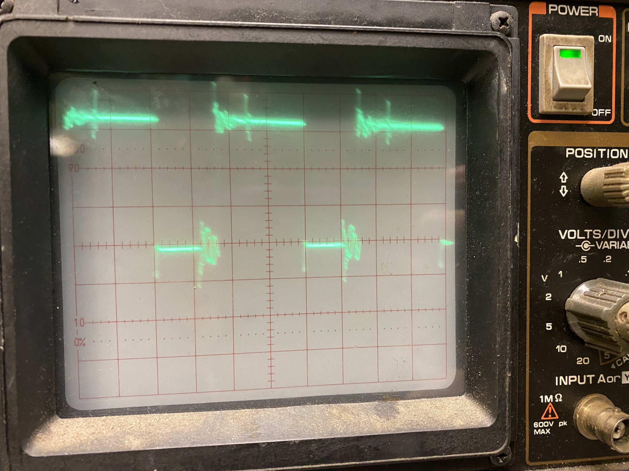

Here is what I get on the following
Q500,501,506,507
The last pic is what I get on Q502,503,504,505
Q500,501,506,507

The high-side is floating. There should be no voltage on the source leg of the high-side FETs. Confirm and then (if there is o voltage) ground the scope probe to the FET source leg and re-check. This is best done in differential mode but using the ground clip will work if there is no voltage.

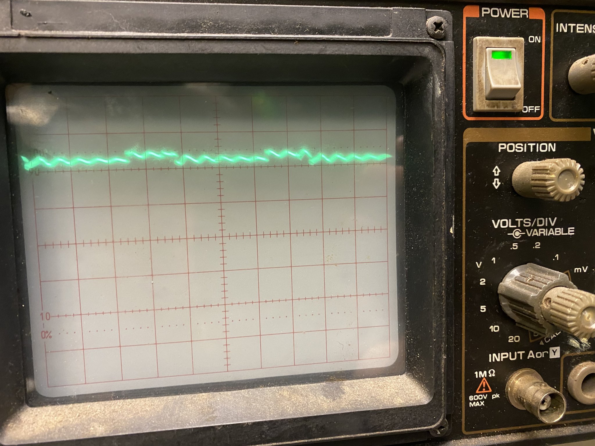

This is what I get on the source leg for the outputs (3rd leg)

Touch an incandescent lamp (one terminal connected to ground) to the high-side source pad. Does it light up?
No but I tried with a light bulb for a house .
I will get a 12 volt light bulb and try again
That means there there is no voltage source connected to that pad. If you can't use your scope in differential mode, ground the source pad through the lamp and re-check the gate signal.
I don't see anything that could be causing a problem.
Try all again with a 0.01uF loading capacitor. You can ground the scope to the source pad for the low-side FET pads to get a cleaner signal.
