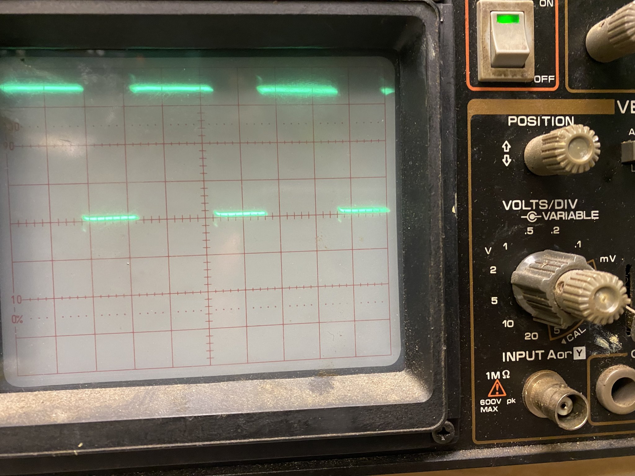

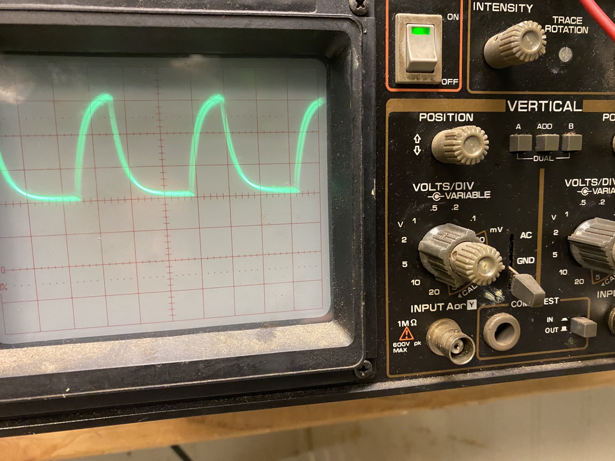

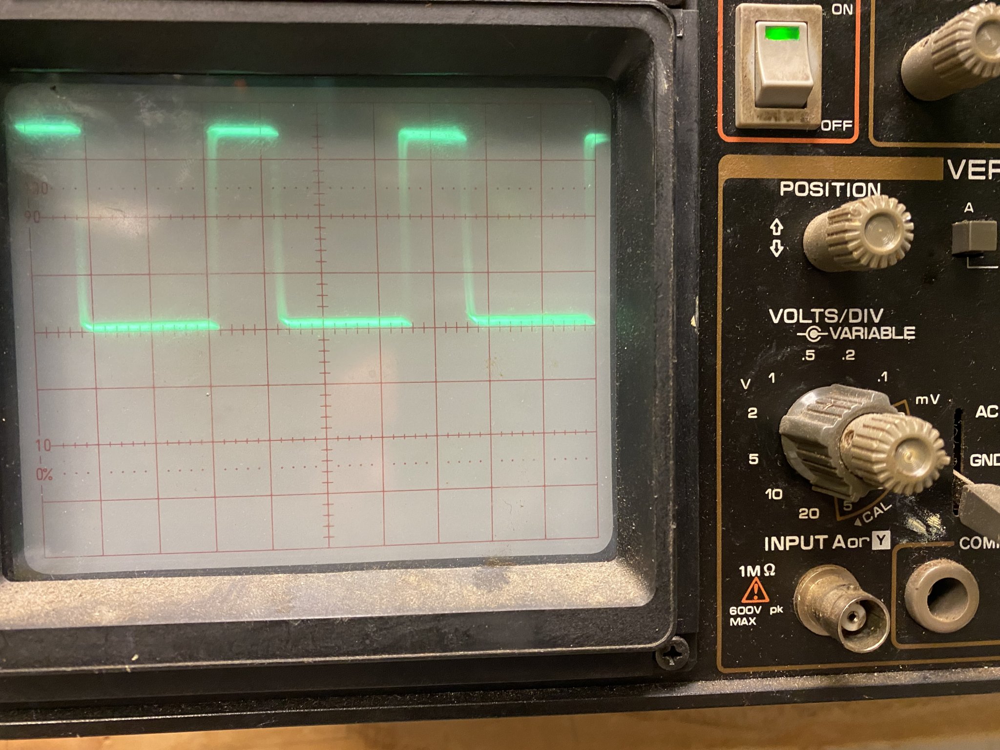

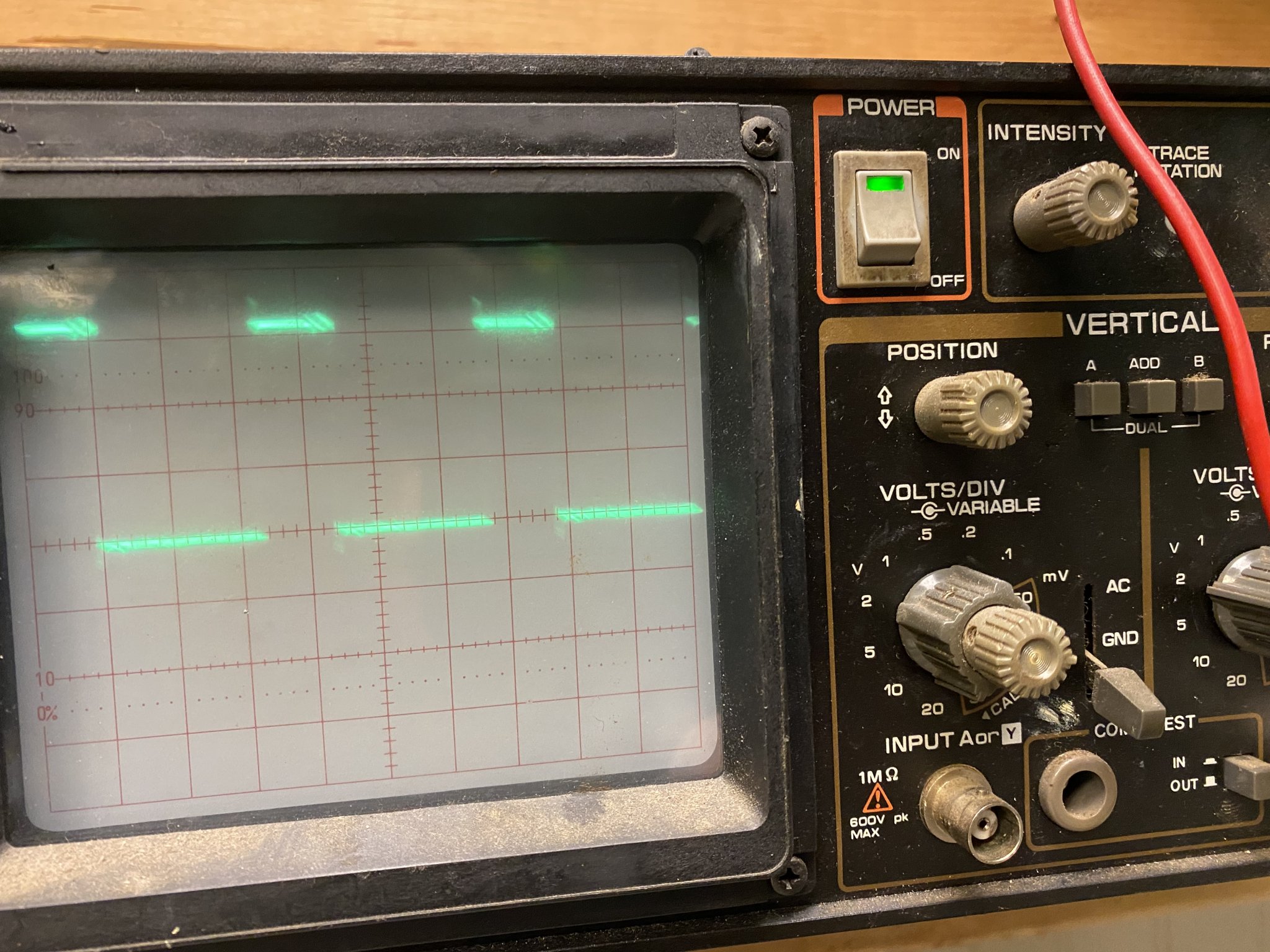

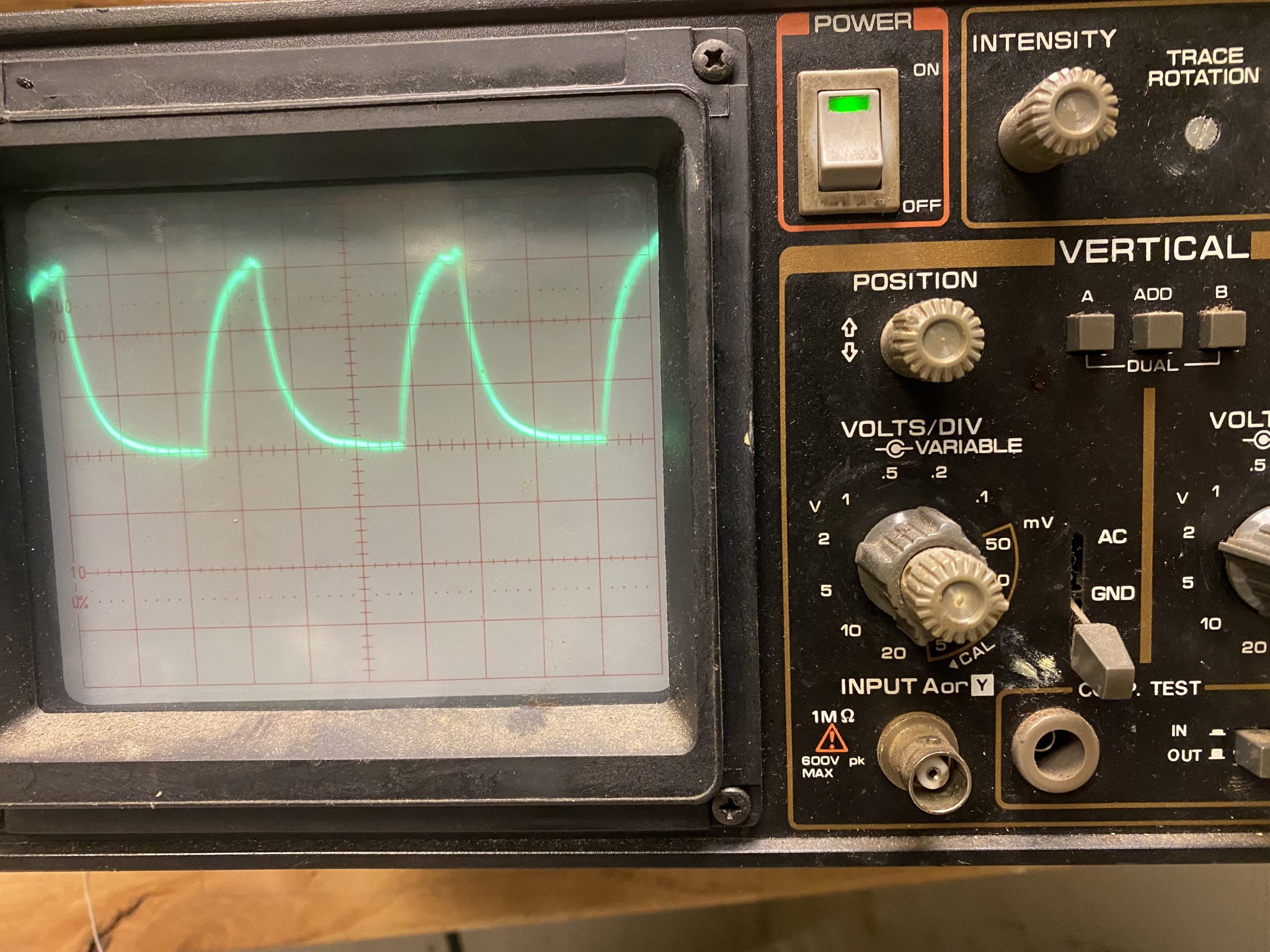

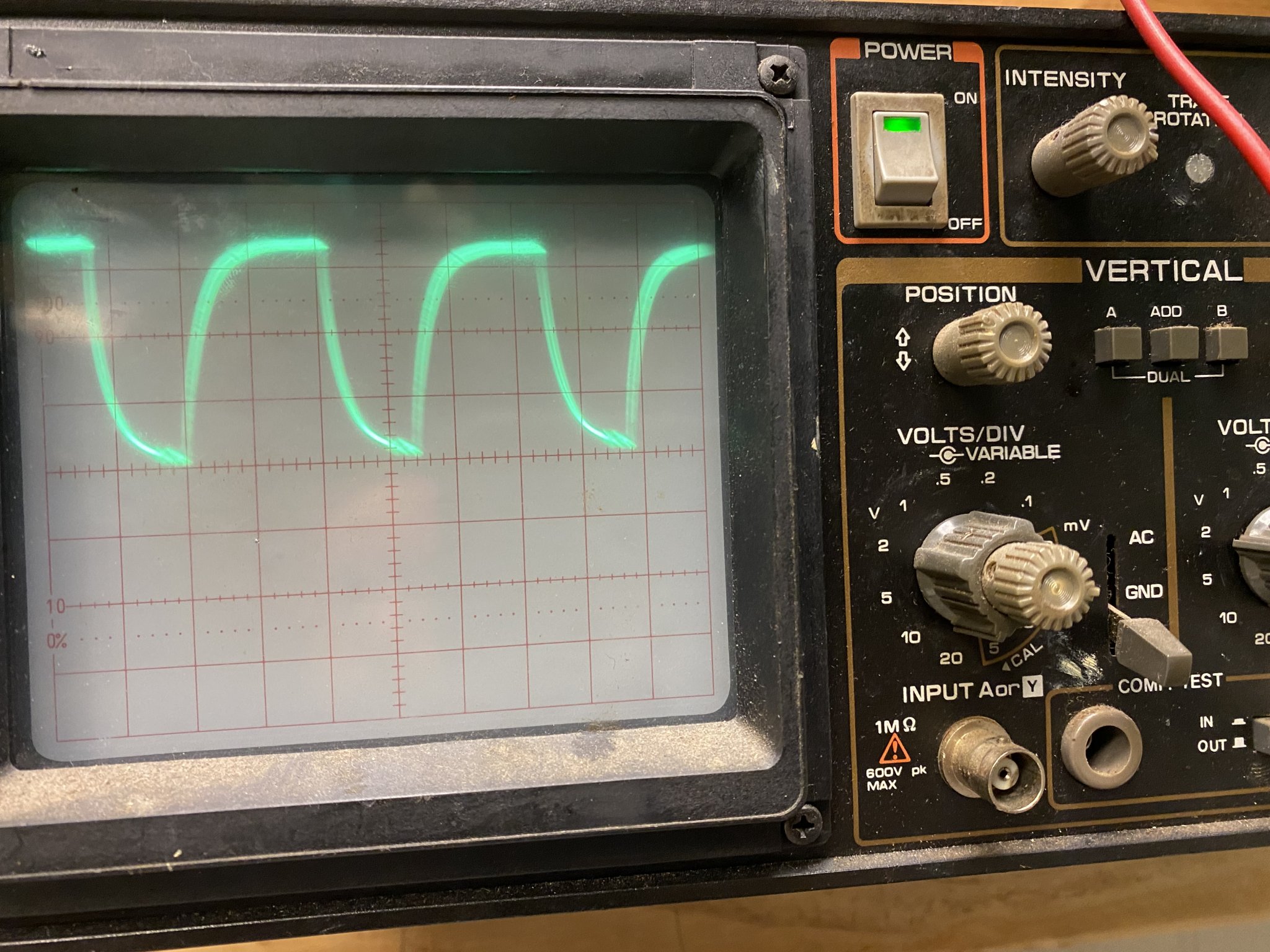

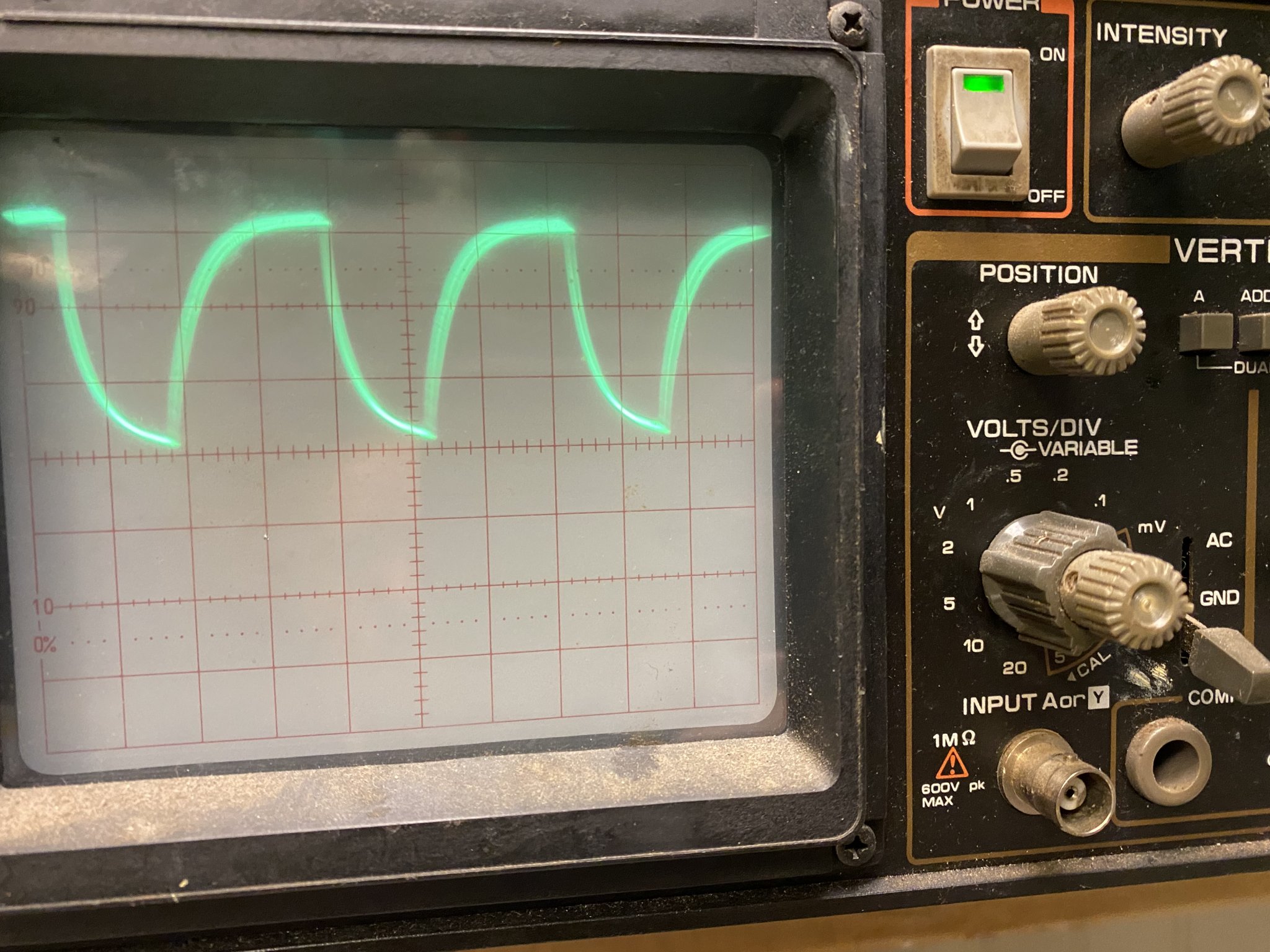

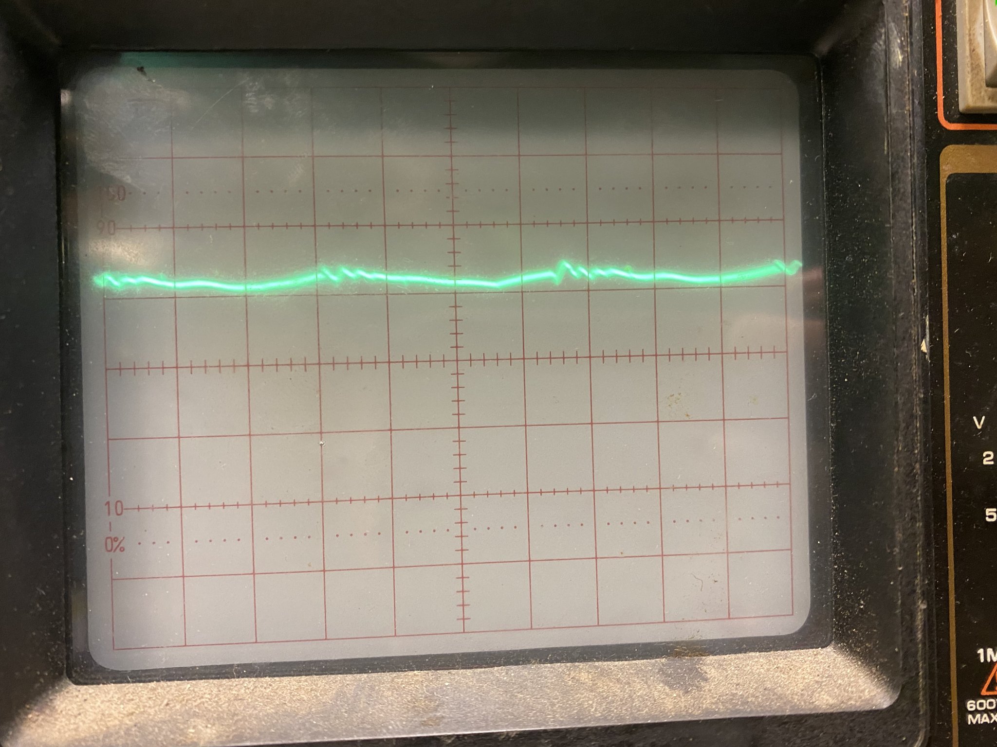

Ok here are the drive waves for the low side fets Q500,501 are the first pic
Q506,507 are the 2nd pic
The wave forms look different is this normal or do I have an issue with the drive ?
First pic is of Q500,501
2nd pic is of Q502,503
3rd pic Is of Q504,505
4th pic is of Q50,507
I think the problem is with Q500,501
Scope set to 5us 2 volts/div this is with a loading cap
With the loading cap in place and the scope with the same ground, what does the output of U5 look like?
I have a bad gate resistor . After I replace it I think the drive will be normal but the issue still remains with the dc across the speaker terminals.
