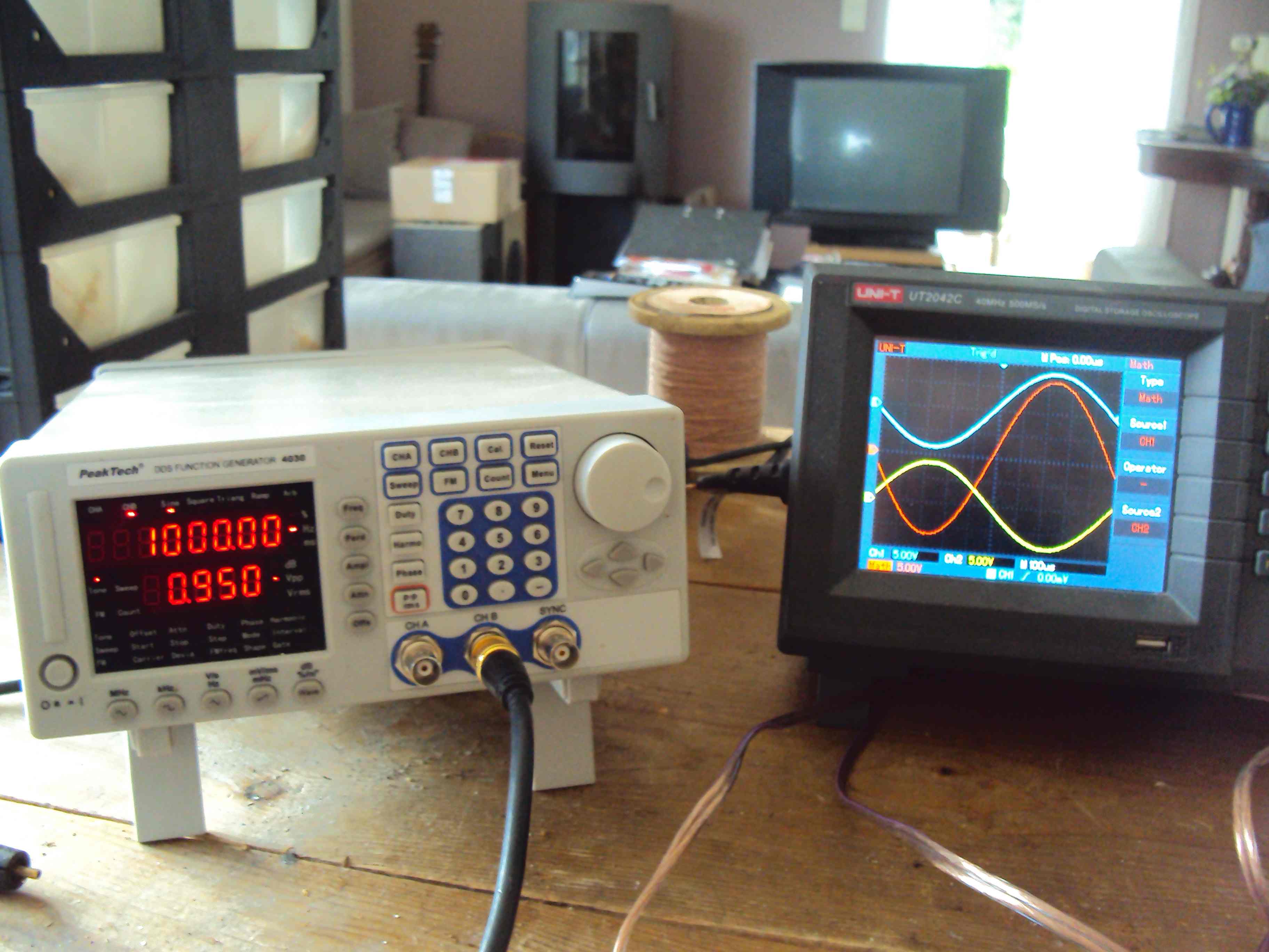

Just for fun i did the simplest bridge and it works. Into 6.6 Ohm i get now 22W, RMS. That is 34V P-P and 12V RMS. Into 3.3 Ohm the power does not double because the current limit sets in. I calculate about 4.2A, that is decent.
This is only an experiment. I decided to build 2 more SBPs and do them all inverted plus DVR134. That will give the best symmetry and the best technical performance.

Yes, that is the Elliott. I did not listen to it because it is only mono. I have to build a second set.
Which version sounds better i have no idea. Maybe we should arrange a shootout, the different circuit are quite easy to implement.
I could also do some distortion measurements but i usually do listen first to be not so prejudiced.
I started now to build the two other channels. I will build them non inverting like the first ones and do the Elliott trick. I have put this little amp now over 80Hz on my 95dB panels i have build for the ETF. Now decent volume is possible. I must say that i can not complain.
