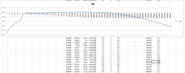

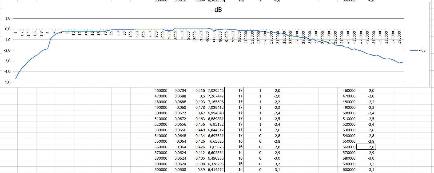

After reading this presentation I got the idea that one can search for an optimum bias for a push pull buffer so I decided to play a bit with the bias and increased it slightly from 130 to 180mA.
Measurements showed a real improvement... squares look like squares until 50kHz and faze shift is also greatly reduced in both extremes.
The major improvement is in bandwidth that now extends to 580khz at -3dB and starts at 1.4Hz at -3dB.
I could not believe in my measurements so I repeated them several times with consistent results.
Quite dazzled I connected the amp to my main system and now it sings !!!
Treble is now really extended and clear. Image grew a lot laterally as well as in depth. Bass is perfectly integrated, going low with very good control.
Voices are true and cymbals have real slam.
The amp is really quiet and I find the 19dB gain adequate in my system.
I plotted my measurements that I post here hoping for some edificant comments.
PS: I now consider this amp very good and the only drawbacks I can find are related with the opamp input .... maybe it is possible to use a suitable discrete jfet input ?
