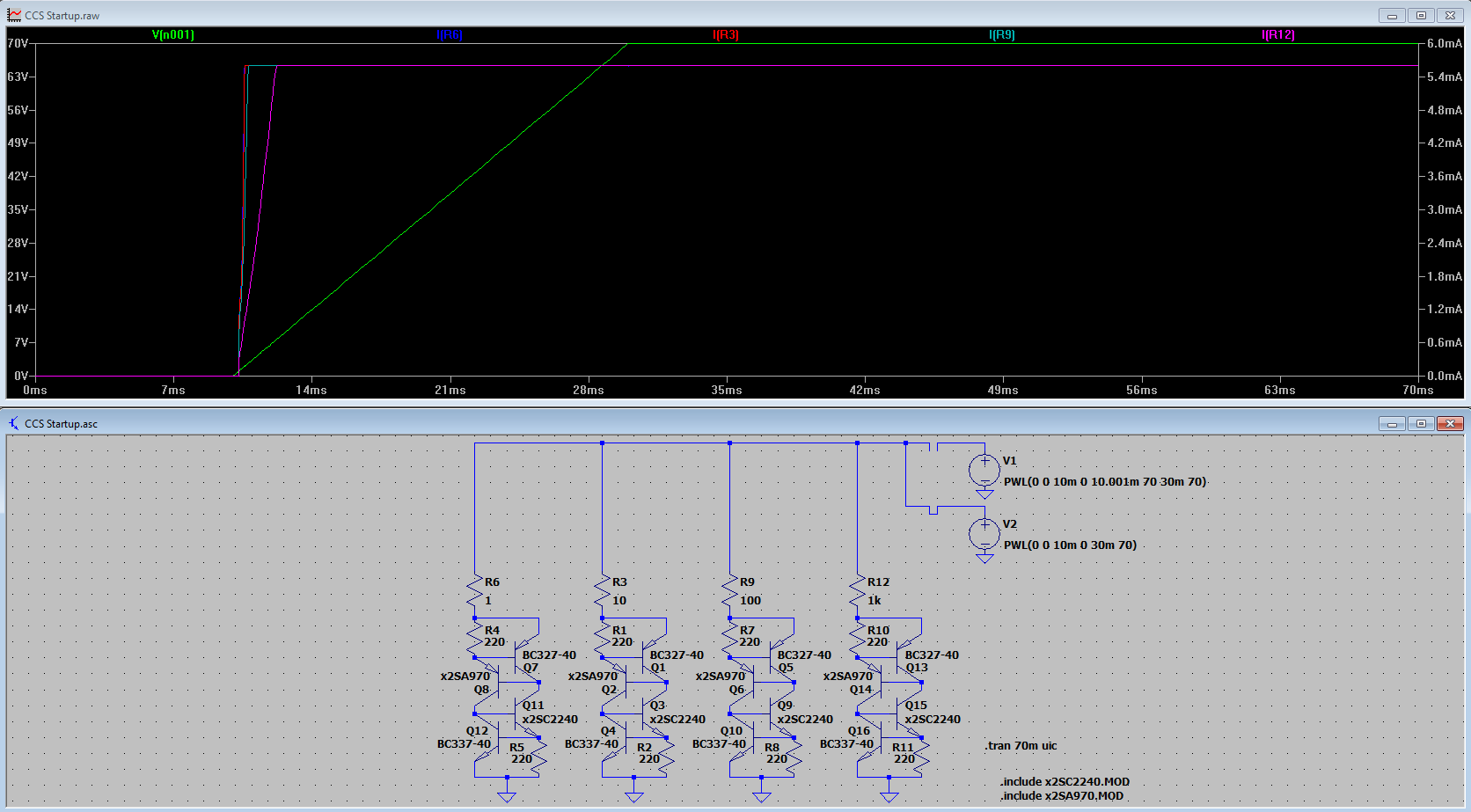

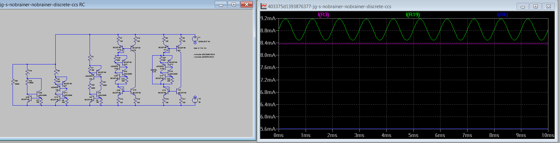

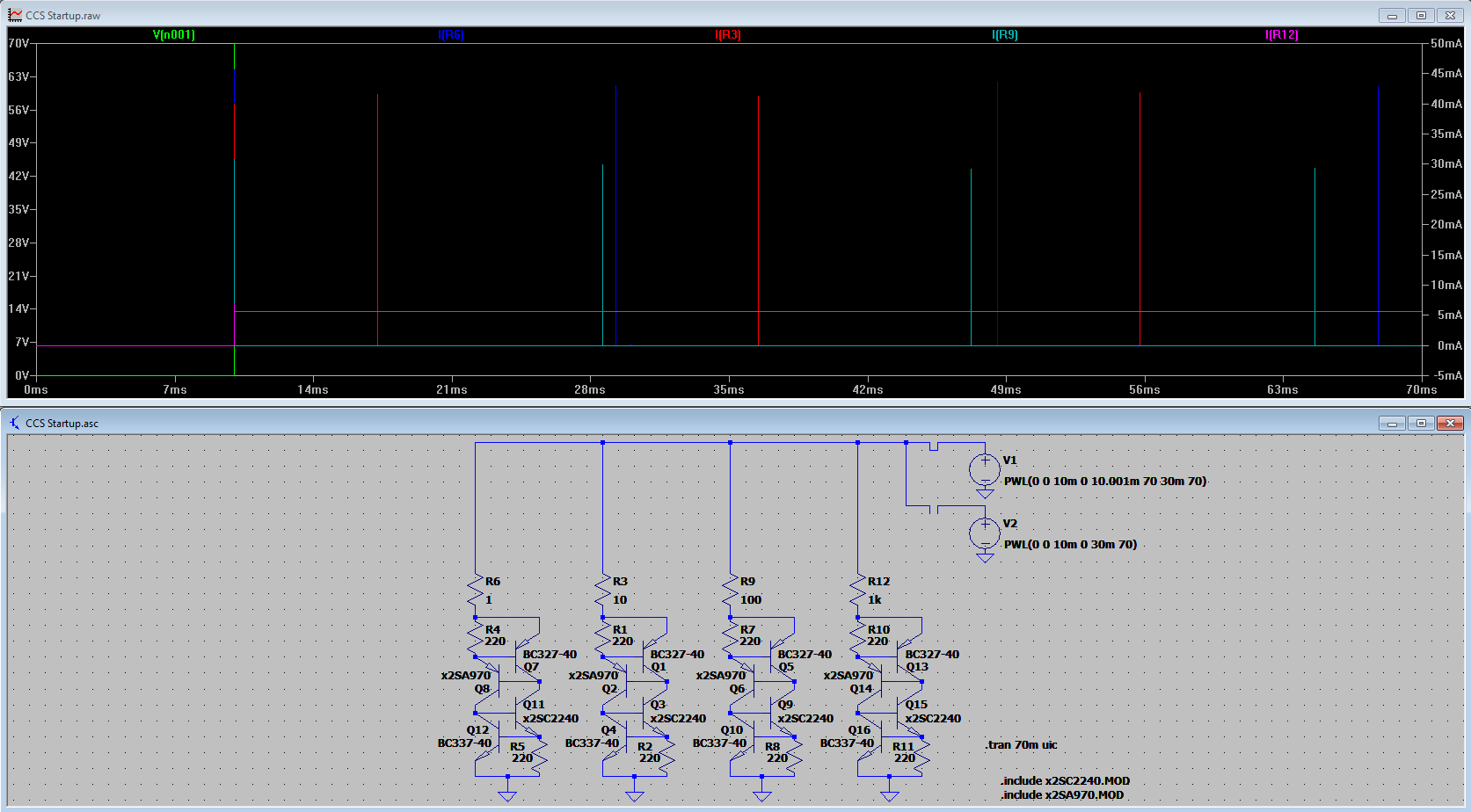

The 180 ohm resistors give about 3mA that times 2 gives your 7 (give or take one) mA's. That's all functioning. Maybe it is a startup problem? the Vce of the low voltage parts could start conducting before the high voltage parts (Vce breakdown). Try the same with all high voltage parts and see. You can leave the resistor in place it will not be of a great influence. Also try to get the resistor down and see what the lowest 'working' value is. I can do some test myself, but not before the weekend :( :)
Now this is cool! :) Low rising voltage (green) different resistors, all currents are equal. Now you may ask what is cool? I show you (next post :))

according to this sim, your new ccs version seems much stiffer than the "usual" two NPN arrangement (that I built just for Learning purposes)
The "usual" one works flawlessly but it's current highly dépends on Vcc.... going from 35v to 70v almost doubles ccs current.
According to the sim, FdW ccs does not suffer from this "illness". It stays put whatever Vcc I use :)

... FdW ccs does not suffer from this "illness". It stays put whatever Vcc I use :)
That's what I like :) calling it then 'FdW ccs' like I invented it. Actually I did do a lot of Google-ing to see if there is any pre-existing art and I could find nothing.
My question here is; 'Is there anyone here (or somewhere else :)) that knows of any prior existence if this CCS?', let me know!

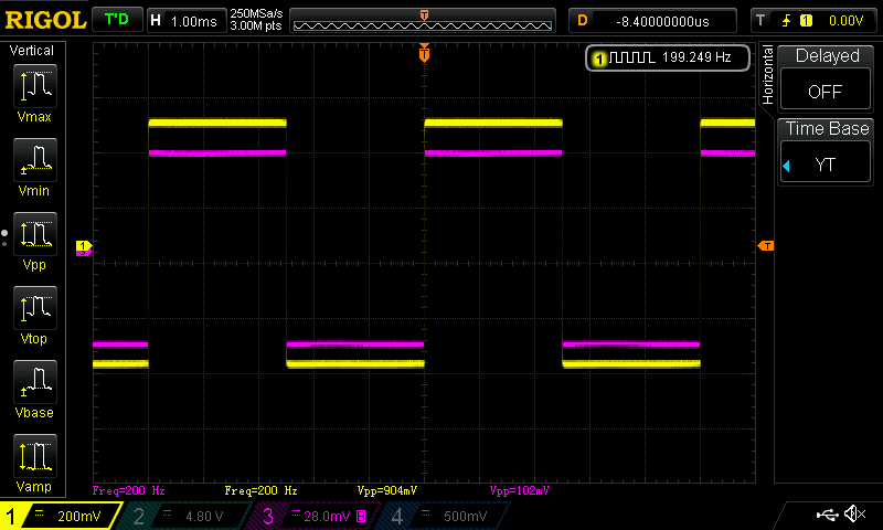

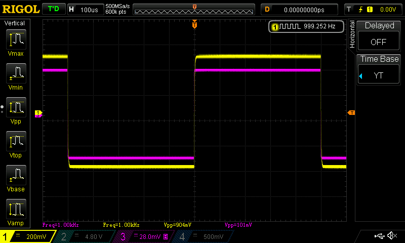

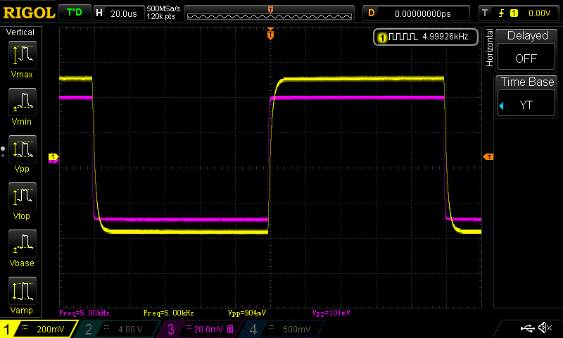

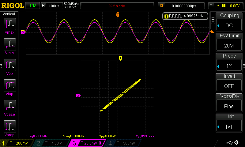

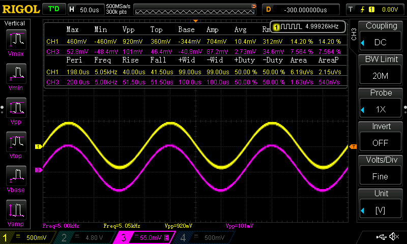

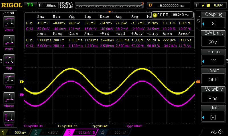

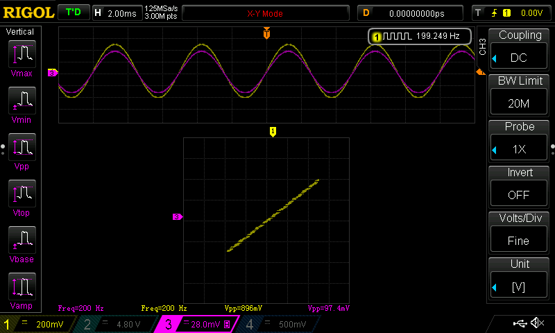

My measurements done with 100mv input and a "real" 8ohm speaker load. (Do not know if using a resistive load would change things significantly)
From 200Hz to 5KHz things look quite good

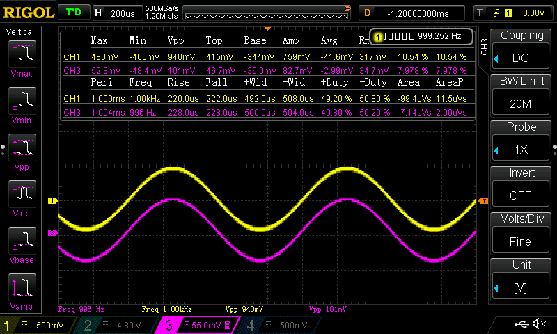

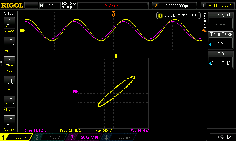

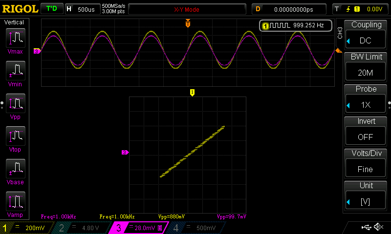

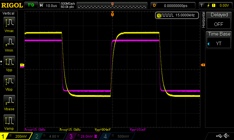

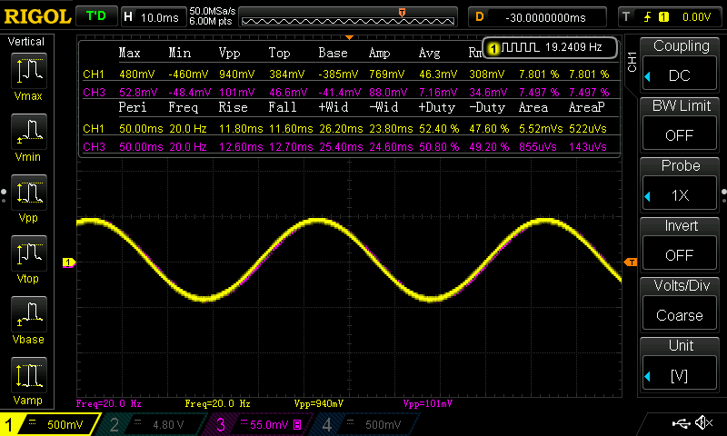

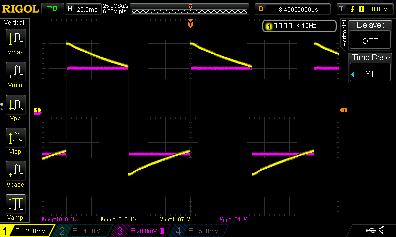

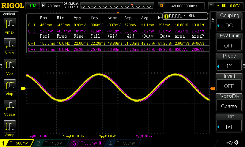

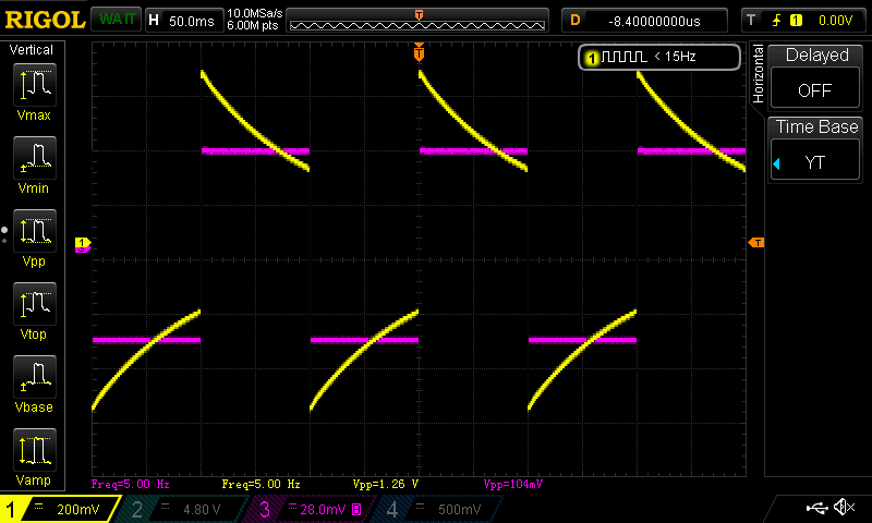

Joined 2006

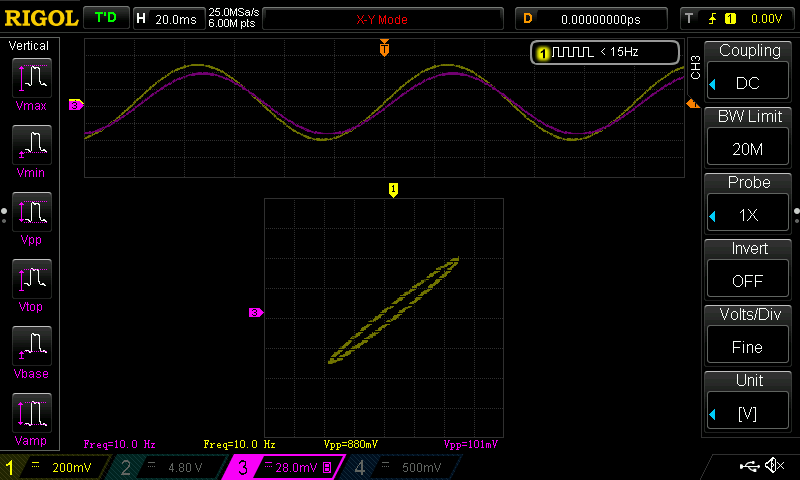

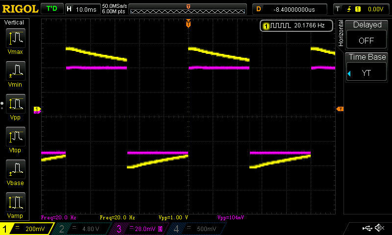

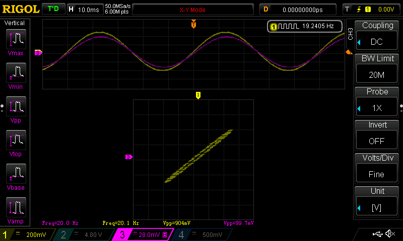

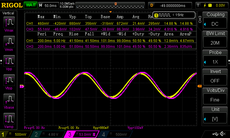

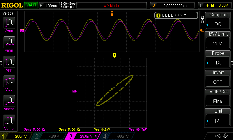

At 5Hz 10Hz and 20Hz I notice Low frequency loss and phase shift, no amplitude distortion but out of phase.
Joined 2006

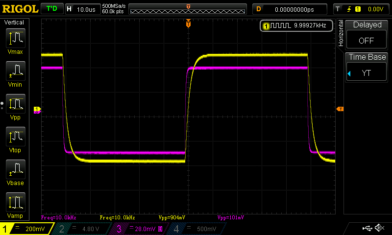

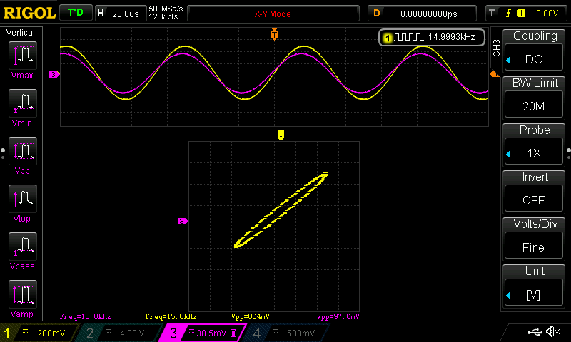

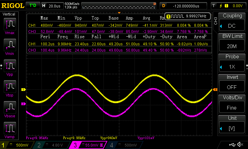

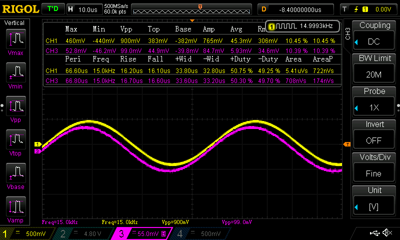

At 10khz and 15khz gain is still max but we start to have high frequency loss and phase shift , without amplitude distortion but out of phase.

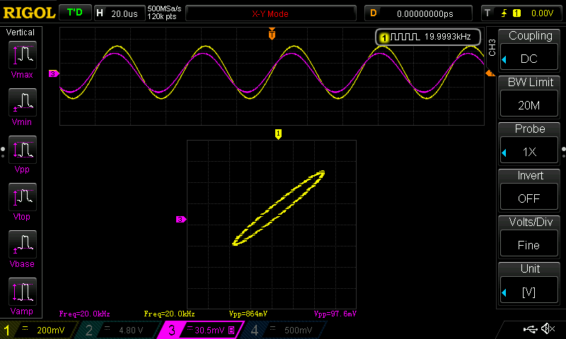

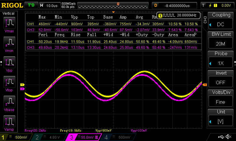

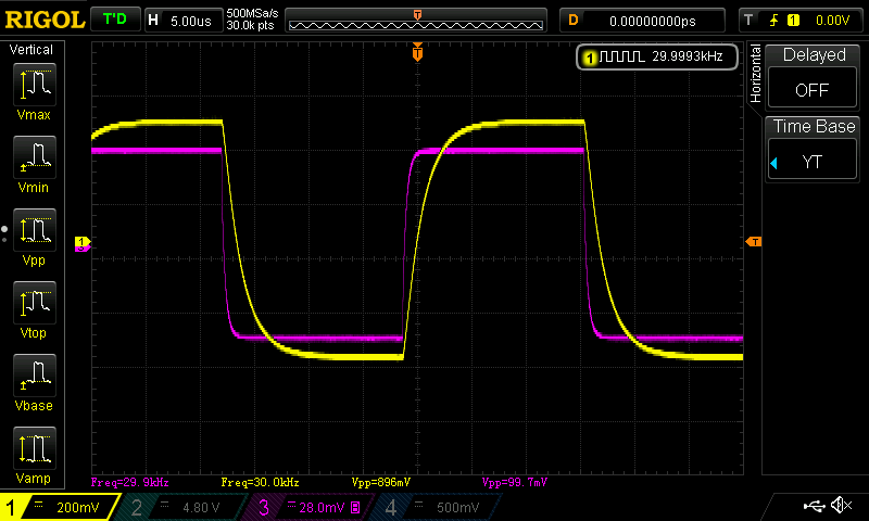

Joined 2006

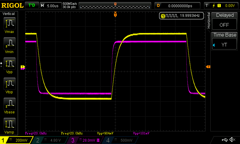

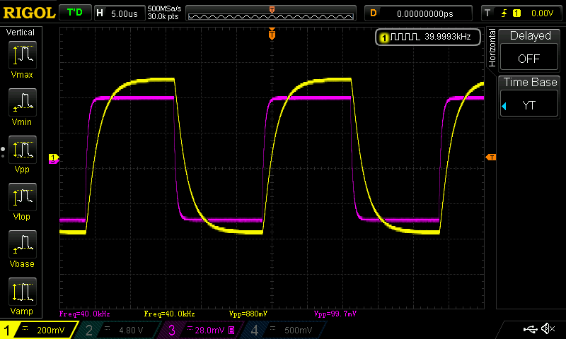

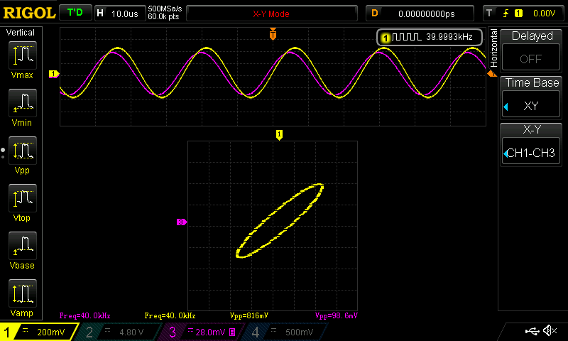

At 20kHz gain starts to lower from top 20dB (19dB at 20k) and the trend is accentuated (high frequency loss and phase shift , without amplitude distortion but out of phase)

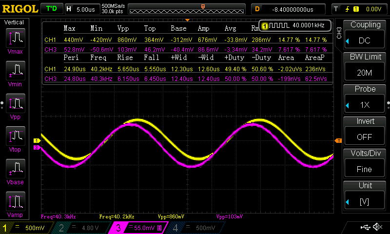

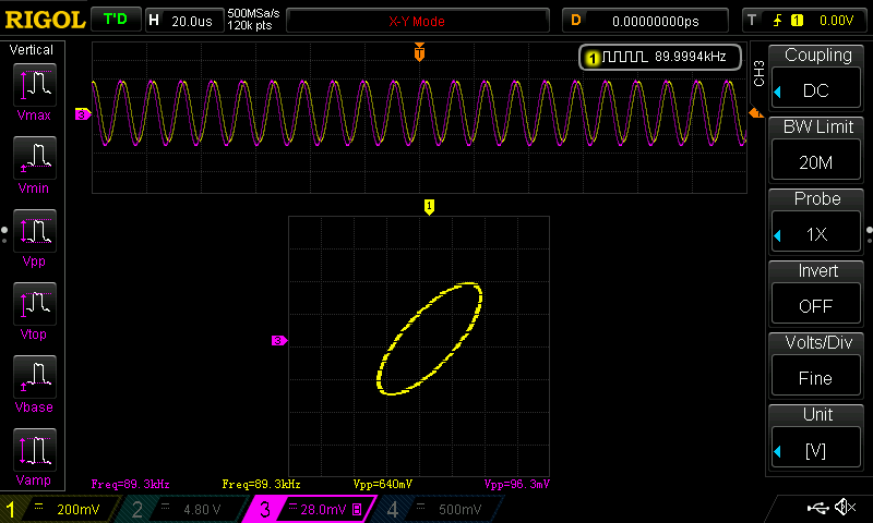

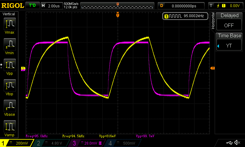

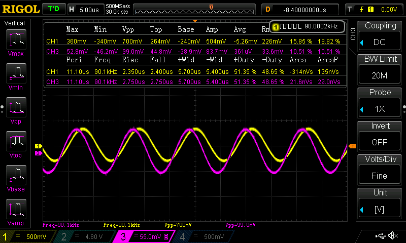

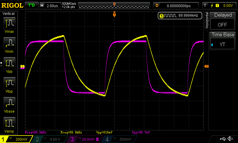

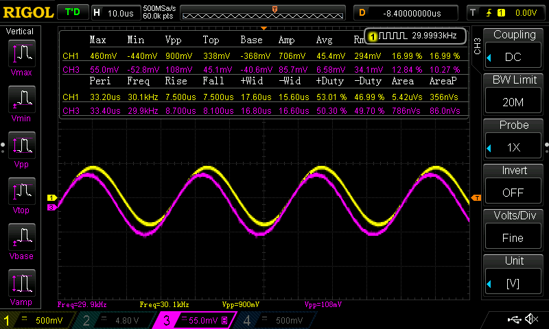

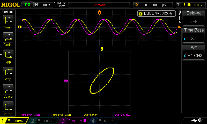

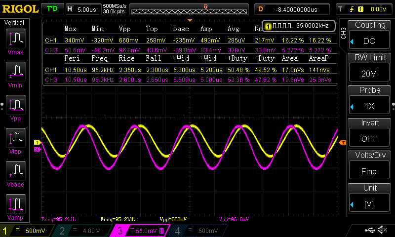

Joined 2006
At very high frequencies we notice high frequency loss and low frequency phase shift (no amplitude distortion but out of phase).
