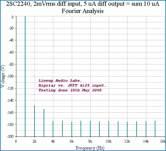

I've been doing some listening tests of jfet vs bipolar transistors, and found some generel sound differences.
Jfets tends to sound softly, while bipolar sounds more dynamic.
Okay.
I think this is a myth.
I did some comparing spice tests with differential inputs.
Lownoise JFETs vs. Lownoise BJT.
Note: My test used ONLY input pair, with collector resistors.
They were tuned to do exactly same AC current job.
for example: 5 uA current AC output across 1 kOhm resistors
or 5 /50 mV ac across same resistors.
This means
- open loop
- one transistor base/gate tied to GND
- the other fead with a few mVolt input
I did tests without Emitter/source resistors.
In this case I adjusted mV input, to do same job across collector load
( BJT had like 4-5 higher gain than JFET. uA AC current / mVolt input )
The THD harmonics ( 2nd + 3rd ) was at very similar level of magnitude.
At same job done.
The only significant difference was that JFET had a bit higher 3rd harm dist, than 2nd harmonics.
While BJT, bipolar had the other way: Like 7-8 dB higher 2nd harmonic distortion, than 3rd
This might come as surprise.
But actually this was so in my test.
I also tested with same input level: 1mV / 5 mV
In this case I adjusted with Emitter/Source resistors
to get equal job done.
Of course the bipolar in this case can afford more resistive degeneration
as they have like 4-5 higher AC current output per milliVolt AC in.
This gave like 12 dB lower level distortion than JFET pair. ( -149 dB vs. -137 dB )
At same level in, same collector job done.
My Conclusions:
All else equal,
- Lownoise JFET ( 2SK170 ) have higher 3rd harm. distortion, by their nature, than bipolar lownoise
- For lowest 3rd harm. distortion + overall THD, use bipolar input differential
- Or use JFET while letting them perform an easier job
+ use some Source degeneration RESISTORS for them
Remember, not only low THD is a positive amplifier feature.
Also we have low bias current and DC Output offset to consider, many times.
Lineup
Attachment.
2SC2240, The Fourier result.
