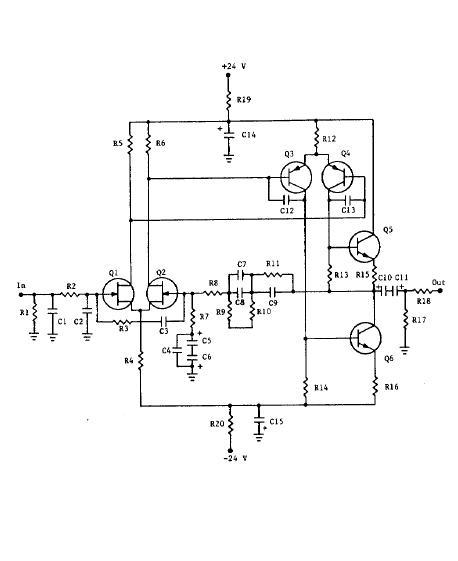

In an archive thread there were people raving about the Kaneda preamp, a legend never to be repeated.
Well is an identical circuit by Marshall Leach, a discrete universal opamp using dual diff amps both fets and Bi polar.
Ian

Leach Preamp circuit ...
This is circuit configured as a gain block makes a fine gain stage. I've used it both as an RIAA stage and line driver. Nice ! 🙂
