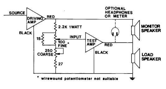

about the null test like I said before, there is a lot of input about this test made by my friend Tube Dude in this forum, just search...
in short terms, it's a differential test that directly compares the input with the output leaving only the thing that cant be nulled, all nonlinearities created by the amplifying stage! lower the value, more the output resembles the input! one thing great about the test is that the distortion of the generator isn’t a problem like the typical distortion tests and that severely limits resolution of those tests

did you verify this with a null test? remember that the null test isn’t a typical thd
Still you still have not answered the question. What types of test are you running? Can’t you be just a little more specific regarding you claims?
Offset , THD , Gain, BW, Phase, Slew Rate, Transient , Noise
What is your null?
I beleive, that that null test was published in WW in 80th
> What is the file type?
MS-DOC inside a ZIP. But it is just 1K of text:
the null test results - cheers - Ricardo

> the null test isn’t a typical thd test! all non linearity’s are measured.
> This is not a standard recognized test in the audio industry.
No; and perhaps because it is one of the most embarassing things you can do to an amplifier. It can also be called a "Total Garbage" test: everything wrong stands out. The numbers are probably not important except for the most general classification. But it is a widely-used design-bench test, because it is easy and a look at the O'scope display tells the savvy designer if he/she has phase shift, noise, low-order distortion, or a lot of high-order crapola, and if it happens on peaks or at zero-cross or some intermediate point (marginal instability). I've seen null-tests published in reviews, though I think you need to do a lot of such tests yourself to get a good feel for what it may be able to tell you.
> It is not like a true measurement of performance like distortion or a spectral analysis or noise.
Ah, but what is "TRUTH"? It has been clear for 50 years (actually since pentodes and feedback) that THD-number isn't "truth". Spectra are so messy. And there are so many ways to lie about noise. The total-garbage out of an amp is arguably no worse than most of our other "measurements", many of which have little to do with how we hear.
I thank Ricardo for the numbers, but without knowing how much of the number is phase-shift, noise, low- or high-order distortion, or if the test rig was optimally adjusted for each amp (in ways we could do in the real world), I don't trust it without trying things on the scope.

Having played with the null test a bit when I first saw the Hafler XL280 amp manual, I HAVE to agree with what PRR said. My opinion is null testing is useless if you're not going to look at the residuals on a good scope and interpret what you see correctly.
Hmmmm, that could probably be said for THD meters also, now that I see the words.
However, I'll agree it is fun to place around with 🙂 As usual in this hobby/business, the real benefit comes from understanding the results.
PRR said:
.... a look at the O'scope display tells the savvy designer if he/she has .... crapola, ....
