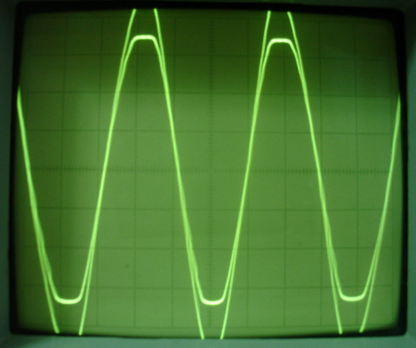

I just have measured output power of this jFET buffer (with preamp connected, 20dB voltage amplification). With 7,2 Ohms resistive load it gave 4W undistorted 1kHz sine signal at the output.
Enclosed is also the sine signal at clipping condition, 1kHz frequency. There are no sharp edges.
