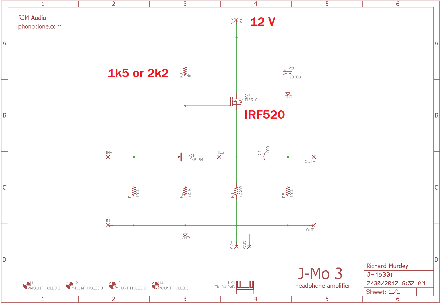

Hi, I build this amp with IRF520, 12VDC and a 30ohm resistor. However I measure around 7VDC at the test point instead of 2-3V. Will using a 520 instead of a 510 make such a difference? Thanks
The gate-source voltage of the IRF520 and IRF510 will only be about 0.5 V different, the main reason you have 7 V at the MOSFET source is your supply voltage is 12 V rather than 9 V.
You need to increase R3 in proportion to the increase in supply voltage. Try using 1.5k or 2.2k instead of 1k.

Just increase R3 to about 1.5-1.7 kohms. Aim for about 3 V on the mosfet source, no need to be exact +/- 10% is fine, and heatsink the mosfet to dissipate 1.5 W.

I've now got the amp working using 12V and IRF510.
I used jfets which measure Vgs1.3 on my little component tester. It seems the Vgs has a big impact on the operating points of the circuit.
R3= 2.2kohm
R2= 220ohm
R4=20 ohm

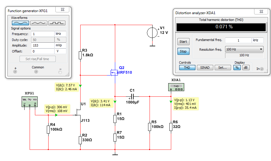

I think I will not simulate at 12 Volt.Hej Lineup, did you mean to simulate with 12 volts, as it says 9V?
But if I do, I will post the result here.
12 Volt simulation and adjust
See the first image.
I suggest changing R3 to 1.8k.
And replace R1 with two 15 Ohms resistors.
The gain of this circuit is around x4.
So the gain is more than the 9 Volt circuit.
The THD is acceptable.

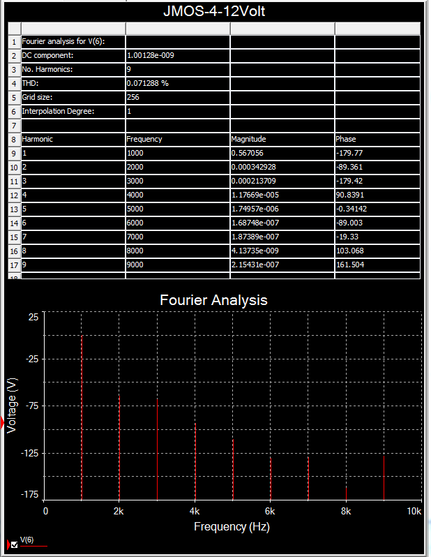

See the second image.
It shows that the distortion is mostly 2nd and 3rd harmonics.
I expected the distortion to go down using 12V supply compared against 9V, but it's still OK. I have a bag of old IRF610 somewhere....
